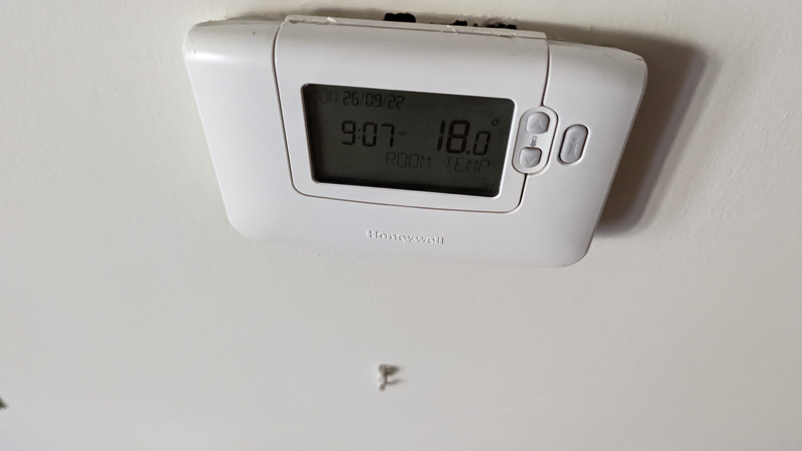

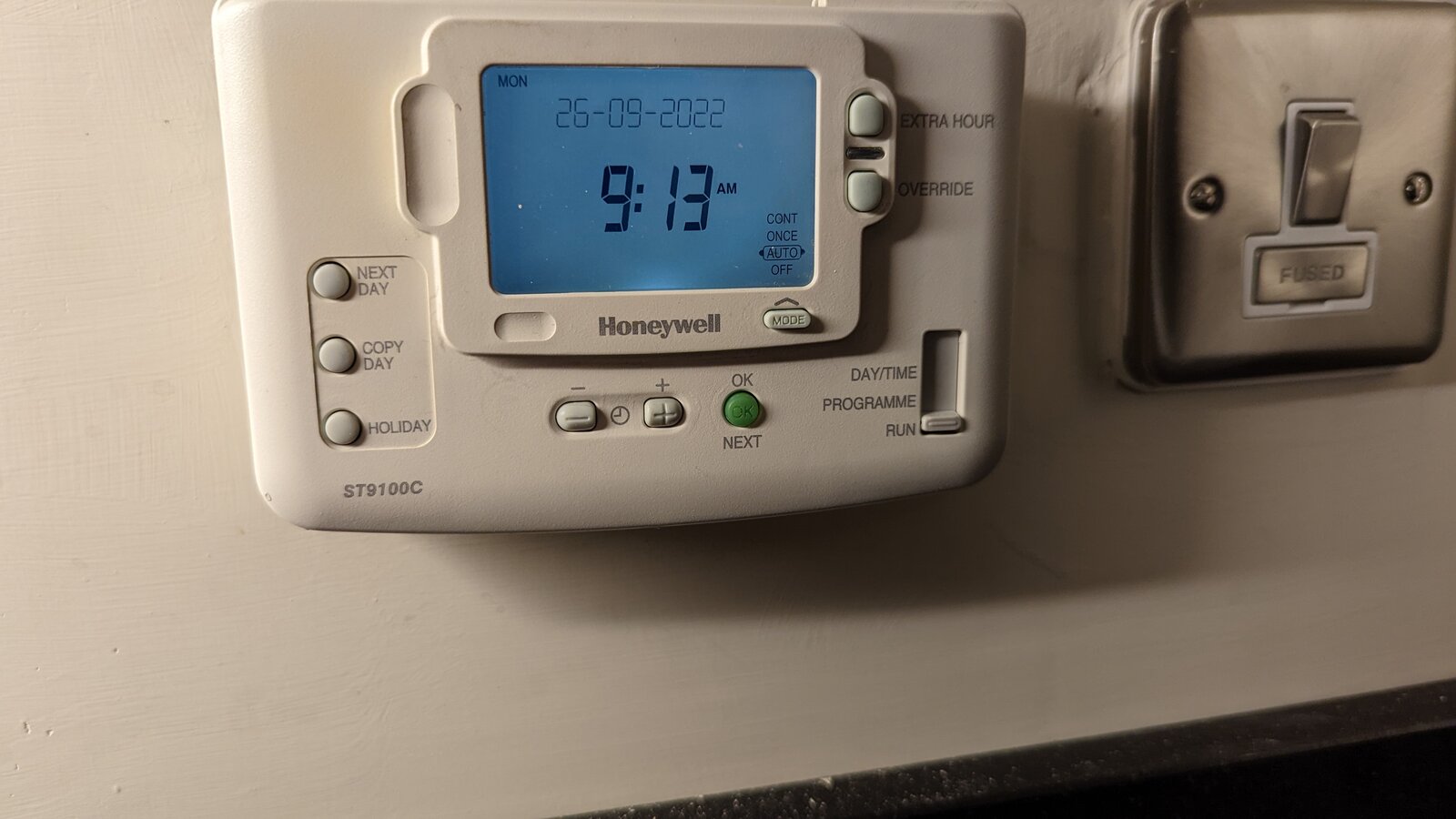

Hot water (In Kitchen)

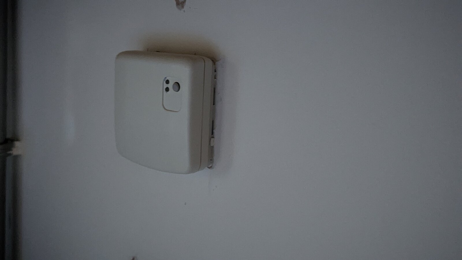

Zone 1 radiators (Hallway)
Zone 2 radiators (airing cupboard - connects wirelessly to a thermostat - that looks similar to the zone 1 thermostat)

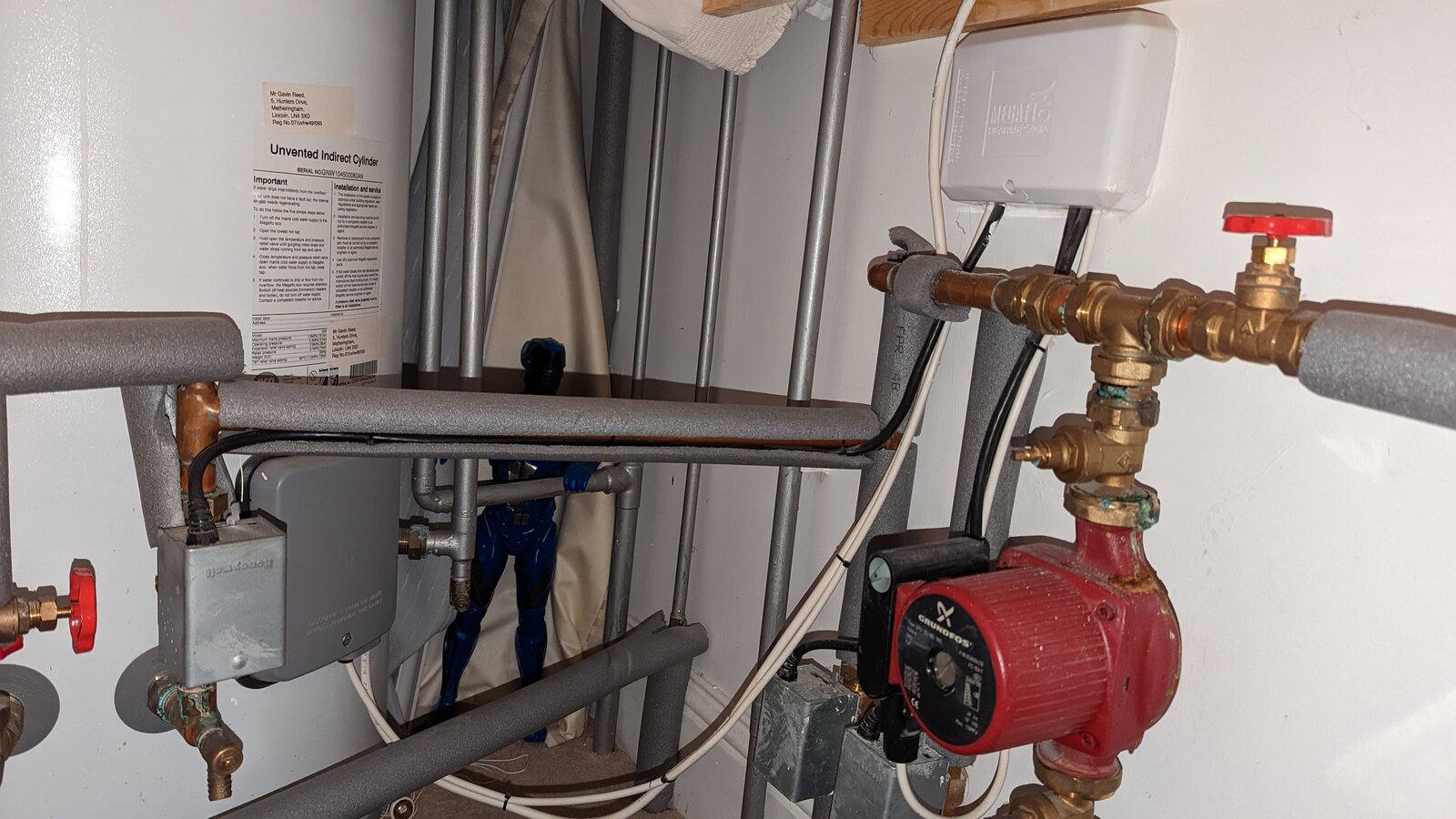

Megaflo (In airing cupboard)

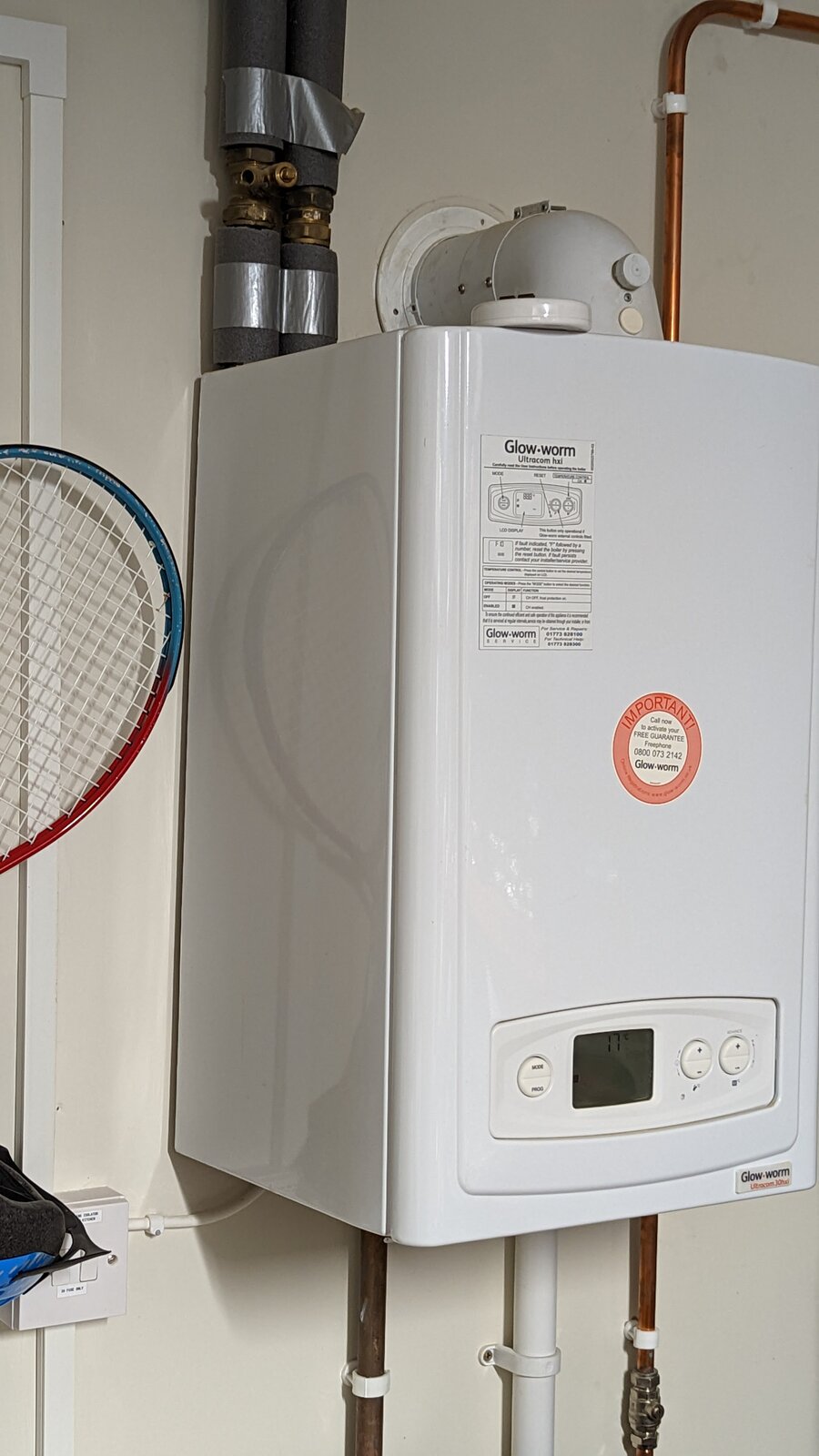

Boiler (In Garage - No wiring present)

The wiser is wireless thermostat’s and a 1/2/3 channel receiver, I’m guessing you bought a 2 channel? Either way the receiver would be wired into the wiring center in the cylinder cupboard. All other wiring will need to be joined or removed at wiring center and replaced with ones for the wiser.
