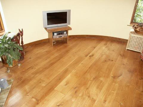

Hired one of the rectangular ones for a job earlier this year, very slow and the paper wears out quickly, ended up doing it with my 6" random orbit. Guy at HSS insisted on calling it a RE-FINISHING sander ie for sanding the surface of a previoously finished floor before recoating.
Here's the floor
Jason

That floor was also new oak, 7",9" & 11" random lengths. There were 700 oak plug heads and some planer marks that had to be removed.
I would not go for the rectangular pad type again but would try the orbital floor polisher type. As you said the drum sander seemed over the top for the anount that needed removing.
Jason
