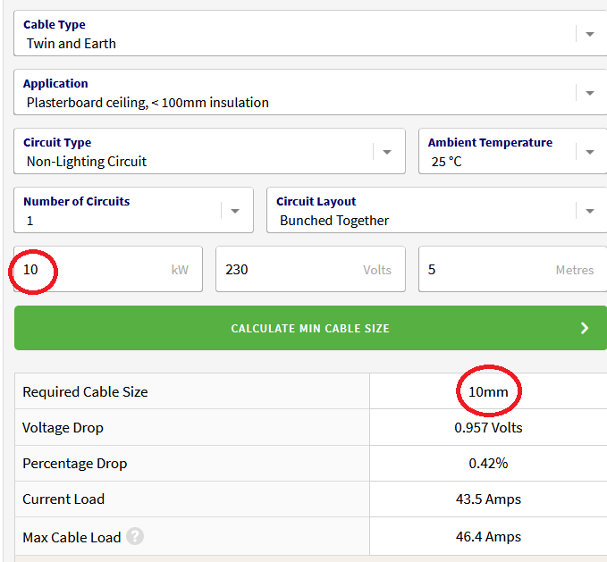

Would be a small house then ( TLC's cable calculator suugset 10 kW is the maximum for a 10mm² cable
with 41.6295 Watts being lost in the cable. ( 0.957 V x 43.5 A ) when 10kW is being drawn
Assume this 10 kW runs for 1 hour a day, ( ignoring other loads during the rest of the day )
14.965 kW hours per year which at 12p per unit is approx £1.60 per year wasted heating the cable.
Take into account the other loads that create wastage in the supply cable and the extra cost of 10mm² over 6mm² could be seen as acceptable in the long term.
10Kw is never going to be used in a domestic kitchen. Imagine how hot it would be is used for an hour! Ever heard of diversity or thermostats.
The last range cooker I installed required a 10mm feed from a 45A CPD. Manufacturer’s specifications:p
