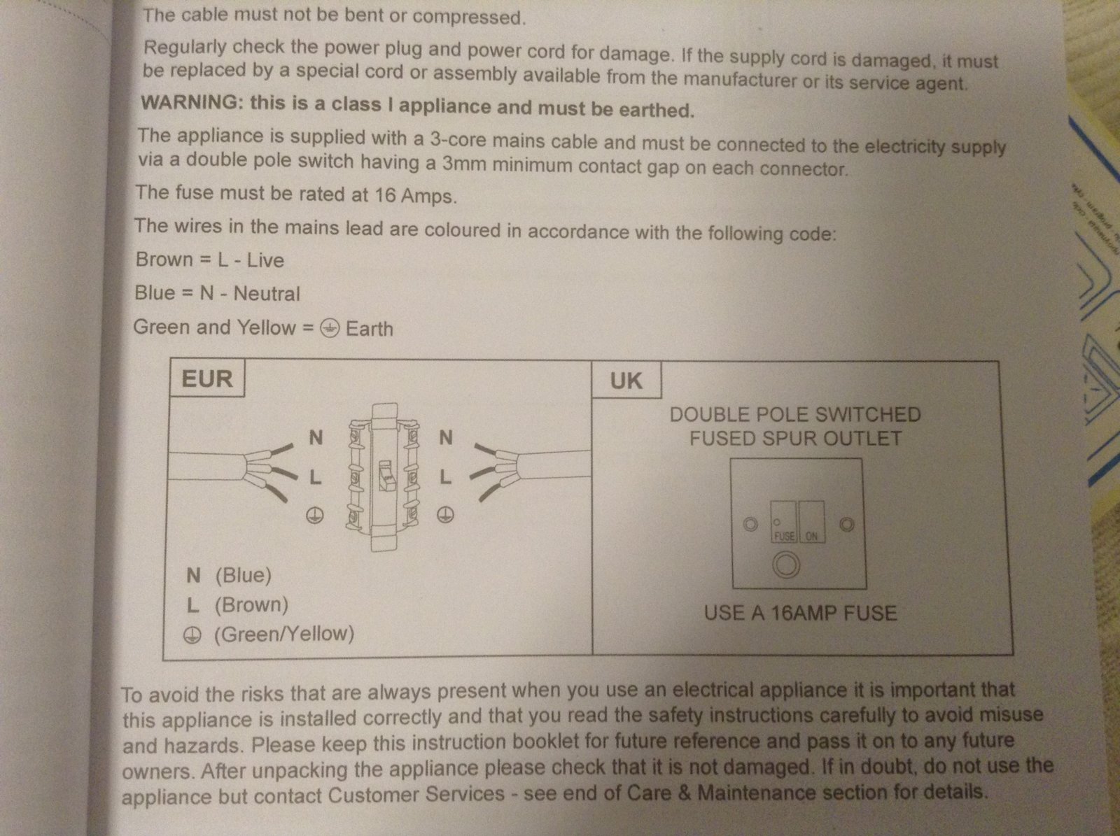

The last range cooker I installed required a 10mm feed from a 45A CPD. Manufacturer’s specifications:p
Another example of manufacturers instructions being wrong.
Here's another:

So i picked my ovens and hob and first fix is done for these.
The advice here has been to install for reasonably foreseeable requirements. It's very common to install a 6mm² cable protected by a 32A curve B MCB - though the installer would need to check that given all the factors that can affect it in any installation, that combination is OK. That allows as much as you are likely to ever want in a normal domestic kitchen.
The hob I picked was a 32 amp 3 KW pluggable induction hob.
That would be "up to 32A" OR "pluggable". Because induction hobs are all driven by electronics, it's easy to limit power drawn from the supply according to programming. So it can be programmed to only use 13A if you plug it in, or up to 32A when hardwired to such a supply, or various levels in between. AIUI, in many countries it's common to have much more limited supplies, so it makes it easy for the manufacturer to make one model for all markets.
The missus might want to up the size from 60cm to 80cm so was wondering would the cable for the original hob work with the new one
The new one is 32 amps, 7.4kw needs hard wiring.
If the supply is from a 32A MCB (using any cable suitable for that) then you'll be OK.
