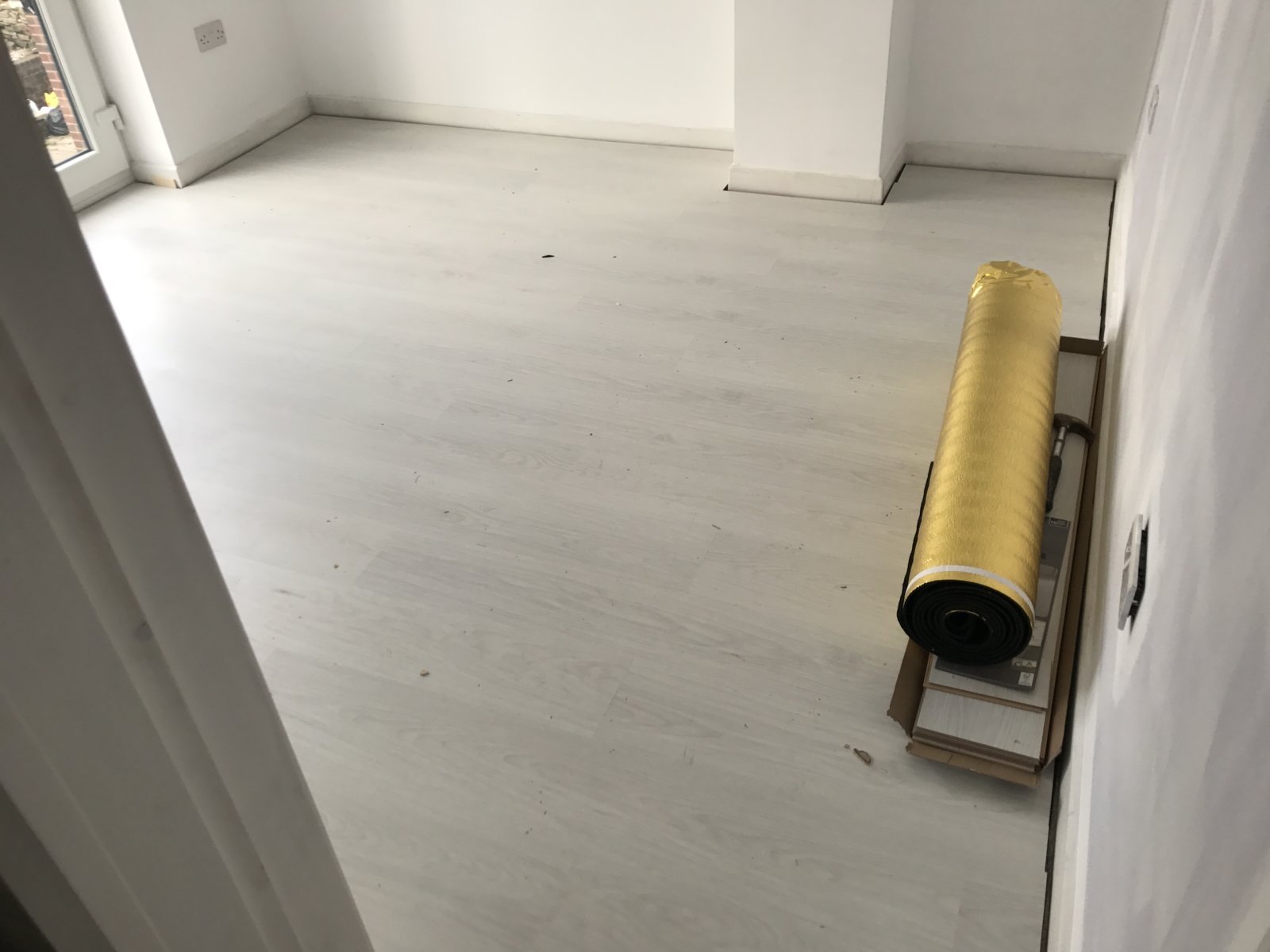

I've got a room that's 3.3 x 3.3.
The Scotia seems to come in 2.4mtr lengths or on a roll. Is the roll stuff any good or is the MDF stuff better? Do you just butt it together to make a joint?
Also how do you pronounce it, 'Scott ya' or 'scosha'.
You can butt it or use a scarf joint for a slightly more premium finish (I suggest 22.5 degrees rather than 45 degrees). It's pronounced scosha. I've never used stuff on a roll.
Looks like you'll need 3x2 for those gaps. Planed.

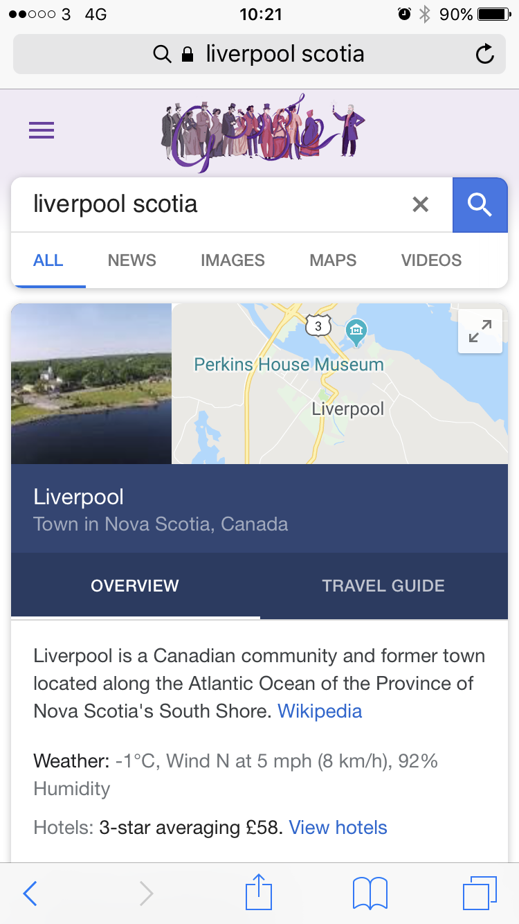

Funny you mention scousers.
I'm in Liverpool today so googled Liverpool Scotia and got this:
Its a bit far for some wood.
Get pine scosha rather than mdf. Never seen it on a roll, but you might just have to pin it more often to make sure if flattens out.
I looked at the roll again, turns out that's only 1.8mtrs long. I thought it would have been 15/20mtrs.
Buy Quickstep scotia mate. Great quality. A lot of cheap Chinese scotia about which is rubbish.
