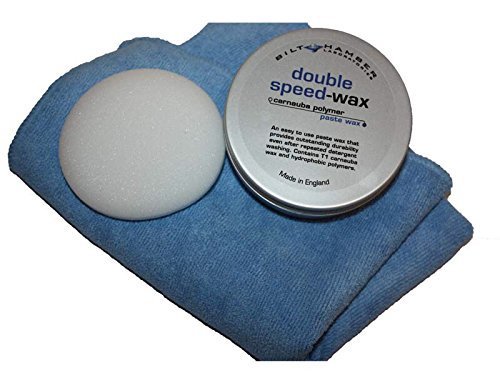

this works for me...i am on my second tin..after 4 years
you wont regret it
and the last one i got on ebay was a good bit cheaper than the amazon one
of course there are better maybe but this makes the water sheet and lasts for months
dont forget to wash the body down with salt free shampoo and dry fully
use some polish to give the shine...i use
wax just protects, polish does the shining
and get top quality micro fibre cloths/towel to dry, apply the polish, polish and then polish up the wax after drying off

So polish then wax?
wash with a salt free shampoo...its advisable
dry fully
polish to get the shine
wax to seal and protect the polished finish....and shed the water
once you wax a car really well...hose it down and watch the water sheet...when you drive off it comes down the rear windscreen like a waterfall...
