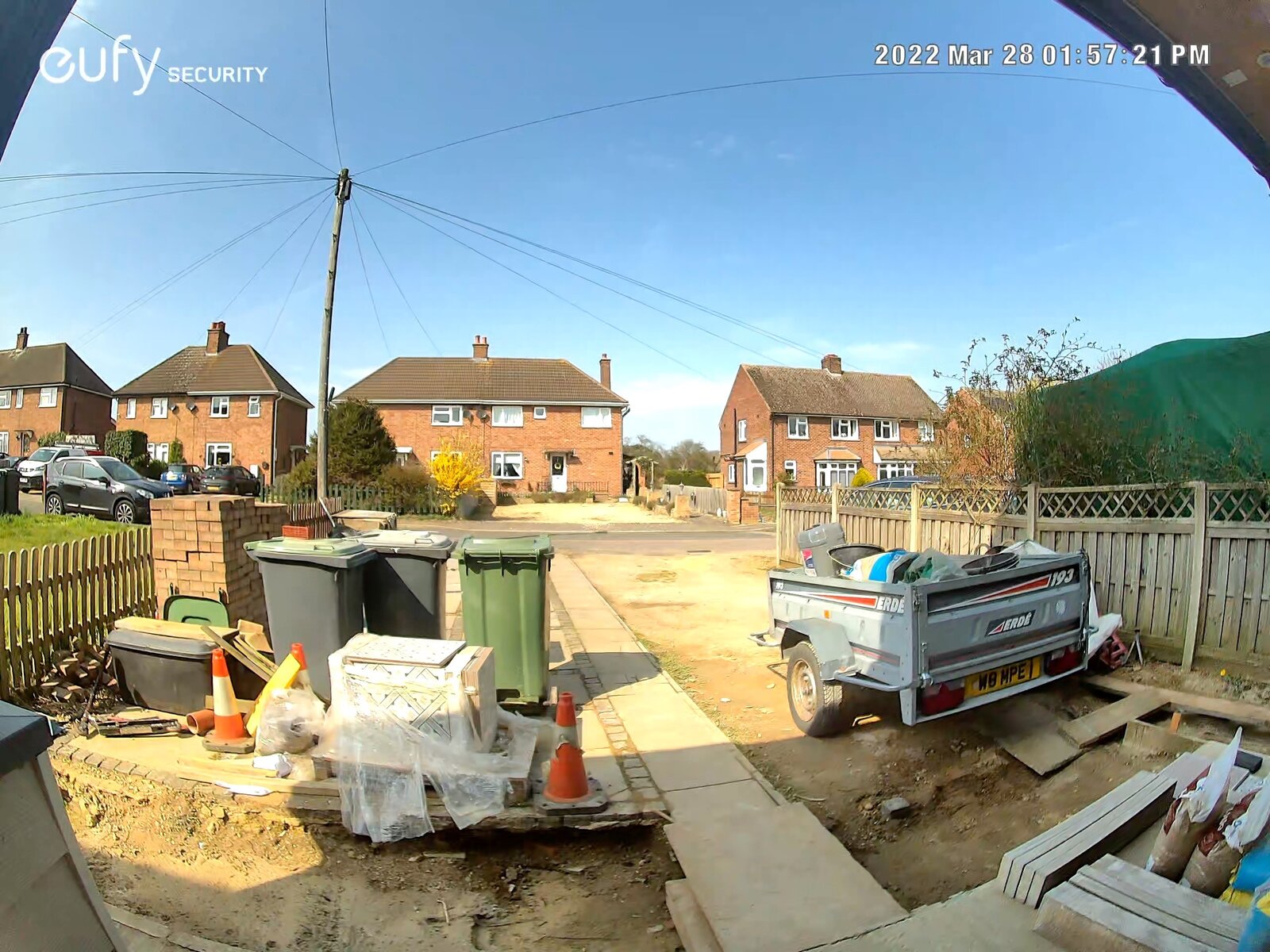

.......and this is my doorbell, it's the older single camera version...
