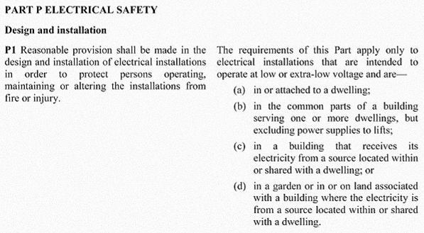

You cannot 'have Part P'; it is a Building Regulation with which everyone must comply.
That's it. There is no more.
As for the self-notification schemes (stupidly called self-certification schemes), they were introduced specifically for ancillary trades like plumbers.
However, in England most of the notifiable work has been removed from the list meaning most ancillary trades no longer need to join.
As said though, one remaining thing is the installation of a new circuit, so a plumber might become registered but it would hardly be worth it.

Not really. You would legally have to notify the work to the Building Control and pay a hefty fee before you start and they may not deem you competent.
It's no different to building an extension.
So I can wire my entire house without any training, verify it and nobody will check, or care that I've no professional training?
No. Just a few things (in England, a lot more in Wales) have to be 'notified' to Building Control - and that essentially comes down to replacing a CU and installing new circuits (which are fundamental parts of "wiring an entire house") and certain things in bathrooms - and (quite apart from charging a few hundred pounds) BC would generally not accept that being done by someone with no training/competence.
