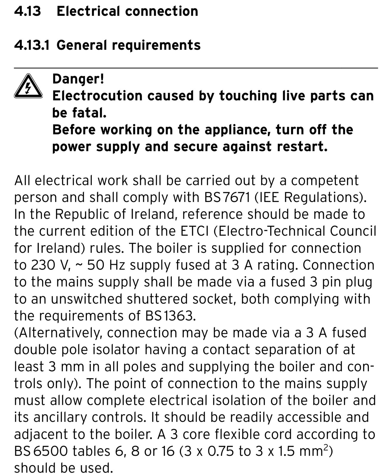

Maybe it’s just what manufacturers ask? This is from Vaillant instructions from 2006, they say 2 options available.

This is my point @ChrisJP I can't see why it is made so hard to transfer the power supply to a generator.

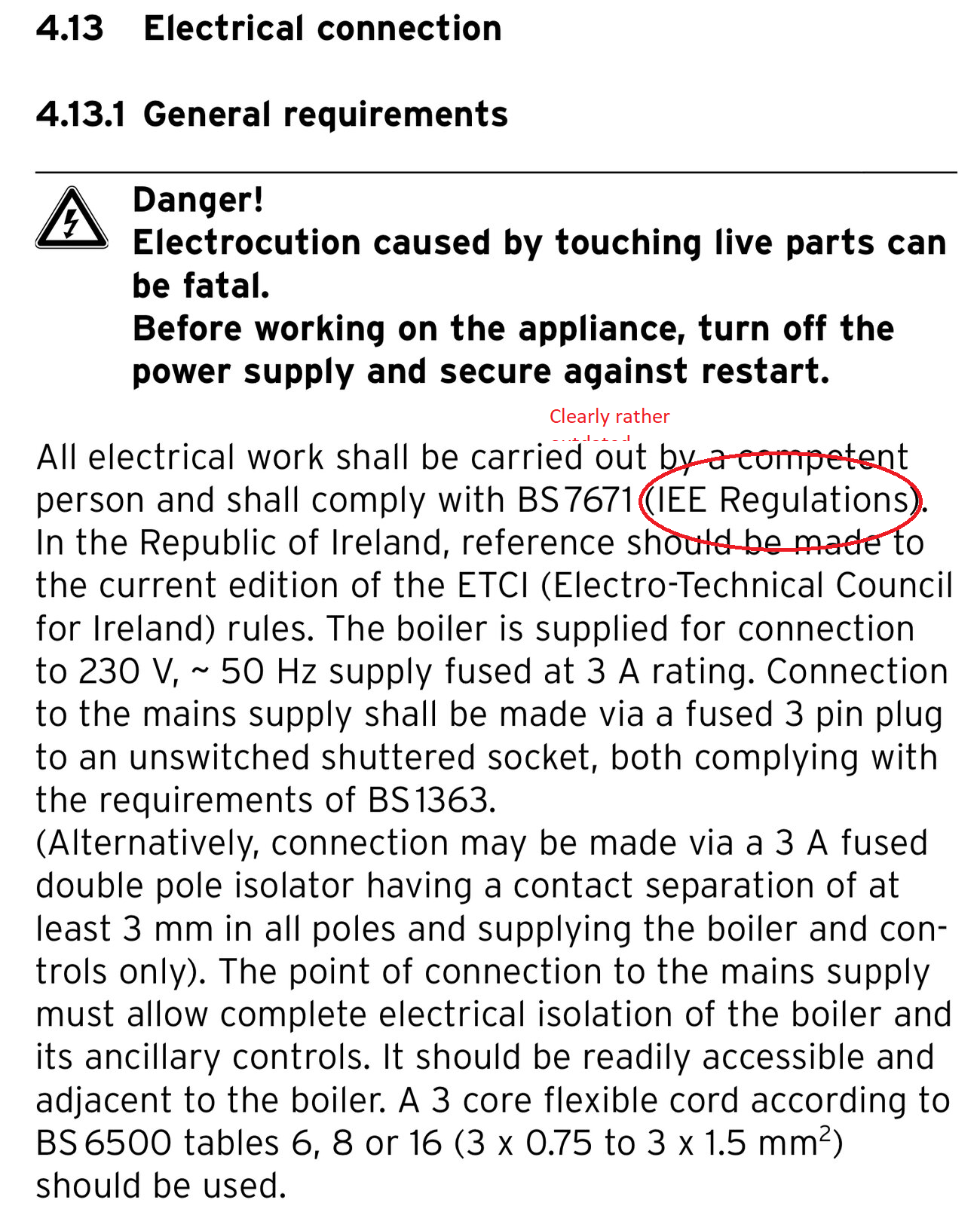

Clearly rather old and outdated 1739724610793.png it has not been the IEE for some years, now IET, so is that still valid, BS7671:2001 when that was printed, we have had BS7671:2008 and BS7671:2018 since then. And it does give the option of plug and socket.
