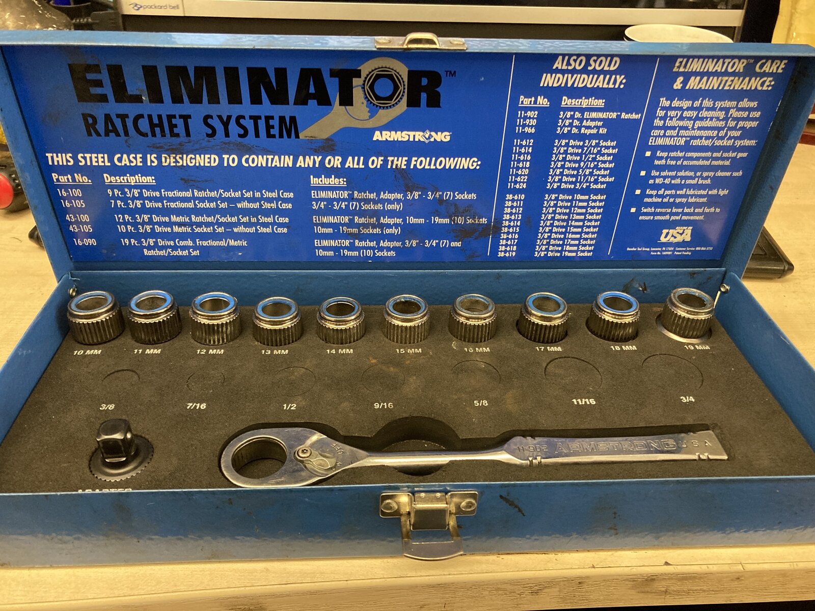

5/8" is 15.875 mm so therefore just a wee bit tighter than 16mm on the bolt head. I absolutely second Burnerman's recommendation to use 6 sided sockets. 30 years ago, I started seeing "flank drive" or "face drive" sockets, which had rounded lobes on each of the 6 faces. The idea was that they would drive against the flats of the bolt head, rather than on the corners. I thought they were brilliant, but I don't see them much these days.
I bought myself a full set, around ten years ago, thinking what a clever idea. They slip onto rusted heads much easier, seem much more tolerant of head wear, as well as driving much better than the 12 sided sockets.
