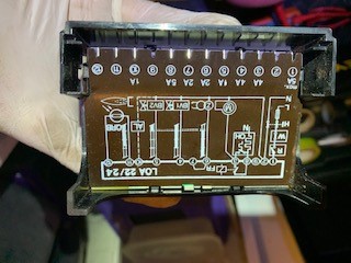

Control box ruthlessly German (it says here): LANDIS & GYR LOA22, if that means anything to you.

It could be worth opening the control box and looking ( and sniffing) for any burnt components inside!

Emboldened by your sensible advice to have a go at the controller, I took it apart. What a little jewel of a device this is! - lots of mechanical levers and electrical contacts, but nothing obviously broken or blown. I was able to manually move and click the various contacts and plastic levers, and bits of copper clicked and sprang back and forth in a reproducible way with the reset mechanism. I sprayed it all with contact cleaner and put it back together.
While I was there, I saw where the photocell wires attached and slung the multimeter across - the numbers flicked from a few ohms to a great many ohms as I covered and uncovered the cell, so that looks ok.

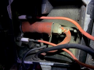

So - not enough pressure to atomise, but why? Is there a problem with the nozzle holder? There are wires to the back of it from the controller (2 common yellow and 2 red) - is there another valve in here that isn't working? The only replacement nozzle holders that I've seen on Google don't have these...

I'm a bit confused as to the wires at the back of the nozzle - I'm not familiar with those and haven't seen them on a Minor 1. Is it possible for you to post a picture?
I have seen a separate valve there but this is purely mechanical and stops a dribble when the burner switches off.

John, see the wires at the back of the nozzle holder, you can just make out the 2 yellow which feed to the control box, also 2 thin red wires in that sheath that you can also see in the box, 1 common with a yellow (terminal 8 ). Photocell goes to 11/12, ie 2 leftmost terminals. (apologies for upside down photo of wiring diagram, but it reads L-R like the wires)
The book says pump is set for 11bar at the factory. I've never touched the adjustment screw but don't know about past servicing (which I guess will have been mostly about getting the air mix right).

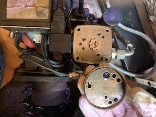

Oilhead,
You really should pull one apart just for fun, it's a very elegant design. The first photo is with the cover off and discs lifted, the second photo is the underside of the lower disc, both with the filter in place. Third all apart.
When I did this a couple of years ago, there was gummy residue between the discs which was causing the pump/fan to stick. I thought it was ready for the bin and had nothing to lose by pulling it apart and finding this mechanical wonder. Only really one moving part - the little ring in the middle set eccentrically from the gear on the shaft. Worked beautifully afterwards.

I should say that I am inclined to agree that the pump is at fault. There's plenty of oil spewing forth when the line to the nozzle holder is disconnected, but I have no pressure gauge to measure directly (although I did do a quick search on BES). Those magic discs do show signs of wear too.
I'm a little worried that it will end up being a Trigger's broom if I start replacing significant bits like the pump. I also have a wait before anyone sensible can help (with a gauge and a sniffer and an oil brain), and then might have another wait for bits. What about that Max1 guys? I could have it in and running factory settings until someone can commission it properly....
Its a shame that it is the wrong time of the year for experimenting with these things!
I'm still unsure about the electrical connections in the nozzle area but looking at the controller diagram it would seem that it is suitable for a 'soft start' technique which may play a part here.
I have to suspect the pump too - 11 bar is one hell of a pressure (100 to 140 psi being more like the norm) and it would have to be in perfect order to deliver this.
Sticking a new burner in would definitely sort things, but it would need commissioning too.......overfiring will destroy any baffles that are in there in pretty quick time.
