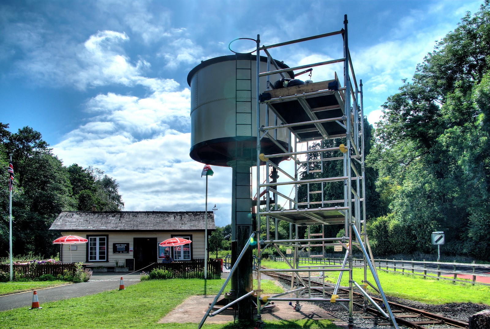

This to my mind is a far bigger problem than if the shower works, my cold water is never anywhere near 20°C and even the water in the water tower after being in the sun all day is not that hot, while painting it,HSA said:Legionella bacteria grow best between temperatures of 20°C – 45°C with optimum growth temperature being 35°C – 40°C. High temperatures (minimum 60°C) kill the bacteria. Legionella bacteria are found in low numbers in natural aquatic environments, for instance, lakes, rivers and ground water.
I was unfortunate enough to get wet with the water while filling a real boiler water tank, one that actually boils water. OK not a big water tower, but seems odd water allowed to get that warm?The shower is the big problem with legionella as the water is atomised so breathed in, the one case I know about at work, was the guy washing down trucks using the hot water designed to make concrete where water temperature is critical for correct curing time. It was because water was atomised so he was breathing in the fine spray.
