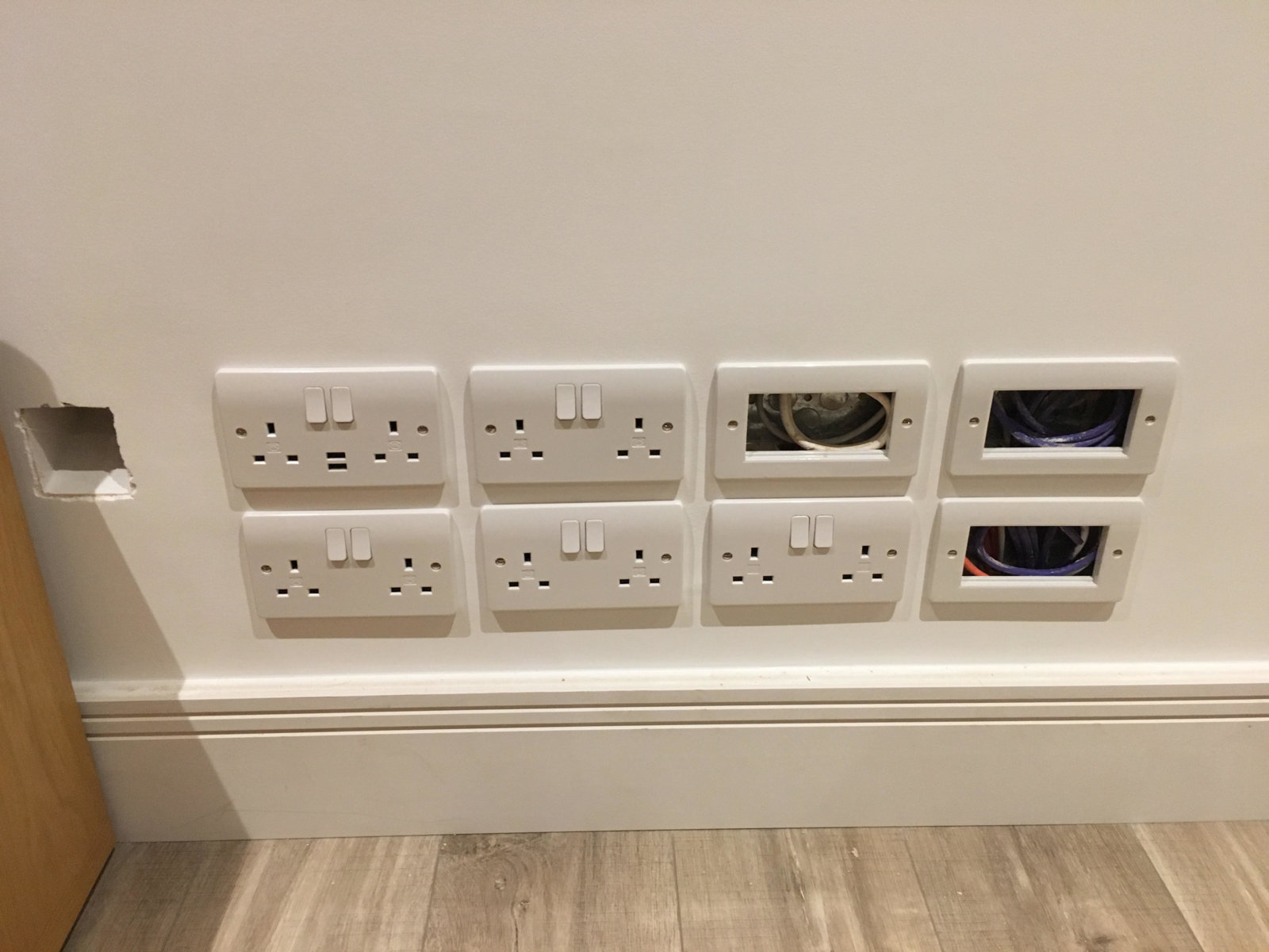

I did this.
The sockets are all separated using 20mm couplers and bushes. The USB socket has been fantastic, as it allowed connection of the Amazon Fire stick and Now TV stick without using up a socket. I only wish I'd installed a second one now.
To the left is a 65mm square drainpipe I buried in the wall, which comes out behind the Tv above (I have 225mm solid walls so it's fine)
The 3 other boxes have since had data ports fitted, some back to a patch panel and some direct to another room for HDMI connectivity.
