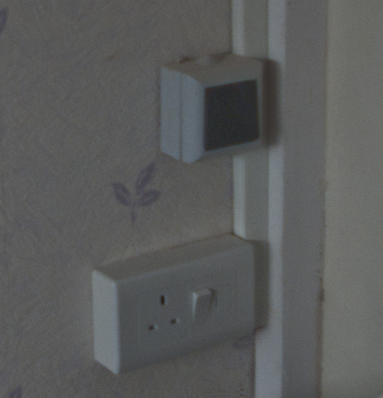

So is fitting a FCU a new circuit? Well if the wires already existed no, so if you extend a spur, then realise it does not comply, so add a fuse like this IMGP7387.jpg you have created a circuit but it is not new, it was part of a larger circuit in the past, and using the same fuse to supply a boiler would be no different to a plug, so it depends where the FCU is used as to if part of a circuit or not. The picture shows a grid plate with a 13 amp socket, switch, and 13 amp fuse holder doing same job as a FCU, but likely would not be called a FCU. It was used to reconnect some sockets in error made dead during a rewire. So parts of the circuit were from last century so not new.
