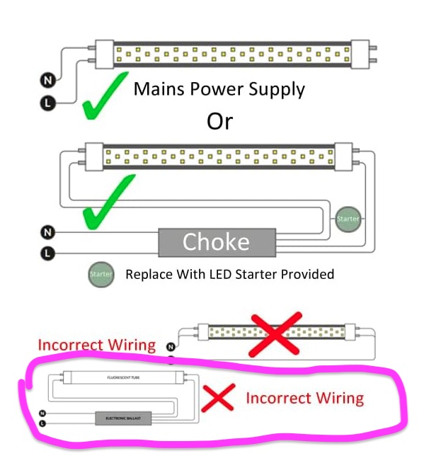

In your opinion, do you think that my existing light is wired like the circuit below in pink? (This is a screenshot from the Amazon product page.)
Neither, I think, you have an electronic ballast and the LED tube is designed to be used with a magnetic ballast.

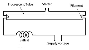

The fluorescent is wired like this

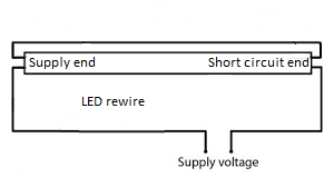

with a wire wound ballast, we need to convert to this

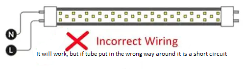

for it to work with most LED tube replacements, the fuse can replace the starter, but unless both ends wired in series, putting the tube in the wrong way around is a short circuit, wired as shown it does not matter which way around the LED tube is put in.

I suspect you need to disconnect all the wires. (Better make a note or mark on which colours went where.)
Then connect the orange wires directly up to the supply cable. And supply cable only to that.
It will then look like the top diagram.
Earth to metal work

You need to bypass that ballast. The instructions will tell you how, but if you are unsure post a copy of them here and somebody will try to talk you through it.
