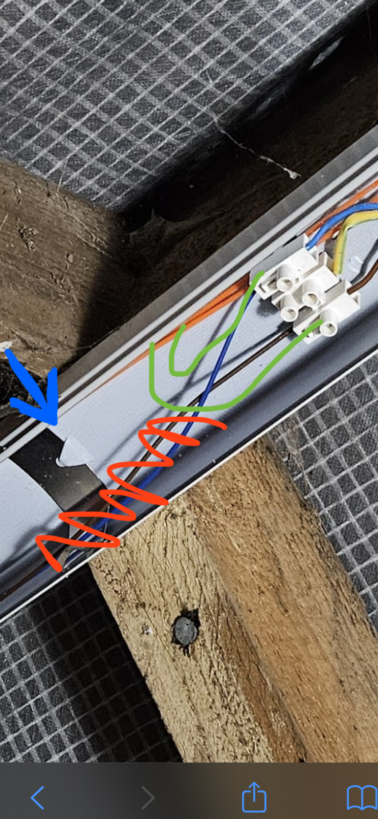

Why is my LED replacement for a flurescent tube not working?

See the orange wires?
Cut them where the blue arrow is
Strip about 1cm of the orange sheathing off each end
Twist the copper strands and fold them over into a tight U shape
Remove the red scribbled wires entirely from the screw terminals
Link one orange wire onto the L and one onto the N, it doesn't matter which, per the green lines
Make sure you examine the LED tube and do not connect the "short circuit end" to the orange end
If you'd rather wire it up so the tube can go in any way round, post back. Additional materials will be required

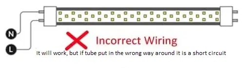

The old problem is when wired like this
yes some kits do have a sticker to put on the fitting to show which way around to fit it, but wired like this

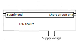

it does not matter, the

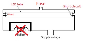

starter can be replaced with a fuse, and can't see why wire wound ballast needs removing, but shorting it out will mean less heat so it will use fewer watts per lumen as a whole if ballast shorted or removed.
