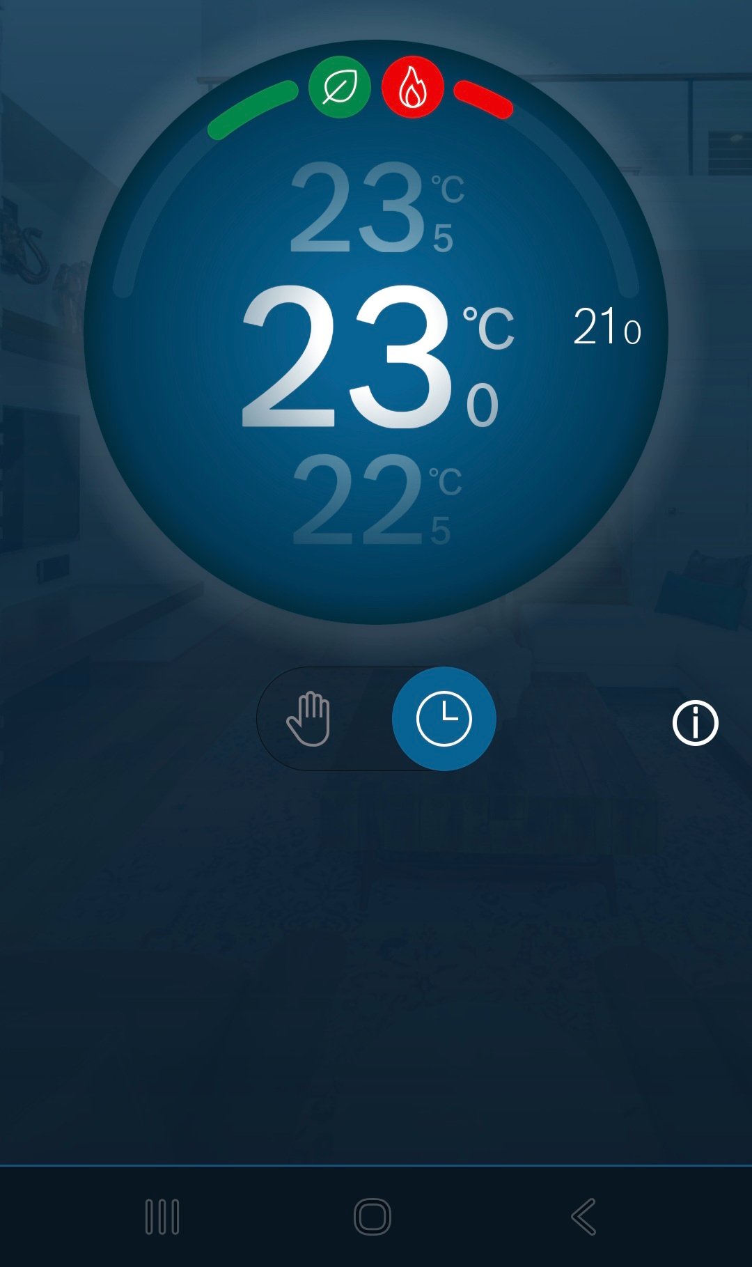

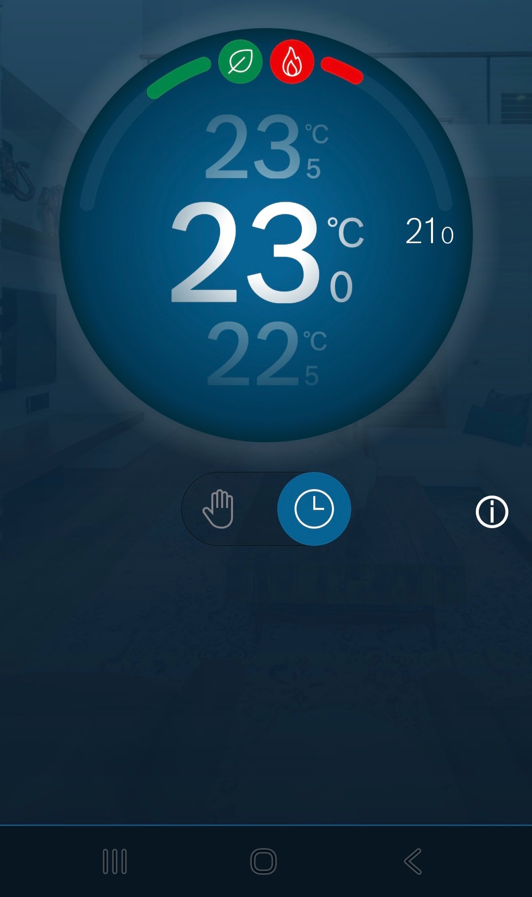

Why would my worchester bosch be firing up when it has been sitting 2 degrees above set temp? Its been firing every 10 or 20 mins for around 20 seconds then off again but in this photo it has been on a good 20 mins on now. I have the easycontrol ct 200 thermostat.

I’m wondering if a link has been left in at the boiler? If not maybe contact your installer?
What do you mean a link left in?
Most Boilers come with a factory fitted link so the heating can be used without a control (eg a thermostat), sometimes these aren’t removed by installers, so the boiler constantly tried to fire when not being requested for by a control.
Something i can check myself as long as i dont touch it?
Yes, I don’t see why not.

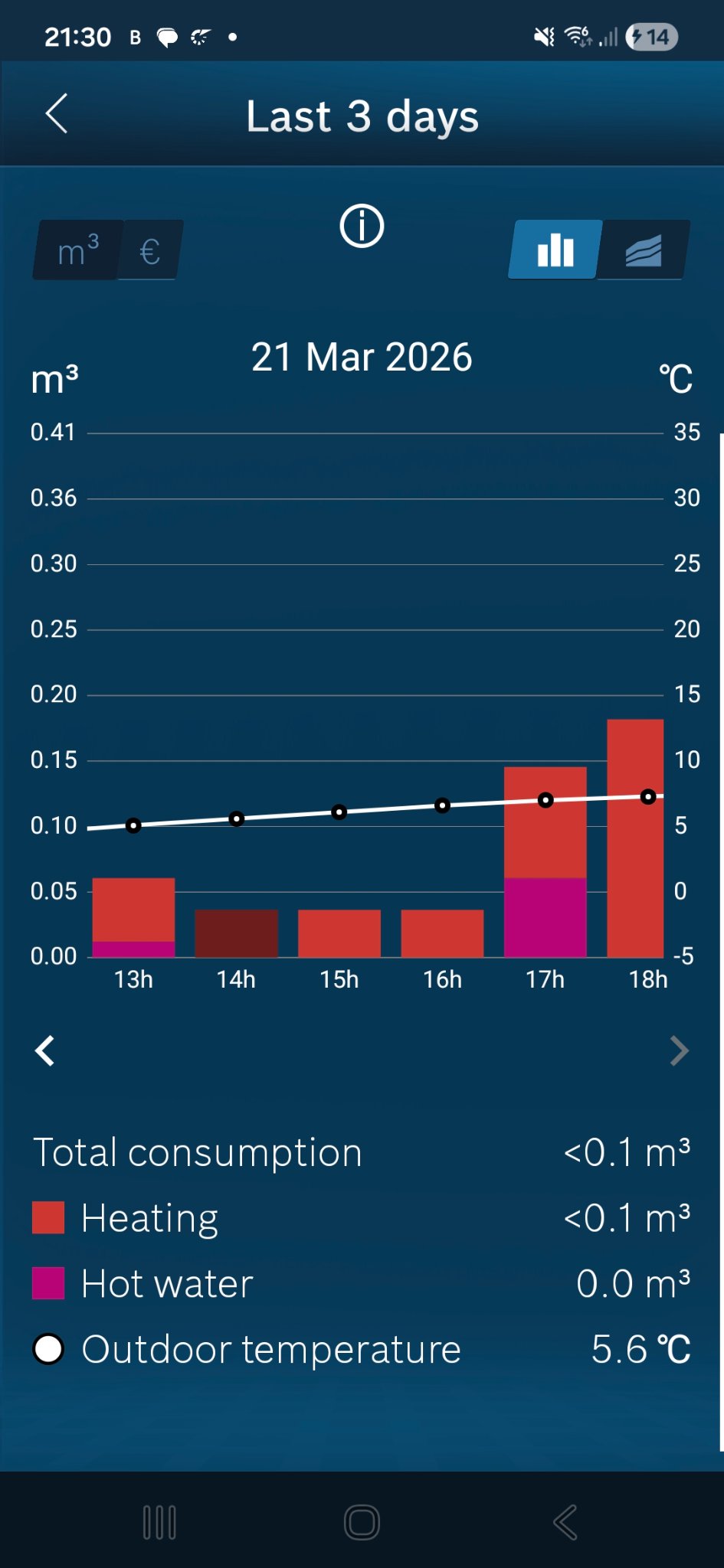

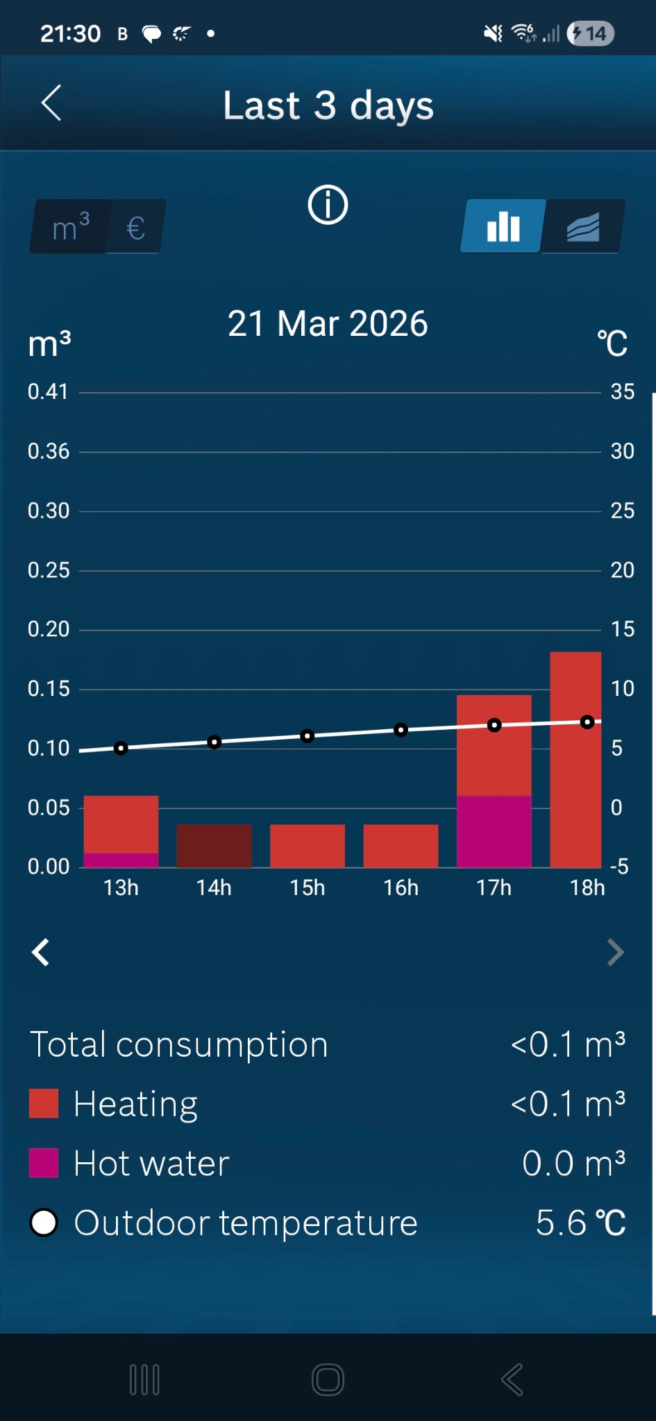

Juat as you mention that i had just noticed something. The outdoor temp you can see in this photo is wrong. It was around 15 degrees outside at thst time
Could be a faulty sensor then, or poorly positioned.
the outside temp showing on the control was fine all day but on the graph it does not look right at all
The outdoor sensor should be mounted in a position which is in constant shade, well away from any heat sources. If that's correct, then all that is left is an error in calibration, I seem to remember my sensor has an adjustment for the calibration somewhere in the settings.
