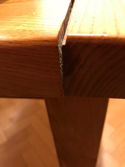

Hi
Please see pics, why is this happening? is it repairable, if yes how?
The sides are tilting downward. I haven't used the table since January, various plates, pans and dry food/can were on the table, just kitchen staff nothing heavy.
complete guess as nothing seems obvious

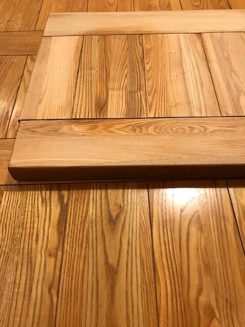

Is it worth taking it to pieces to rebuild? I took the screws of the small blocks but the blocks didn't budge, glued or something like t&g fixing?
i would try by putting the leaves on and getting someone to lean and see iff it lifts the cross beams underneath if so you need a way to prevent the beam moving and transferring the load to the top assuming my thought are correct as they may off course be miles out lol

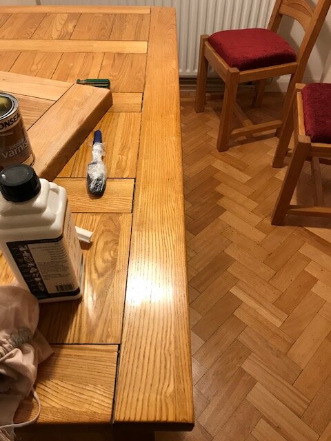

All screws are tight. The 2 screws in the blocks go into the cross beams, there are 5 beams.
Is it best to unscrew them when putting sand bags to allow relaxation of timber?
Sandbags will be placed on top of the table directly above beams?
is there a gap between the top off the cross beam and table top ?
you only need to touch the beams that the extension leaf legs touch/reach if the legs dont reach you wont get the weight levering onto that beam only the ones the legs touch

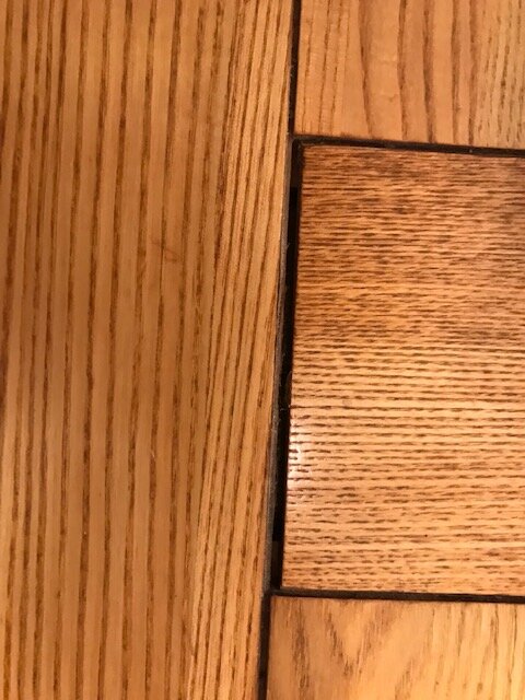

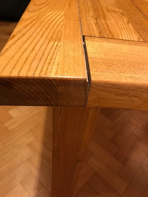

I have put new pics, both sides of the table have same exact issue. The leaf was only at one end, there are gaps between beam and table top but only to fit a business card and only for up to 10cm per beam and not along the whole beam. So wondering if it's something else wrong?
the only other choice is the edge is drooping but theres not enough overhang to make that happen easily ???
so the only gap is 1mm on top??
any gap between the side block and the cross beam or indeed a shadow under the area off the block to suggest its moved up
