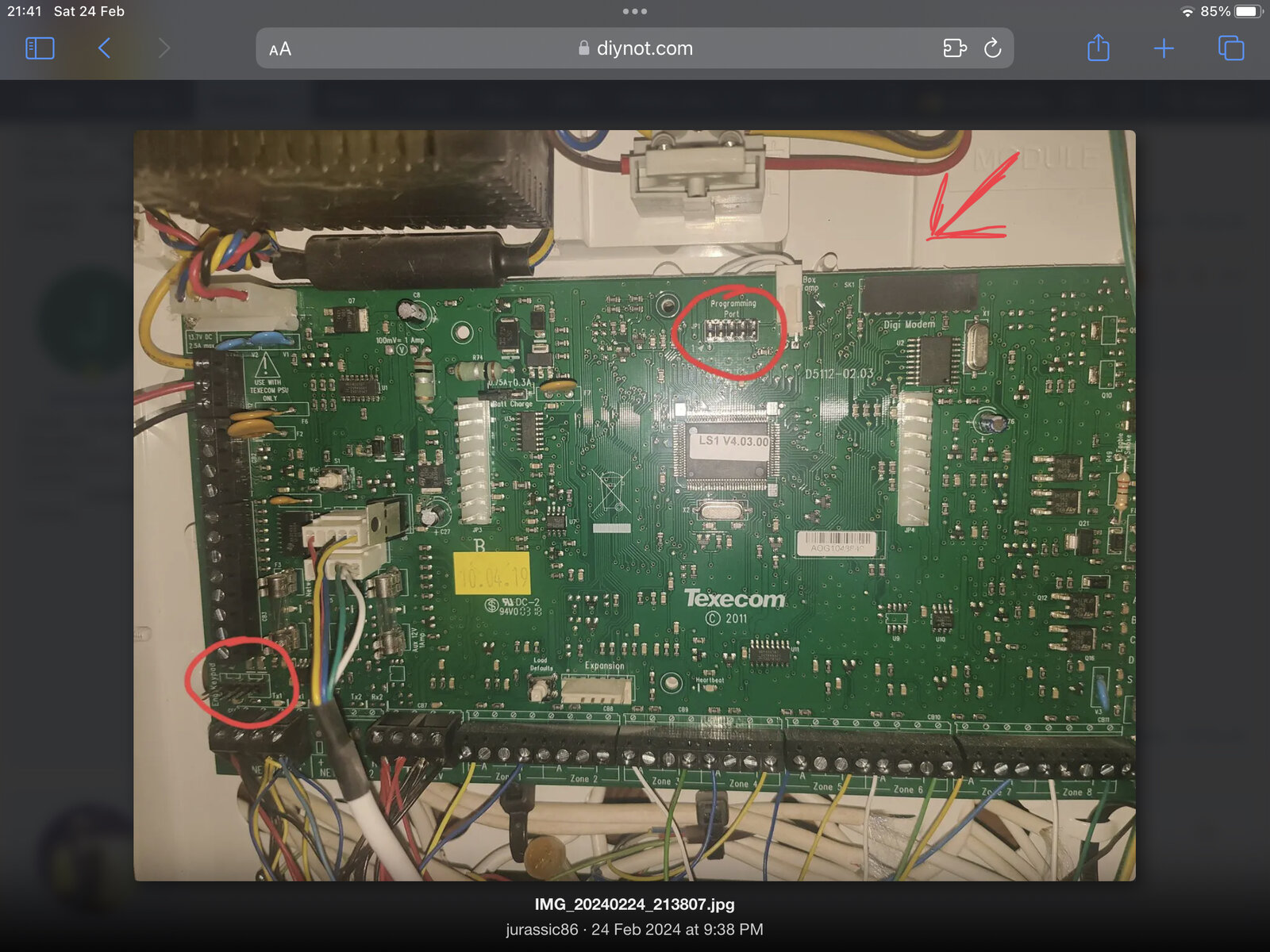

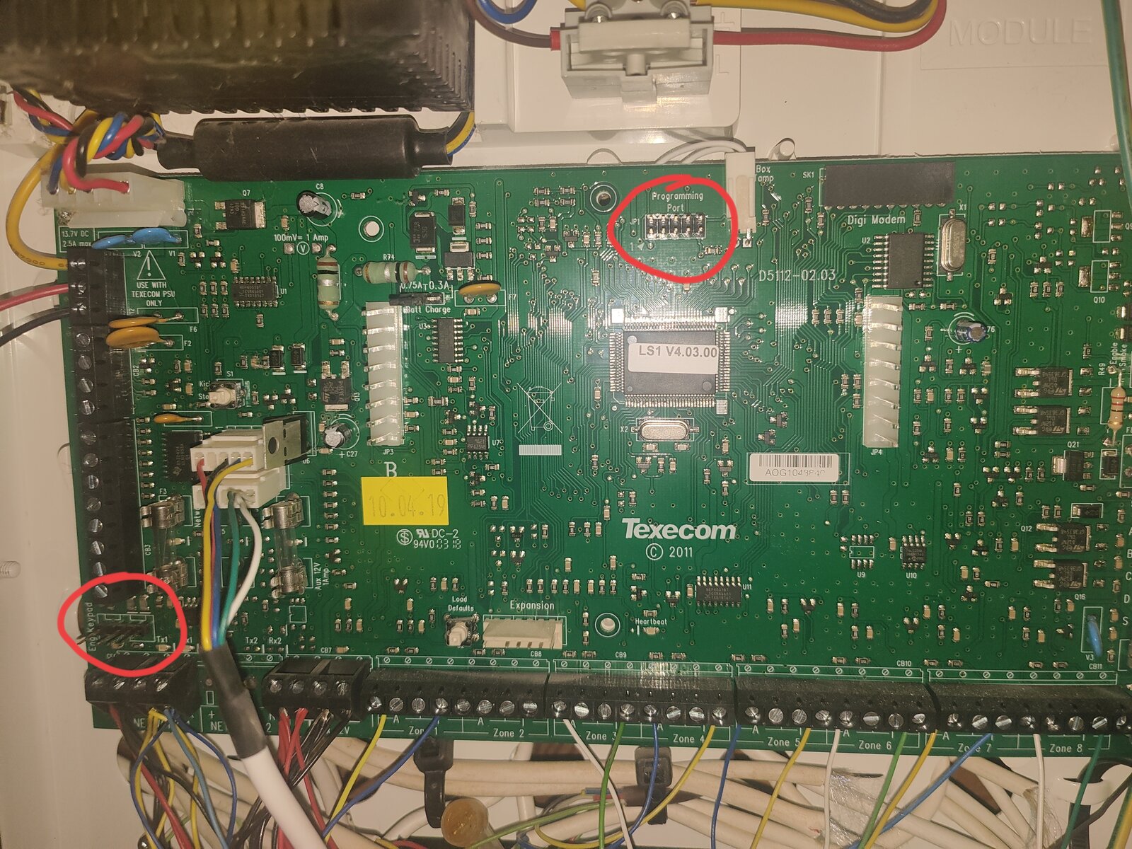

You can’t just unplug the com port and plug something else on ! ….post picture of your panel pcb …
Thank you, attached is the two ports I tried.
Top one with the PCB adaptor and switch on PROG and the other with the cable directly.

Comport + plugs onto digi modem giving you an extra com port

So I need to solder this on to my panel? Is there no way to use it without soldering it on?
Or can I unplug the smart comm and use com2 then replug back in after I'm done?
Think I've solved it. I unplugged the COM1/2 and connected the Wintex cable to the Com2 and boom she connected.
