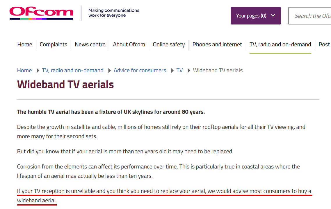

'Broadcasters recommendations' is an interesting term. In this case the body would be OFcom. There may be something tucked away in some less-visited corner of the web site, but all my searching revealed was a rather limp recommendation to get a wideband aerial where there are reception problems.
