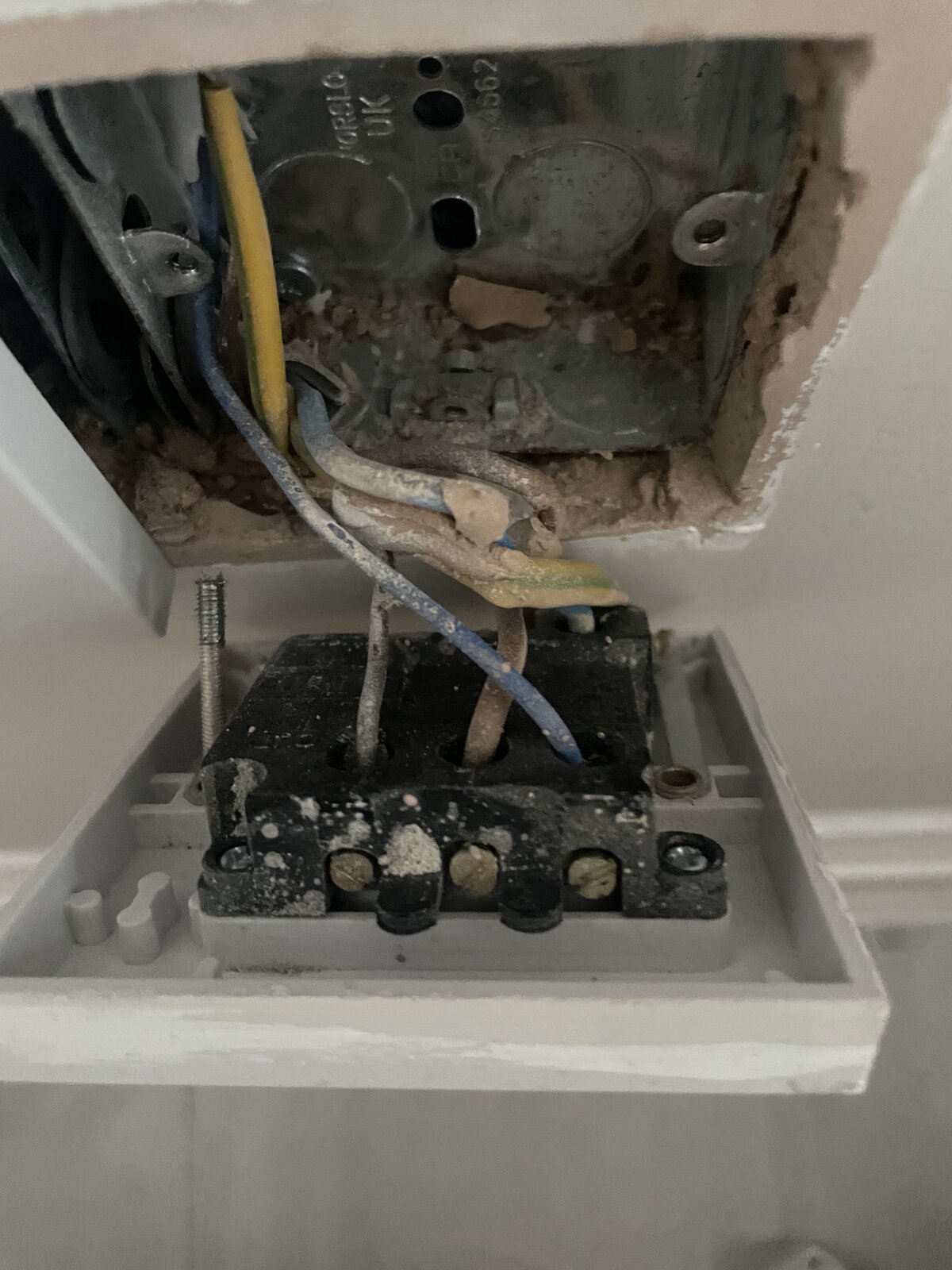

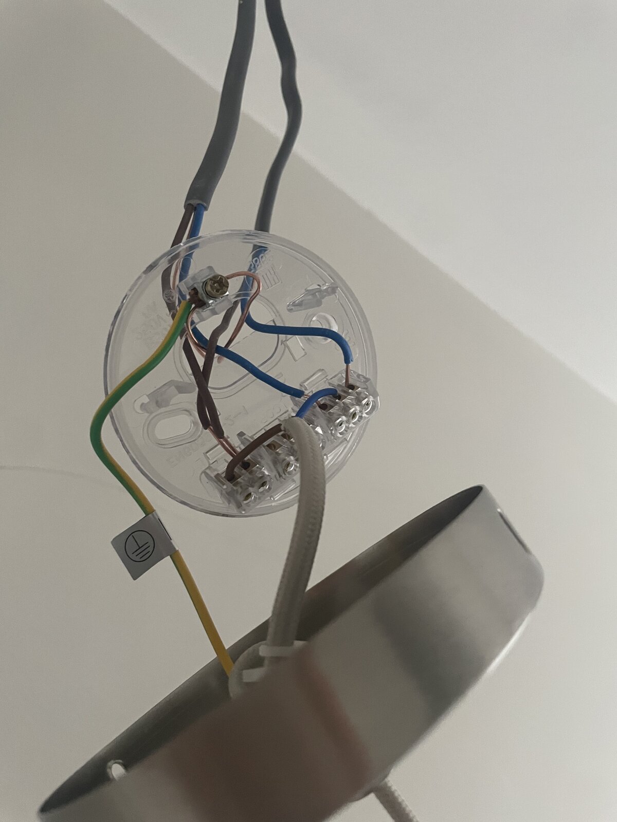

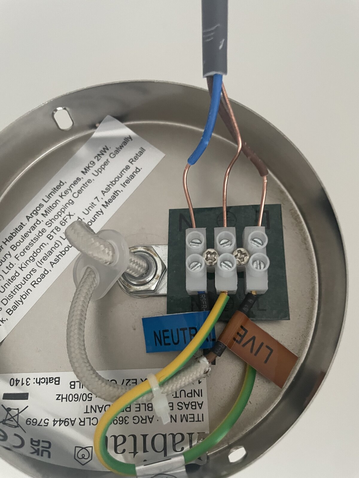

Hello, I had some wiring installed by an electrician some time ago so that I could eventually hang pendant lights. I’ve just got round to doing it and I can’t seem to get it to work.
It’s two separate lights running from the same switch.
I have attached photos of both lights and how I’ve wired them up
Any ideas what I’m doing wrong please?

do you have a multimeter ?
and know how to use ?
the insulation should go upto the connector and not be showing - high risk of electrocution , shorting , fire as shown
either the brown or blue (no idea which is live , depends on wiring ) may touch the metal if moving around - highly dangerous
the bare copper cables should be sleeved green/yellow
anyway
has this ever worked - how was it left with the electrician - on a separate MCB on consumer unit - how was it left safe after he/she completed the job ??? or how isolated ???
photo perhaps of the connections in the switch , in case they have the junction for neutral inside the switch box- otherwise would be a junction box somewhere else
please tell us that that is just temporary and you wont leave that amount of exposed copper from each terminal!! in the ceiling rose is one cable to/from a switch?

Yes I will trim accordingly to ensure insulation is covered, I just did it like this to give myself some leeway as I knew I would need to try a few different ways of wiring as wasn’t sure which way was correct.

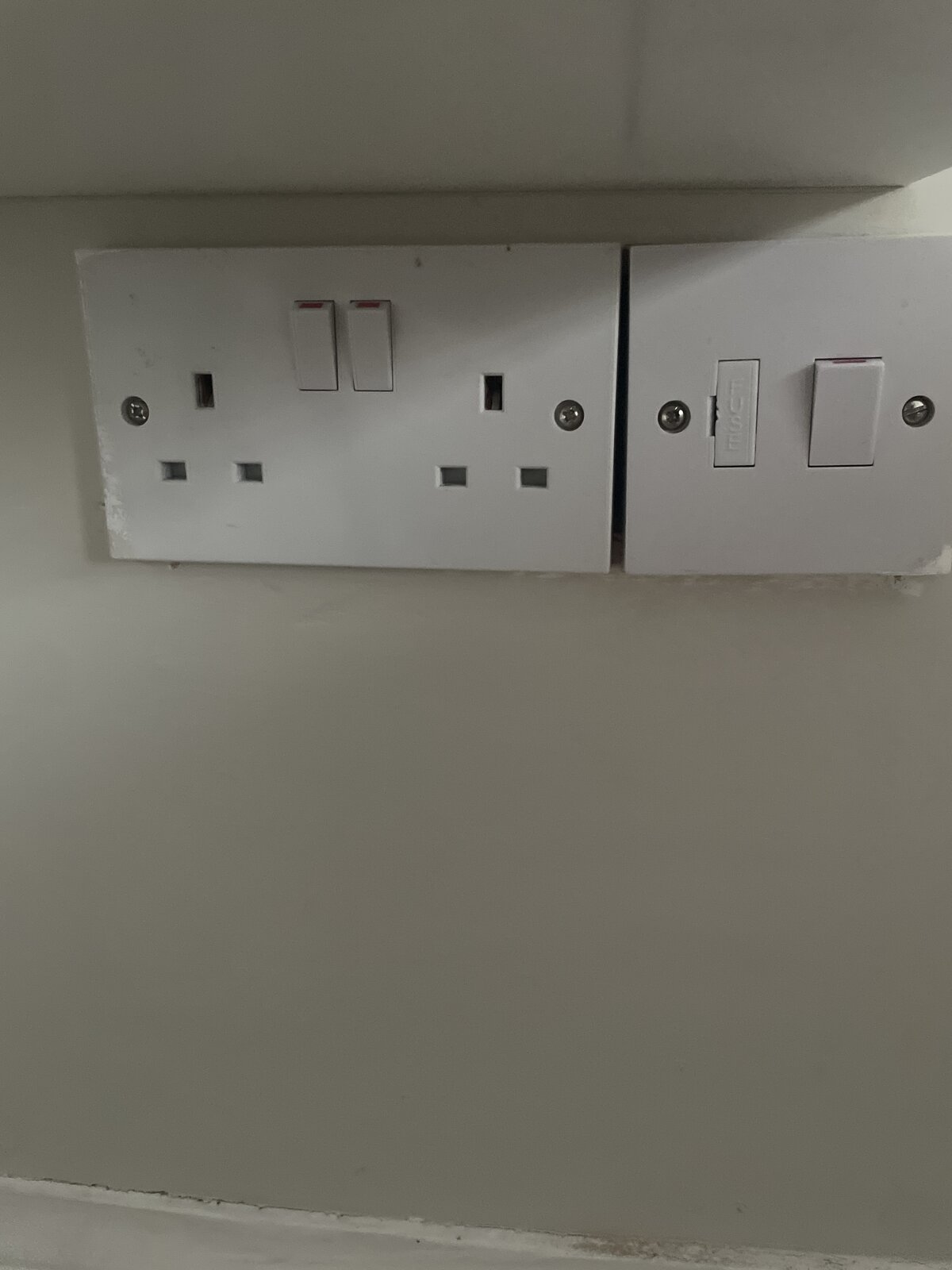

I have attached a photo of the switch as requested

yep, multimeter probably needed now
the spur does look like its connections are like this
i'm assuming its fed L/N from that double socket - which is working OK - correct
and so Live/Neutral
goes into the supply side of the spur
then out as live neutral LOAD to the lights
and thats the only switch for the lights
as you say - Fuse maybe faulty - Switch maybe faulty - connection from spur to the double socket maybe faulty - no power on the double socket - some other connection between the spur Load and first LIGHT rose with the 2 T/E cables
so the 1st cable with 2 T/E cables would get the L/N and light and then that feeds the 2nd light - with one cable
