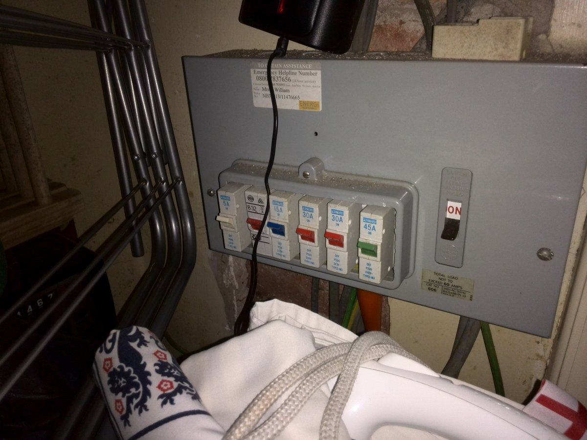

I am hoping to commission an electrician to install an extractor fan (operated by humidistat sensor only, I don't want it to come on with the lights) and a mirror with lights in our bathroom.
As we are going to change from the existing electric shower to a shower run off a combi boiler I will be asking them to decommission the electric shower as well.
The existing electric shower was installed by an electrician about 15 tears ago.
It has its own 45 amp fuse in the consumer unit and a very thick grey cable runs from the consumer unit to an isolation switch outside the bathroom door then under the floor to the shower.
Will they be able to use that cable/isolation switch for wiring either the extractor fan or mirror with lights or both.
If yes then I could crack on with replacing floor boards over the bank holiday (hurray!), I would like not to have to remove them again if the existing cable has to go and new ones put in.
Thanks in advance for any help.
Normally those items would be connected to the lighting circuit. Is that difficult in your case?
In principle the shower circuit could be repurposed, if necessary, but that would be less conventional.
Thanks for your response endecotp. It would be difficult to use the light circuit as the loft space above is extremely tight and although I have stripped the wall back to brick I have, so far, managed to keep the ceiling intact and would like to keep it that way. I'm fairly handy with pipework, carpentry etc but know very little about electricity and have a couple of days off work so would like to get some other things done. I did get a number for a spark from a friend but can't contact him until Tuesday. Do you think it would be expensive to repurpose the shower circuit?
One way is to get a small two way consumer unit with a 63amp RCD, install that outside the bathroom door, and run the fan and mirror from that instead, Fit a B6 breaker for both the fan and mirrors.

Why would he do that rather than just replace the current shower MCB with a 6A one?

Martii, the new electrical items in the bathroom should be RCD protected. Does the old shower circuit have RCD protection? If so, endecotp's suggestion to replace the 45A MCB with a 6amp one is fine. If not, you could use a 6amp RCBO.

TTC, with regards to an existing RCD I really couldn't say. The only type of RCD I'm familiar with is a plug in one for when I'm using power tools. Would that be located locally to the bathroom or be a part of the consumer unit? Would the spark who installed the shower not have included that as part of the job?

You don't seem to have any RCD protection. This will need to be resolved, irrespective of how the wiring is done.
The most obvious solution will be to replace the entire consumer unit. Someone else might know more about that particular box and if/how it can be upgraded.
