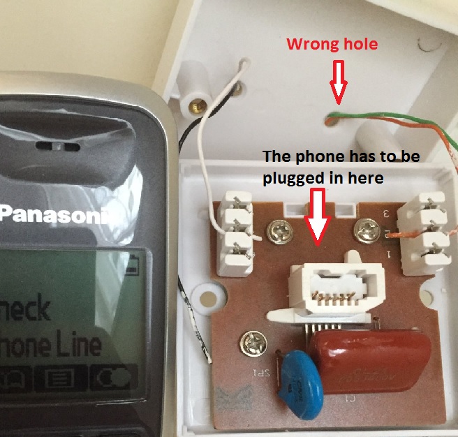

Wiring a BT Socket
Into which socket are you plugging the phone base station lead ?
If the phone doesn't work when plugged in this socket then -
the IDC connectors are not making contact with the wire,
The line has been parked by the exchange ( can happen if a routine line check does not find a master socket at the end of the line )
There was no telephone service .
Yeah, I did plug the phone line in, and I did punch out a new hole from the tabs now.
The 2 wires are connected but still no dial tone.
JH
ok, I used a voltmeter and there is no current between the terminals.
What does that mean and what should I do?
JH
If there is no significant voltage - next answer AndyPRK's question - 'So how long ago was this working?'
Using the probes, touch the bare metal end of the wires and see if you get a voltage now.
Need to be on 200V range I think and expecting 49V ?
I didn't connect the phone line into the socket when testing.
I used all the dial points on my voltmeter including AC/DC and Ohms. No current at all.
I touched the metal points on 2 and 5.
Last time it was working (when plasterers were here, was 5 months ago roughly).
