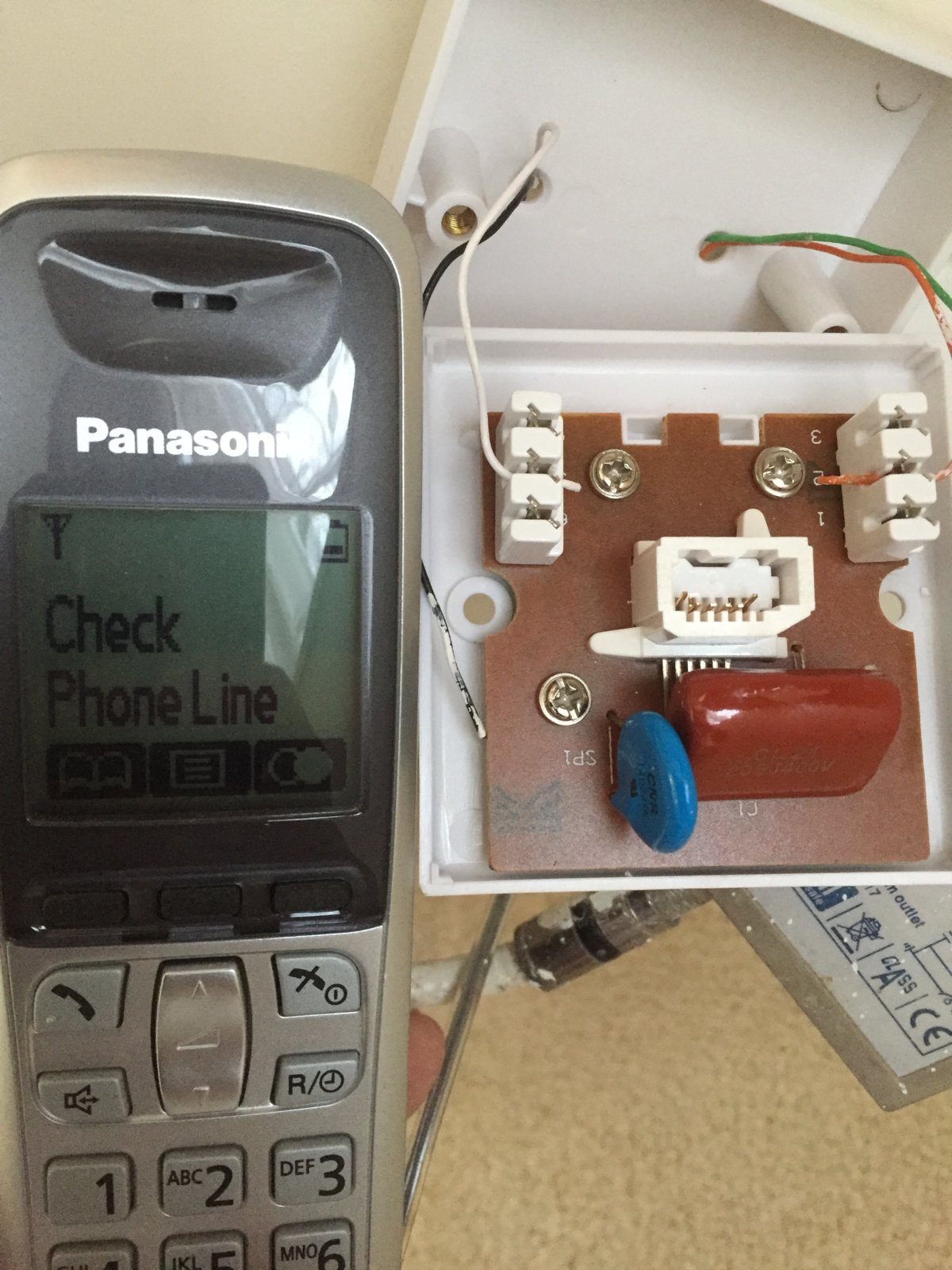

Ok, I have hooked up the Orange to No.2 and White to No.5 but the dial tone is not there.
See image below.
JH
Excuse me if I'm stating something you've already checked, but have you checked the metal push-fit connectors are touching the wire -- have they broken the insulation and touched the wire inside?
The master socket was very low down on a wall in my house and I wanted to move it. Unfortunately I had about 2 inches of original cable to play with, so I sourced some more wire and extended it with jelly connectors. For several hours I had no dial tone before realising the jelly connectors hadn't pierced the wire. I manually stripped them and used two new ones.
Ok, good suggestion. I can't really see if its pierced or not. I'll have to do it manually.
How do I take the wires out again?
JH

1) Don't route the wires through the screen holes! Knock out one of the knock outs!
2) Yes, you probably haven't pierced the insulation.
3) for info, normally the wire go up the center of the socket, and out to the connectors.
4) Doesn't look like the phone socket is fully pushed in.
Before you reconnected these wires, did you notice if two of the four wires had their ends crimped?
Usually two wires are crimped to the socket socket terminals, and the two unused wires would have neat, undamaged cable ends, often neatly coiled up out of the way.
I have connected the orange and white wires now to terminals 2 & 5 and I have ensured that the contact is made with the wire inside the sleeve.
Yet, my phone still says "Check Phone Line". It's not connecting.
Any ideas?
