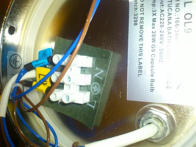

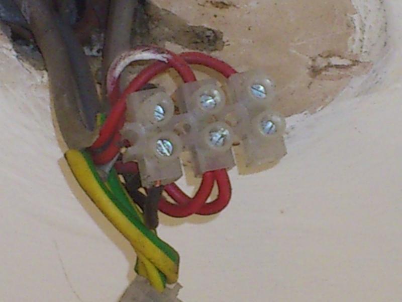

I have moved into a property where one of the ceiling fittings was removed. I have a new light fitting but looking at the existing wiring am at a loss as to how to put the two together.
The existing set up has three separate cables. Two have an earth and a black and a red wire. The other has an earth and two red wires.
All the earth wires are connected to a single terminal in a block. All the black and red wires are connected to various terminals in another block.
The new fitting has a terminal block.
Any advice on how to put the new and old together.
First two pictures are of existing and third of new.
Neutral to the blacks, Live to the single red and earth. I would link a piece of wire between the two blocks and push that block back up where it came from.
In your pictures it shows three red conductors connected together, this is the live loop, they need to kept connected together but not directly to the light fitting. So a separate connector is required for that. Do not be tempted to pop this connector up in to the ceiling void, it needs to be within the enclosure of the light plate/rose.
You then have a single red core, this goes to live of light.
The two black cores that are currently connected together are terminated at the neutral of the light.
The earths/CPCs (green/yellow) are terminated at the earth terminal.
The existing connector blocks can be cut down to single pairs, which will make it more manageable to terminate the live loop reds to, and leave inside the fitting. Not in ceiling void, as doing that is potentially dangerous.
You have a metallic light fitting that requires connecting to earth, it would also be recommended by me, that the earth continuity is verified by testing, to prove you have an earth fault path.

Firstly, you will take the conductors out of the connectors and terminate directly to light (except the live loop, which needs terminating separately)
The live terminal on the new light fitting should be connected to the only unoccupied terminal of the block that has the live and neutrals connected.
Your picture shows a three block connector that has 3 reds connected together that is the live loop. The one remaining red is the connected to the live of light.
The neutral on the new light fitting needs to be connected to either of the two terminals that has an existing black wire. It doesn't matter which one.
The two blacks (neutral) are both connected to the neutral of the light.
The earth on the new light fitting has to be connected to the terminal opposite the terminal in the block that has the exiting 3 earths connected.
You remove those conductors and fit directly to the terminal block marked earth on the light.

Disconnect those conductors form the connectors pictured and terminate them directly to those of the light fitting, with exception of the three reds in the live loop, they stay connected together and not connected directly to the fitting.

Thanks again.
So disconnect all wires from the blocks except the 3 reds that are connected to the same terminal and leave those as they are. I do nothing at all with those.
Disconnect and connect the two blacks directly to the neutral terminal on light fitting.
Disconnect and connect the single red directly to the live terminal on the light fitting.
Disconnect and connect the 3 earths directly to the earth terminal on light fitting.
I can get of all the blocks and terminals except the one with with the 3 reds in and cut it down to fit easier in the housing.
Sounds good.
You will cut off the unused blocks, and keep the remaining ones with the reds.
Be careful not to cut too much plastic away as you don't want to expose any more of the metal part of the connector.
May be an idea to check the terminal is tightened sufficiently, as it may have got distubed.
