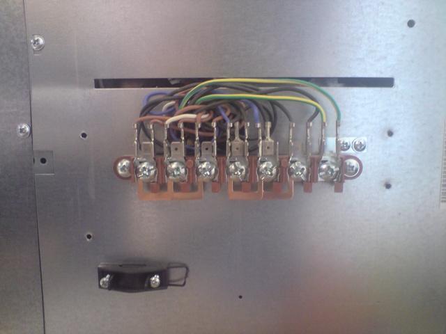

Hi there,
My old man is currently fitting an electric cooker (belling kensington 90e), and the problem is we are missing the wiring documentation. I'm fairly sure I know how to wire it up, but I thought I'd seek clarification from the experts first :)
The cooker is rated at 14KW. I've proposed he use 6mm cable, fed from a 40A wylex CU fuse with a cooker 40A disconnection switch on the wall near the cooker. The total cable length is around 5 meters, running up a concrete wall, under some uninsulated floorboards, then back down a wall in plastic trunking to the CU. What do you think?
Now, on to the actual wiring of the cooker. Taking the cover off, it looks fairly obvious. Three terminals paralleled with a busbar on the left (live), another three in the same configuration to the right(neutral), and far right is earth. Am I right, or?
Thanks for any input :)

The sticker on the rear says 14500watts :eek: We tried 10mm cable but in all honesty it's too thick to fit suitably in the CU and cooker terminals!
It will never draw anywhere close to that mate. 6mm is fine as long as you use a 40A fuse (but not a BS3036!).
I've just checked, and the current cooker fuse is actually 30A, so we'll be going with that :cool: Sorry for the confusion!
I'd be interested to know why 40A is too big for 6mm, though..
Is the cooker dual fuel? ie gas top electric oven . Cos the cable clamp and terminals look too small for 10mm anyways. the label will sometimes list the total including gas burners.. the large gas burners are also sometimes rated in watts.. ie the large wok burner is usually rated around 3kw.
Check the manufacturers instructions for fusing and cable size.. if you dont have the book then you can usually download a pdf of the installation instructions as long as you have the make and model number of the appliance.
looks like LNE left to right .
Phill
Nope, it's pure electric, and I agree with the clamp observation, there's no way we could fit our 10mm cable in it! It's nice and snug with 6mm, however.
We have no instructions at all, and couldn't for the life of me find a PDF or similar on the internet. I'll grab the manufacturer name and model number shortly...
