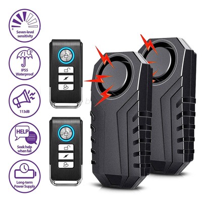

Hello!
i bough a couple of these
is it possible to wire the wire that goes from the circuit board to the alarm, to wire it to a relay that on the other end of the relay i could wire into it some kind of self dialing mobile phone?
You could have it short a button to dial the number assigned to that button.

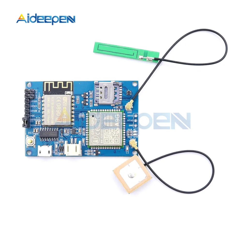

...or there are some lovely little ESP8266 development boards available, incorporating GSM and GPS, that would do the job:
Then, all you would require is a suitable enclosure, battery, voltage regulator and some programming skills!
The description is hard to read as in german, but it dose not really states that it connects to a mobile phone
Just for the record, this is not an alarm for a mobile biKe! it is an alarm for a static trailer
It doesn't connect to a phone - that board IS the phone. Needs a SIM card installing and the device programming.
Similar item with English description: https://www.ebay.co.uk/itm/313795882977
However there are preconfigured modules similar to this: https://www.ebay.co.uk/itm/355598498618 which are designed for the purpose and do not require programming other than configuring the phone number(s).

it says
2. Send SMS alert messages to up to 6 preset mobile phones when any alert input is triggered.
dose this mean it will only send a text message and not a phone call?
it says 5-15V. dose this mean that the input from the alarm must be of that for it to work?
Do you know if you can insert a sim card into it?
