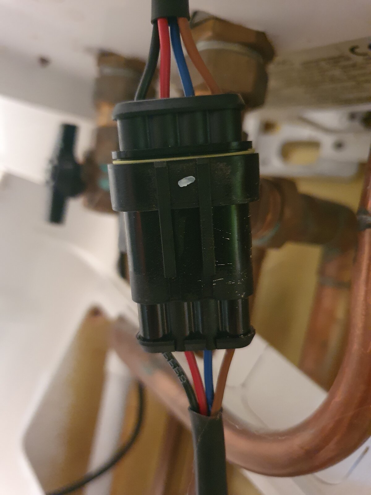

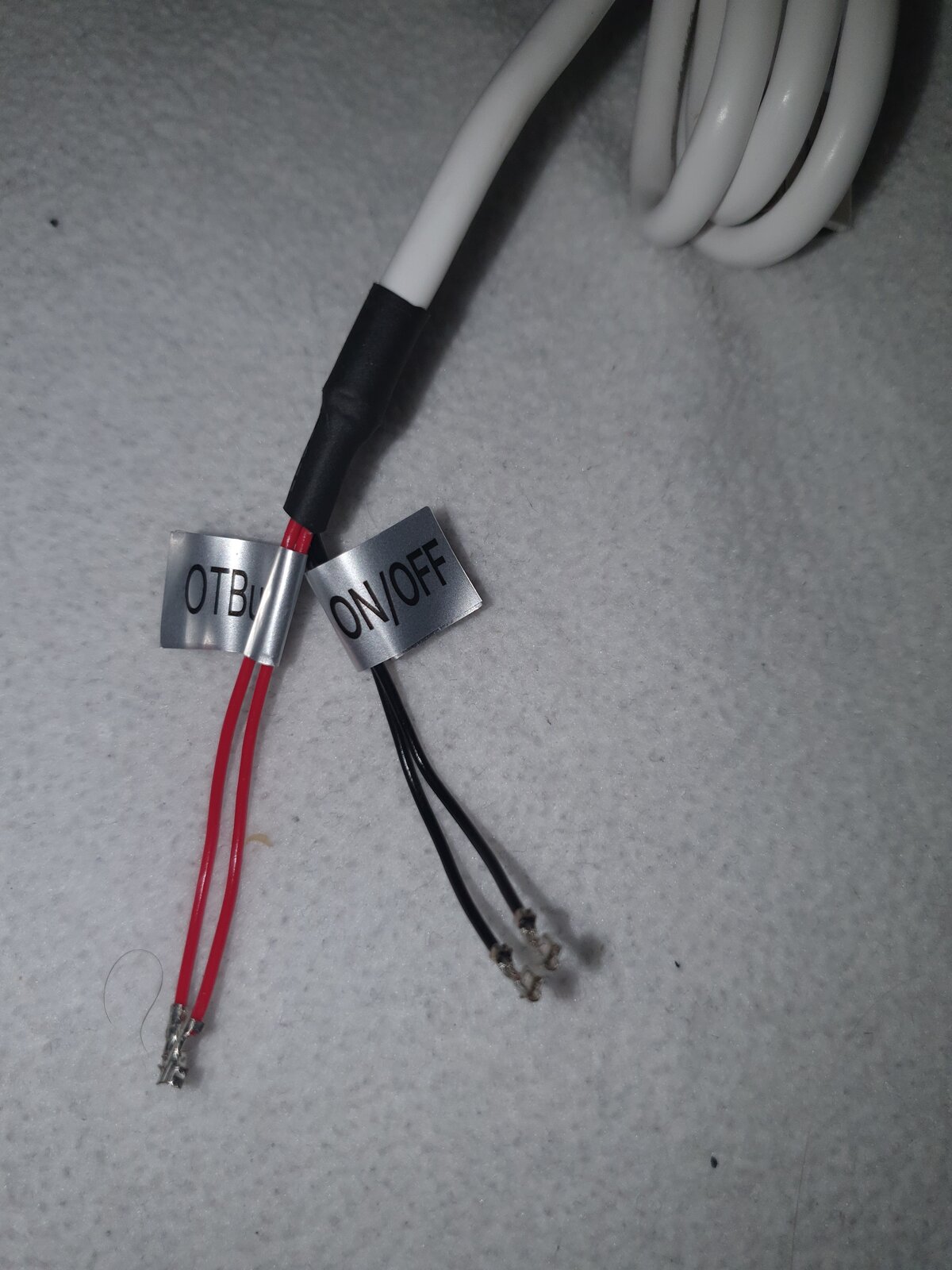

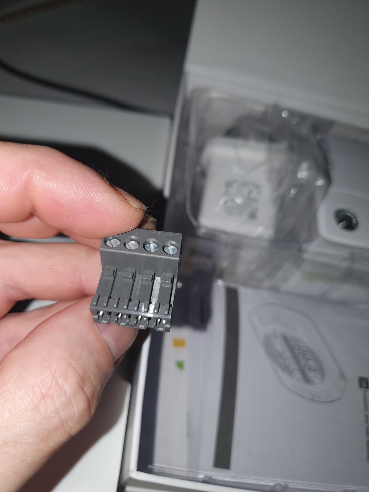

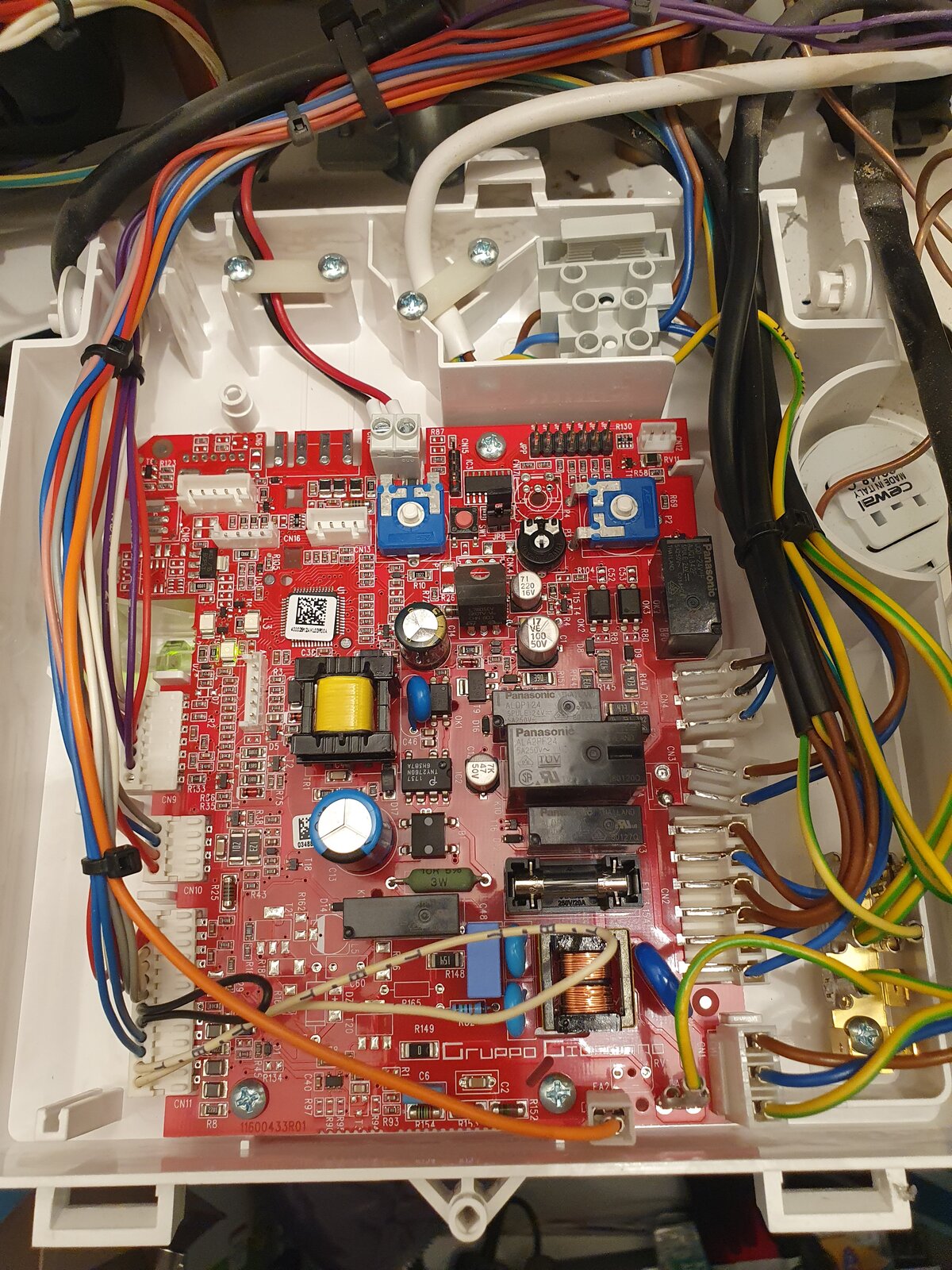

Hello guys. I have a boiler vokera easi heat plus 25c and I bought a room thermostat BeSMART if you could help me how to properly wiring.I apply pictures of the wiring board, the cable of BeSMART and another socket or something similar, also a picture of the socket for the mechanical watch and whether I should turn off the mechanical watch and if so how. Thanks in advance.

On your boiler you use the on/off wires, they go into CN5 replacing the red and black wires that go to the time clock, the Besmart controls everything, havent a clue who that old bloke is but he seems to know what he is doing :LOL:
