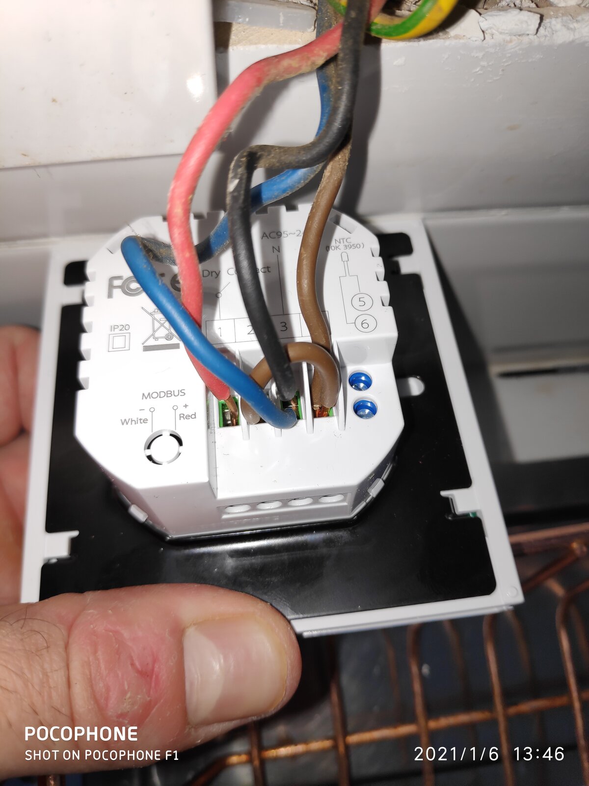

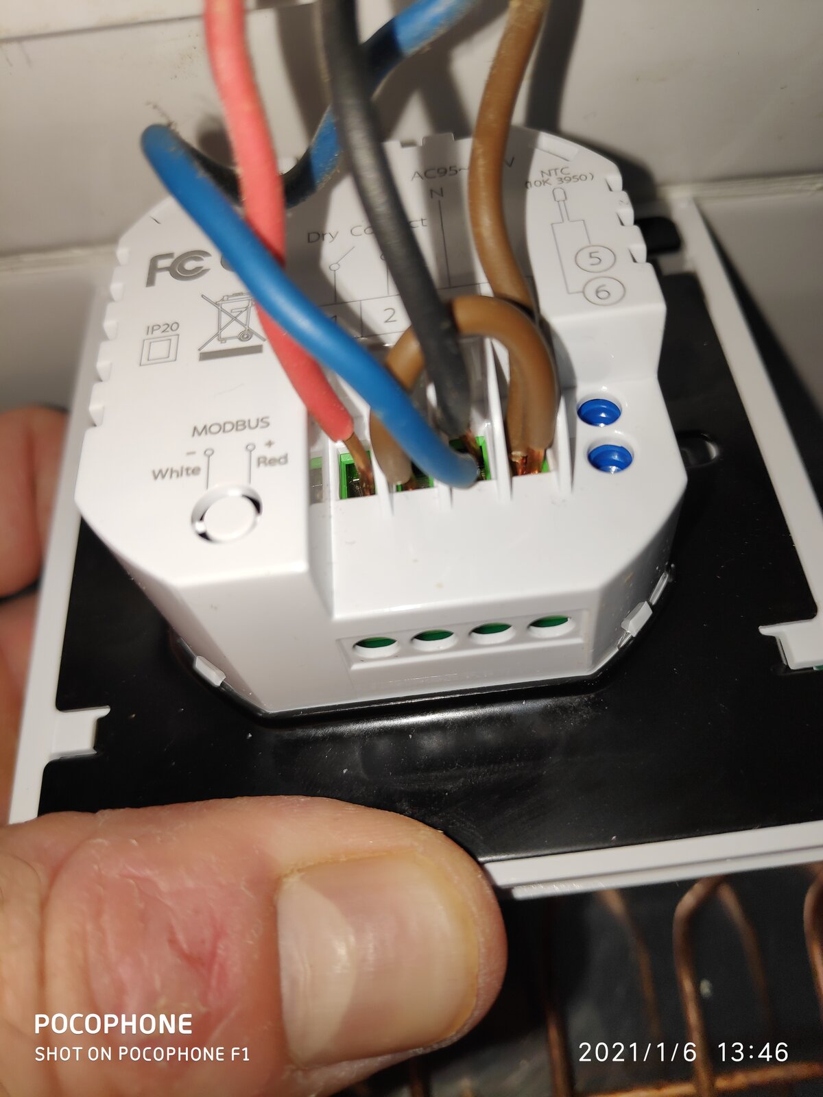

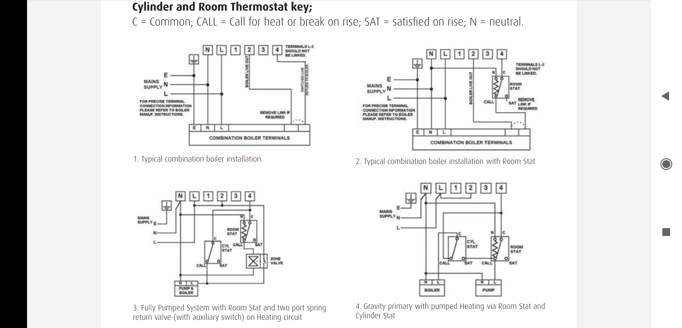

Another Chinese thermostat - shudder.
And as before it is a pain to put on the wall as the black metal plate and white face plate never slots easily together.
Either way - at your risk....

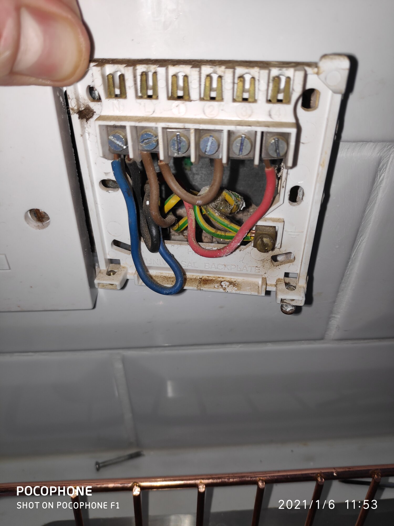

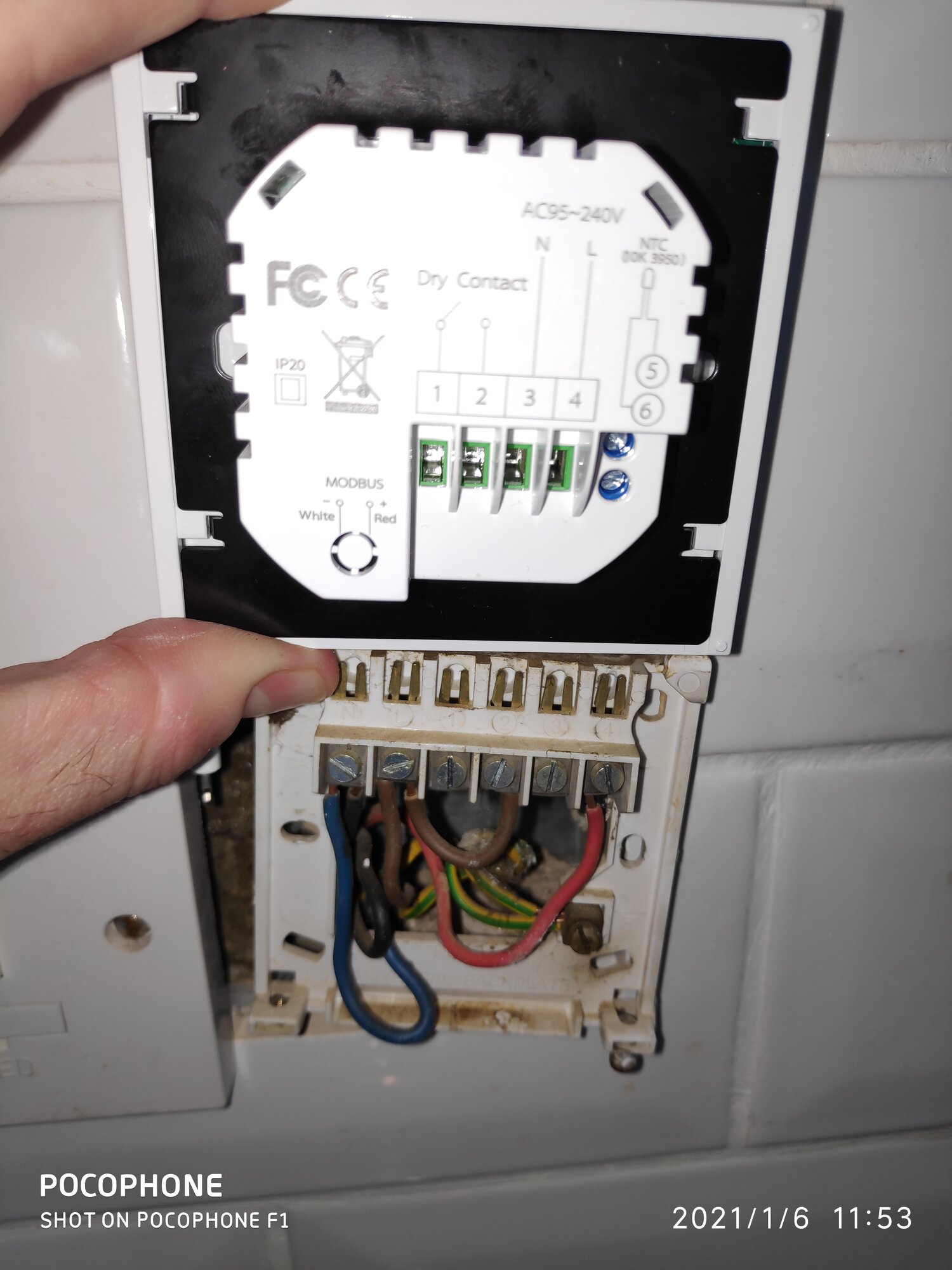

Yes your current wiring looks to match 'Diagram 4'.
In your case Joining/switching 2 (Brown jumper) and 4 (Red) together fires the boiler.
So 2 (Brown Jumper cable) on old unit goes into 2 on your new unit
and
4 (Red) on old unit goes into 1 on your new unit.
(or vise versa as 1 and 2 on new unit can be swapped - I suggest above as your jumper cable is short).
SFK
Thank you for input
Rik
I would cut the bare wire section of the red wire a little shorter so there is less bare wire protruding from the hole (minimises chance of it touching something else).
