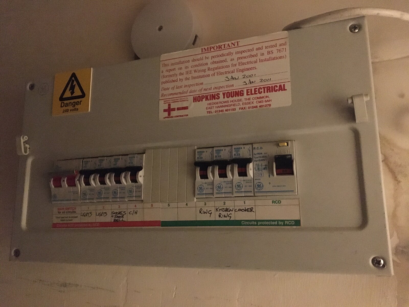

Please post a photo of your consumer unit.
voila
And I’ve just noticed the “recommended date of next inspection” sticker. I’m only 10 years late (n)

What you do or don't do in your house is your decision, but personally if it was my house I wouldn't be worrying about RCD protection for additions to the lighting circuit.
It might be possible to move the lighting mcb(s) across to the rcd side of the board.
Depending on what's under the cover.
