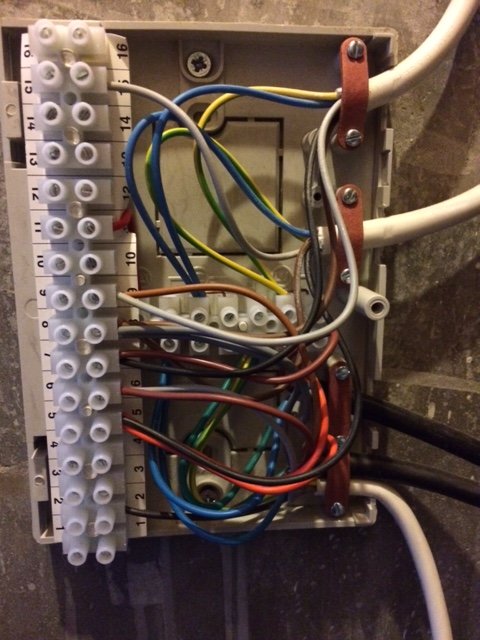

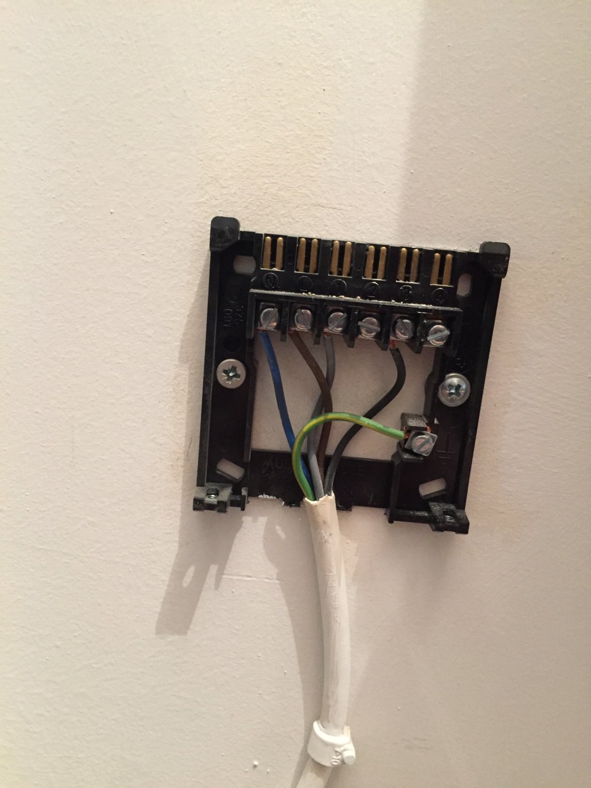

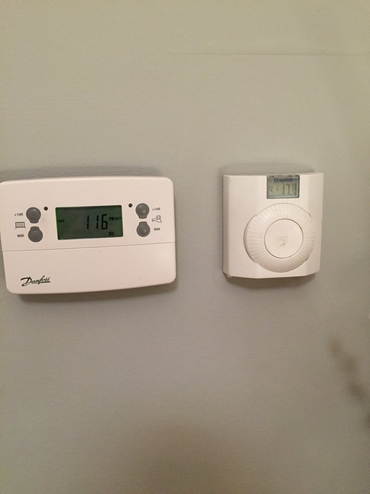

Hi both - I have been looking at this post trying to do something similar. I have a Drayton Digest that I am trying to replace with a Hive (heating and HW). I have replaced the Drayton SCR receiver with the Hive and moved the call ports from 1&3 to 3&4 (photo 1 below). Question is whether I need to change anything in the wiring centre (photo 2 below). I would like the wall mounted thermostat and timer (photo 3 below) to be disconnected.
Any advice would be much appreciated.
Many thanks
Scott

Hi Scott0710, and welcome to the forum.
The existing SCR Receiver only contains the wiring that controls the central heating. There are no wires present there for control of the hot water, so you cannot install the Hive receiver there and expect it to control the hot water.
The Hive receiver should replace the Danfoss programmer shown in your third picture. You will need the dual channel version of the Hive for heating and hot water control.

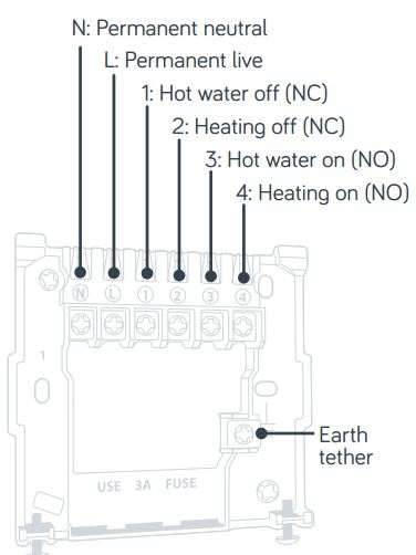

The Danfoss programmer is wired as below:
And the Hive dual channel version is wired exactly the same. Lucky you, they are a straight swap. :)
The SCR receiver shown in your first photo should be decommissioned. It cannot just be disconnected, otherwise the heating will be 'open circuit' and will not work. You need to trace the white cable shown in your first photo of the SCR receiver back to its origin at the wiring centre. Unfortunately not all wiring centres are the same and / or installed the same and I can't see the wires clearly enough in the photo to follow them with certainty to tell you which they are.
When you have found the other end of the cable, note where the Grey and Black wires are connected. Now disconnect all four cores of the cable and remove it from the wiring centre. Then insert a wire link between the two terminals where the Grey and Black wires came from thus joining them together. The SCR receiver backplate and the cable to it can then be discarded.
For future reference it is best if you start your own new post rather than tag it on the end of someone else's, doing so means that it could easily missed by most. This is also called hijacking and is against the forum rules. Don't start another one now though, or you will have two threads going on the same topic, which gets very confusing, and is also against the rules.;)

I would like the wall mounted thermostat..... (photo 3 below) to be disconnected.
I didn't mention it, because it won't have any wires connected to it. It is linked by radio signal to the SCR and is battery operated, so once the Hive is up and running, just remove it.

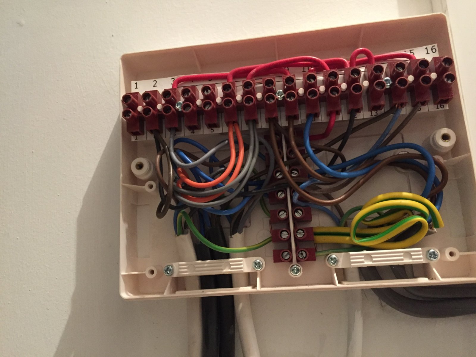

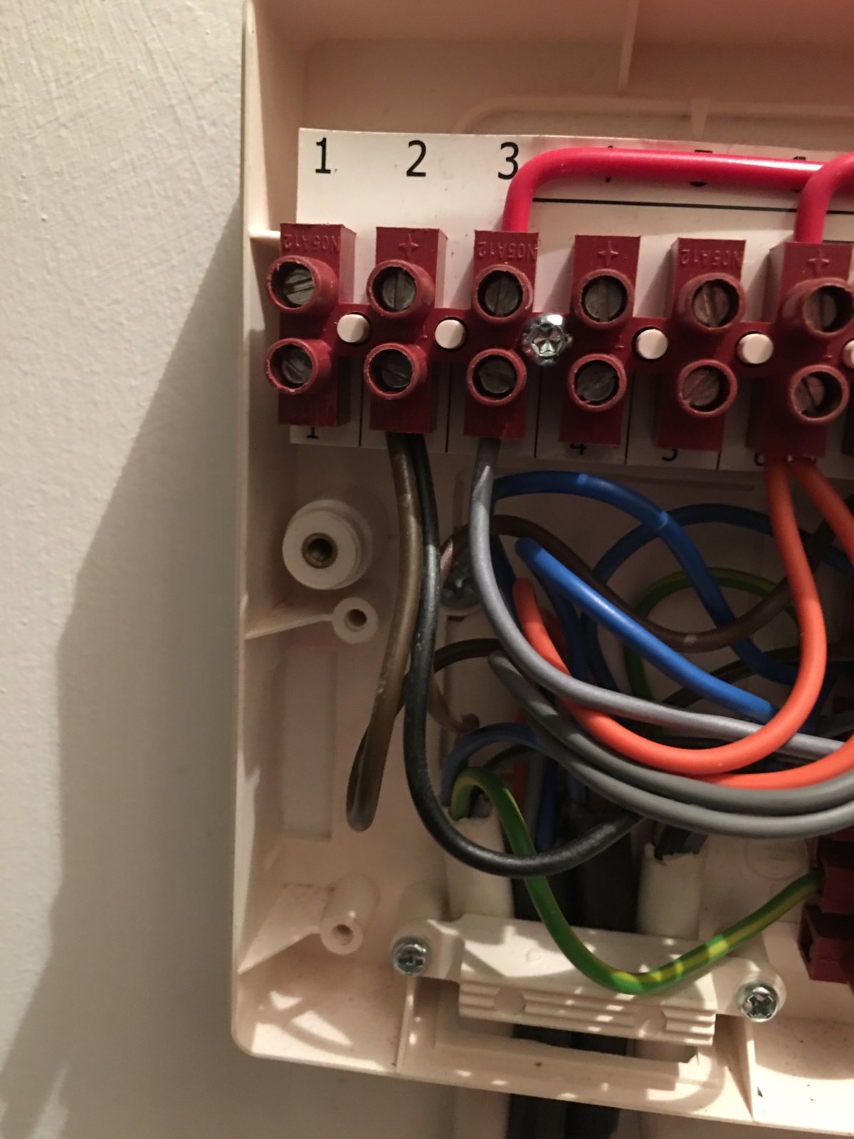

Just a final question if you don't mind - the grey and the black that need to be removed from the wiring centre are in the bottom side of ports 2 and 3 (photo attached) (also two wires into port 2, I assume the brown stays where it is). When you say wire link where the grey and black were removed from - do you simply mean attach a single short length of wire between those two ports (in this case 2 and 3?).
Again, many thanks,
Scott
Yes, you are on the right lines. All four wires from the thermostat cable, plus the earth would be removed, and that's all. Any other wires will still be required.
I thought the terminals for the black and grey would be 2 and 3, but couldn't be see well enough in the photo to be sure so thanks for that clarification.
Once you have removed the wires, it looks that you will be left with just a brown in 2, and a red in the top of 3. If so, then you can either insert a wire link between 2 and 3, or instead just move the remaining brown wire from 2 into 3 so that it connects with the red, and so electrically achieves the same thing.

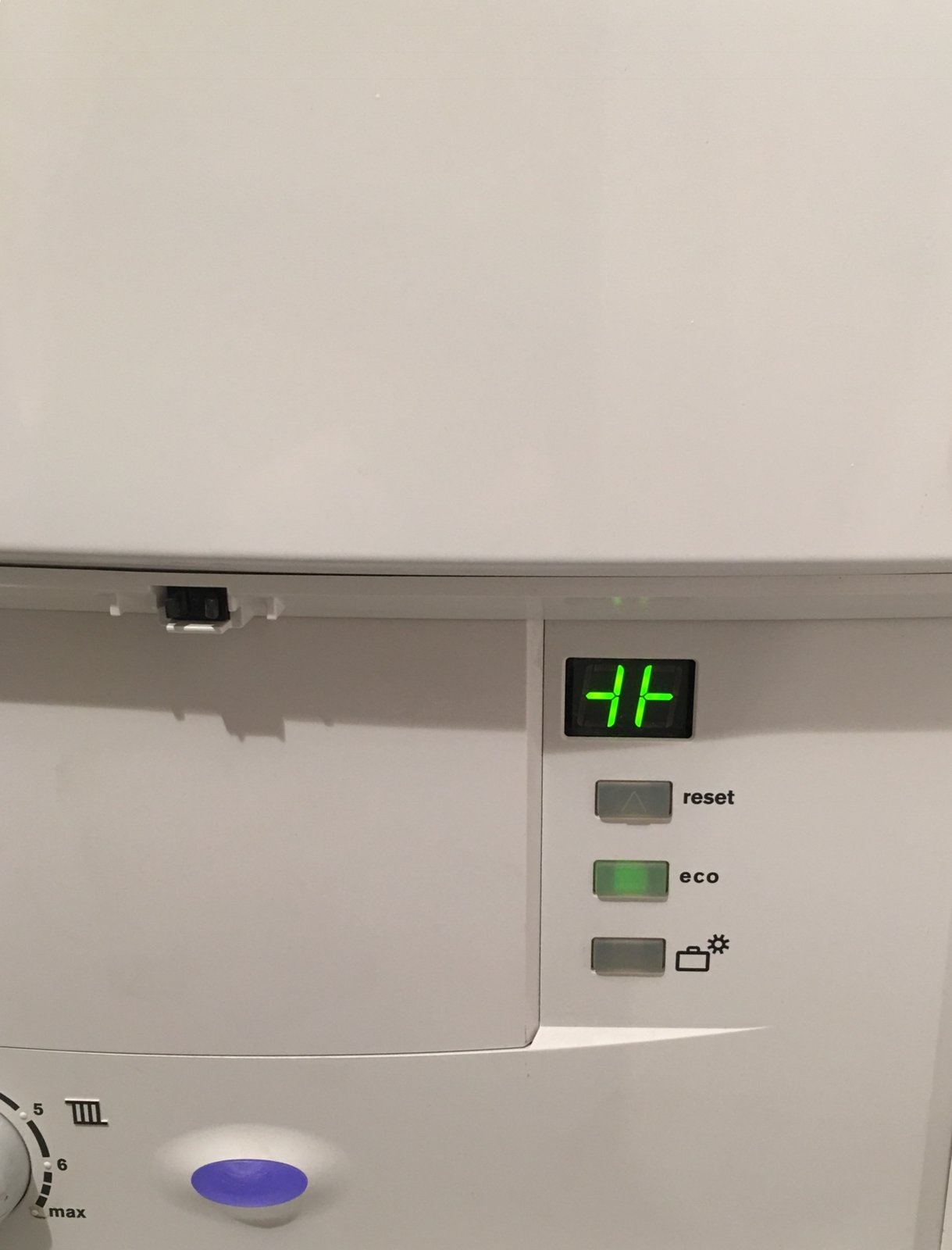

Thank you - I have done all of that and the receiver/boiler seem to be talking to each other, certainly the boiler fires up. However, the CH isn't actually coming on and the boiler is displaying the attached code intermittently with temperature (it is a Worcester Bosch 30CDi. I think I am very nearly there - am I?
Many thanks
Scott
Yes sounds good to me, but I'm a sparkie, so not really au fait with the boiler workings, but I think that's normal when power has been interrupted. See excerpt from the boiler manual below. You probably just need to be patient.
