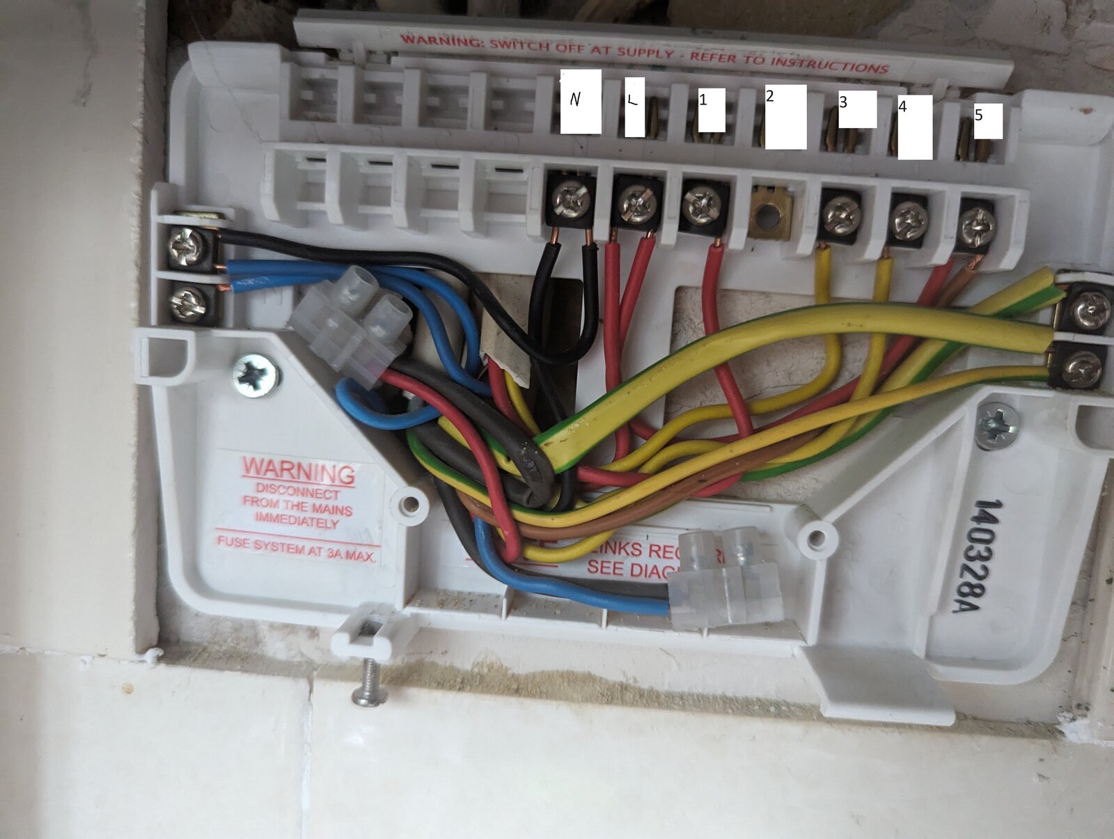

Wiring Diagram help maybe possible please Potterton to Tado V3+
25 Feb 2024
2
I am so confused with my set up. To the point I looked and went..... I KNEW YOU WERE GONNA BE TROUBLE its a potterton EP2. I've established that the wire from L to number 5 can be removed as its built into the TADO v3+. I can see the links on the left and right of the picture those cables need to be together i think. I think the box connectors are there to stay too..... but I'm hoping that its going to be a simple straight swap in wiring right? I believe its set up in Y plan. Any ideas?
So looking at the Tado and looking at the wiring could I get around using the parking 1 & 2 to eleminate the box connectors and use parking 1 screw to connect two wires together?
Seems likely. Can you post a photo of the Tado?
