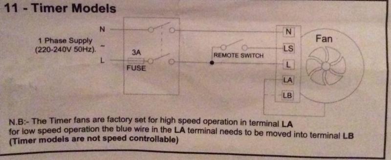

I have replaced old ceiling fan with new inline Vent-Axia ACM100T installed in the loft. The old fan was feed from ceiling rose through DP pull cord switch and 3AMP FCU using two core cable (main supply -> DP -> FCU -> fan). According to manufacture instruction new fan should be provided with a local double pole isolator switch and must not be earthed (see below attached wiring diagram).
I had to change installation as new fan requires LS for timer to work. Main supply feeds from ceiling rose to FCU then to DP (two core cable) and then from DP (3 core and Earth 1mm2) to the fan (main supply -> FCU -> DP -> fan).
DP is old Crabtree pull switch with L1 L2 L3 L4 terminals. Feed in from FCU: live (red) to L3, neutral (black) to L2, earth (yellow) to earth terminal. Feed out to fan: live (brown) to L3, live S (grey) to L4, neutral (black) to L2, earth not connected at the moment. L1 terminal is not in use.
Fan: neutral (black) to N, Live S (grey) to LS, live (brown) to L, earth not connected.

Fan and timer works OK but I have the following questions:
1. Is my new installation correct and with accordance to manufacture guidance?
2. Is it with accordance to the current building standards and regulations?
3. Is DP wired correctly as I wasn't sure about this. I assume that neutrals should be connected together and permanent lives as well?
4. Should I use 3 core cable from FCU to DP? I found some similar topics were 3 core was used. If so why?
5. Is it required to install 3 pole fan isolator in my case?
6. What about feed out Earth from DP to fan? Should it be connected to earth terminal at DP? What about at the fan side ?
7. Are cable colours used correctly?
8. Did I missed something? I'm not a sparky and would like to sleep well ;)
Thanks in advance.
Properly not what did the manufactures instructions actually tel you to do?
Let me rephrase my question as I think I know where this is heading. Based on my description is my wiring in line with the attached manufacture wiring diagram?
Would depend if you have not complied to to any, part p states the installation must be safe, is it have you proved this by performing the correct inspection and tests and documenting them, if so can you confirm via your finding that it is safe? I agree wiring must be completed by qualified person..
I take your point here I did not follow part p in my testing so as the building standard is concerned the answer is NO. I only used tester screwdriver to test hot (live) wire in the circuit.
Double pole would suggest that both poles line and neutral can be disconnected and energized by the same function, it does not seem that is the way you have configuration the switch.
Do you mean that neutrals should be in separate terminals? so neutral feed out to the fan should be connected to L1 terminal? In such configuration timer does not work. Could you collaborate on this? Also manufacture guide states that the fan SHOULD be provided with a DP switch which in my understanding is not the same as MUST be?
If we ignore the fact that you have a DP pole switch but have not configured it to operate two poles, I would hazard as guess you have but without test I can only guess that you have!
The test/neon screwdrivers are an unsafe and a unreliable test instrument, don't trust your life with them! When testing use approved instruments that leads comply to GS38 and folow inspection and testing procedure that are shown in Guidance Note 3
As stated previously DP switch you have switch live on one isolation pole but have kept neutral continuous, i am sure on the switching arrangement of this switch, so connect it up correctly as a DP function I would need to see the MI or test the terminals.
When it comes to safety, Should and Must in my language mean the same!
Is switch live required from FCU to DP? I thought only from DP to fan?
Pull cord should be fine
Earth is continuous from ceiling rose to FCU then to DP. The fan is double insulated and there is no earth terminal. What should I do with earth wire from DP to fan?
CPC/earth should be continuous to each accessory, the ex-fan MI may say class II don't connect earth but you should still run the CPC to fan and then sleeve and terminate into a connector, this does need need to be connected to the unit! A connector can be placed inside the enclosure of the pull cord!
