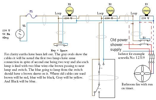

I have a 3 pole Fan Ceiling Pull Cord Switch (see here http://www.tlc-direct.co.uk/Products/ASCS3PIF.html)
This has two sets of connectors marked as follows:
L1, L2 N and Earth
First question, which is the switchable live L1 or L2?
Also there is an IN and an OUT. Which way round do they go?
Secondly do I connect switched live and live to the same live point on the power source?

its a 3 pole switch - ALL 3 POLES are switched.
Your timed fan wont work with this switch.

You can use either, it's just an isolation switch.
It's not meant, of course, to control the operation of a timed-overrun fan.
Yes, if you don't want the timed-overrun feature, but if that's the case you could have bought a cheaper fan.
If you do want it to run on then of course you need a permanent live supply to it as well as a switched one.
The diagram for the fan makes it all clear.

He said a combi boiler replaced is so I would have though he really meant a power shower i.e. little pump which powered the shower not heated water and normally around 5A so should be OK.
Spot on :)
I'd like to think I'm competent, just ignorant of electronics. I need to know what to connect from the fan to the switch. And then from the switch to the electric supply.
3 X 4 connection points.

OK special for you standard wiring would be
But so you can use the old supply I have altered to old wires shown as dashed wiring in order to wire this way you need a double pole switch and I think only way is to use grid switch so something like and also and will be required click on picture for details.
