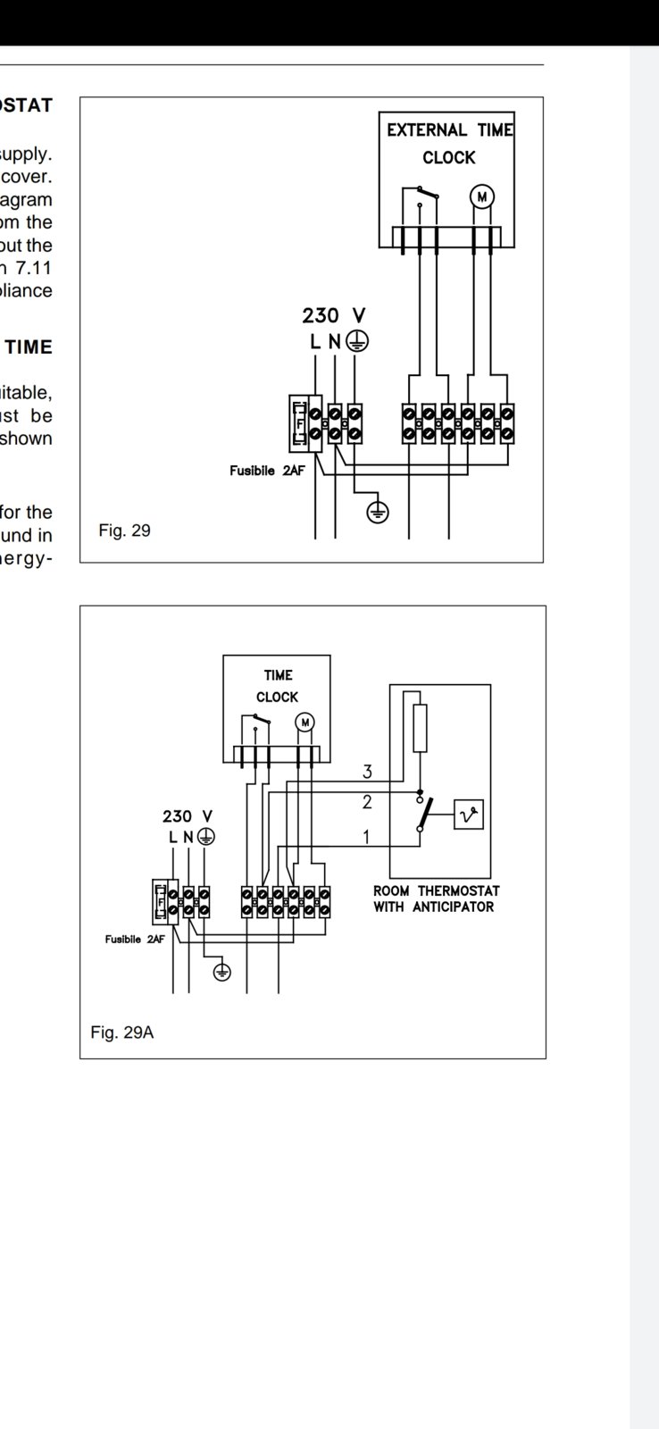

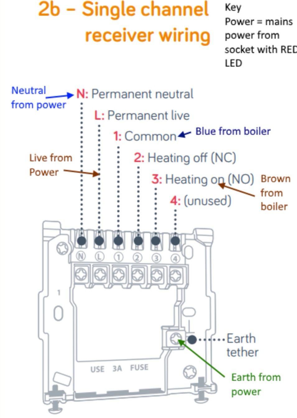

Hi, trying to connect a hive to a Vokera compact 28 combi. The boiler has no external controls connected to it and runs of built in mechanical programmer and the boiler is connected directly to a 3 amp spur.
I want to keep boiler on constant and use hive to turn on / off at temperature, do I wire the power cable from boiler to 1 & 3 as shown in diagram and should this operate like switch? Any help and advice would be appreciated!

Nope which compact do you have there are loads of them

Ok, so when following your above instructions which you gave to someone else. Do I need to unwire the timer clock and replace them with the 5 core cable which will also wire into the hive receiver?
Again depends if your boiler is the same if it looks the same as that pic then yes, if it doesnt look like that pic then it may be different, there are many models of Vokera Compact
Yep, exactly the same as the pic and the same as the above wiring diagrams. So basically just replacing the timer wiring with my 5 core flex cable by following your simple instructions. Thanks for your help, appreciate it.

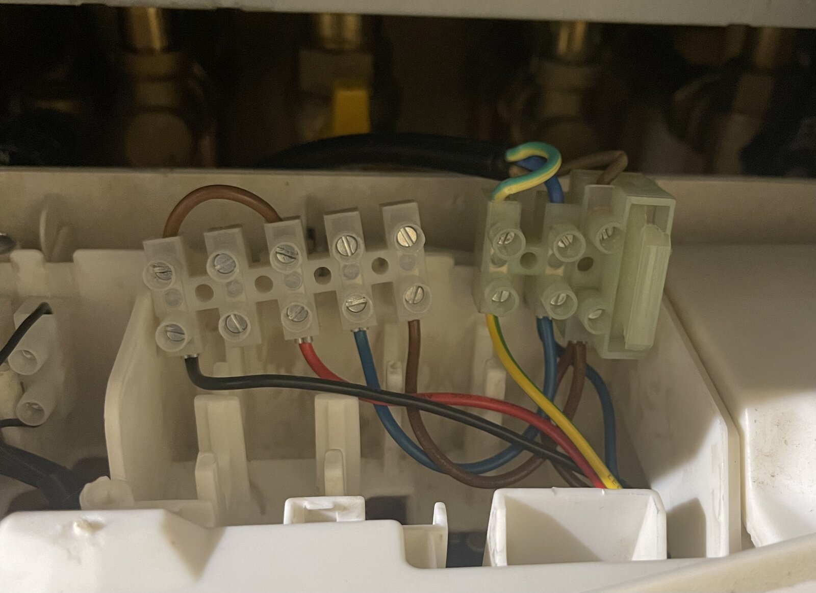

Hi everyone,
I’m in the same position, in addition to all the above, excluding the L&N, my boiler has two wires on the timer side which are originally looped, one black and one red, so which one goes to common on hiv and which one goes to heating on, i.e. 1&3 on hiv.
Many thanks
