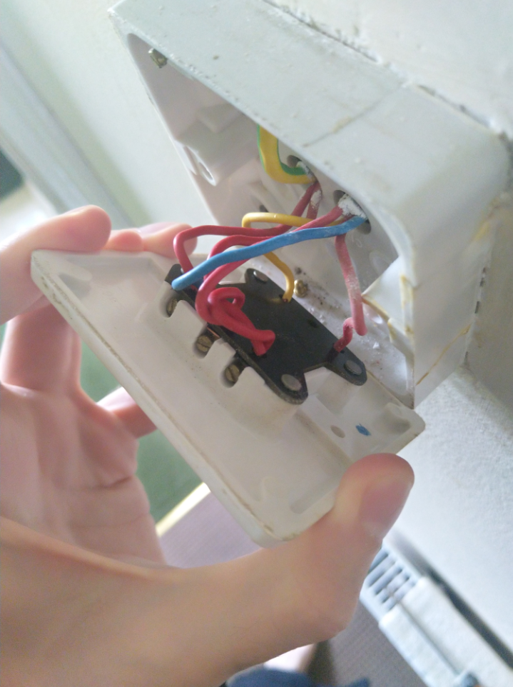

Wiring old 2 gang 2 way switch to new style
3 May 2020
2

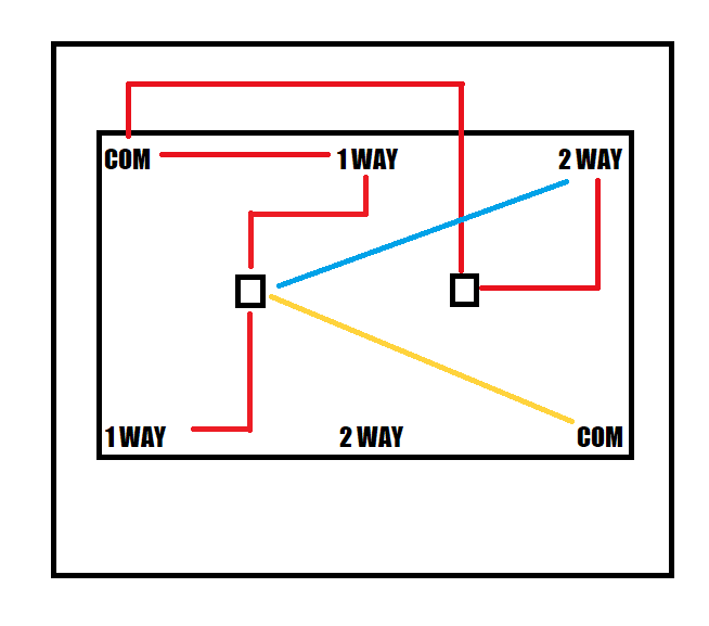

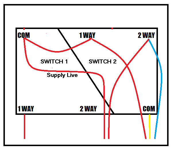

Added a couple of images. I havent been able to find any images of how my old switch was wired up so I wanted to ask for some advice on what to do. I want to replace it because as you can see the old one is pretty knackered, but all the new switches have the 2 vertically separated terminals.

I don't understand your drawing. What are the squares?
The new switch should be wired the same as the old - if it worked properly.
Ah, the squares are the cables.
In which case you seem to have a single red from a third cable which you have missed.
