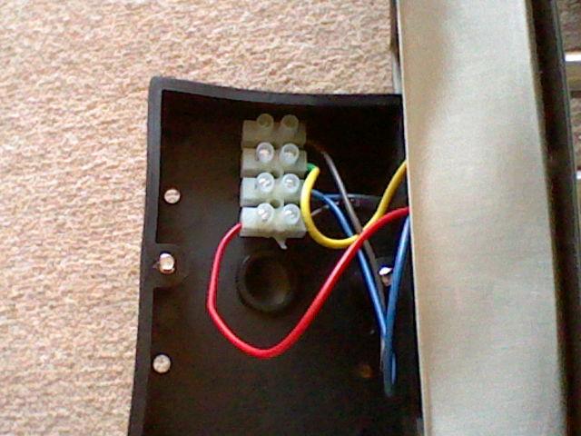

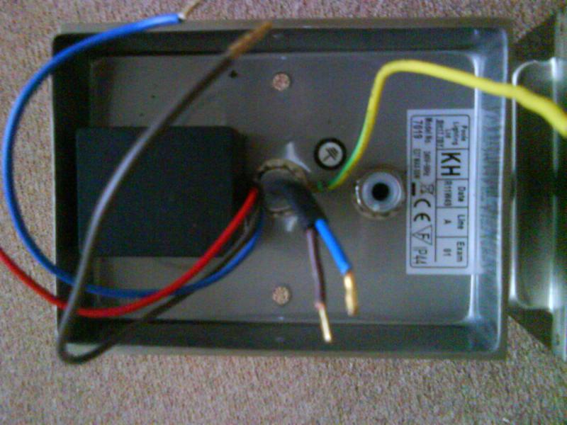

The previous wiring can be seen in photos old 1 and old 2 in my folder. The light switch is in the photo called switch. The terminals on it say in order, top left = way, L1 , (red wire),L2 (black wire) and there's also an earth.

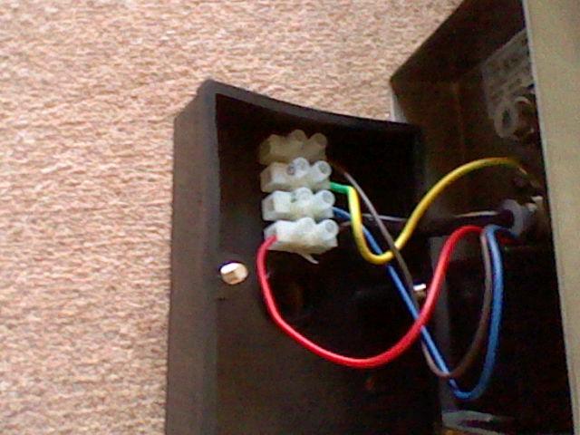

Better pic of the lamp below.
So what are we looking at, I can't see yellow, blue, red, earth cable from supply.
Can you please confirm what these pictures are?
Is picture one and two the existing fitting but not connected to your supply?
Have you picture of new fitting and supply cables, what do the instruction with it say?
where is the black sheathed flex coming from with brown and blue cores?

Sorry about that - they were named accordingly in the album and I thought they would be here too. The first two pics are the previous light (non-PIR) , the one with the red wires is the internal light switch and the final one shows the wiring on the new PIR lamp.
The instructions only make mention of 3 wires - , blue (n), green/yellow(earth), brown (l). It also says 4th block provided for loop termination if required, as mentioned previously.
The black, sheathed flex seems to go to the light, the 3 single wires to the sensor

This still doesn't make any sense - hence no replies.
Manufacturers instructions will normally be relatively simple in so much that they require you to supply Permanent Line, Neutral and Earth to the lighting unit - this will allow the PIR to act as the switch.
The internal wiring to sensors etc are normally fixed by the manufacturer.
If, as you say in your initial post, you have an inside light switch then unless its double pole its not clear how are you getting your neutral to the new lamp. And you will be unlikely to need a loop terminal.
Nor can I see any sign of the power cables.

I've spoken to the manufacturer and they state that the PIR wires should come ready assembled in the chock block. This is not the case so I assume this is a shop-opened unit and will return it.
