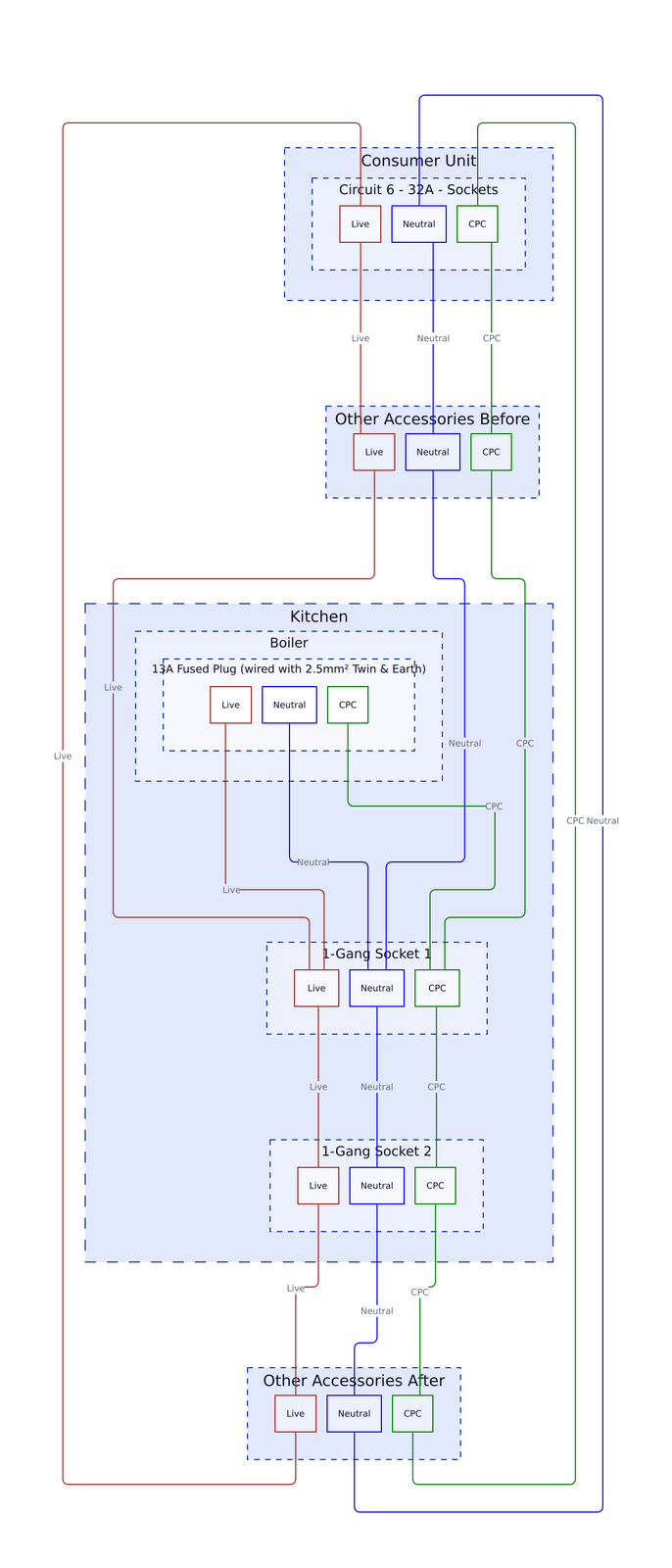

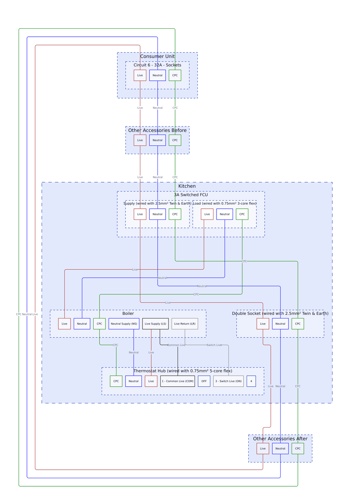

I am looking to wire my combi boiler with a Drayton Wiser thermostat. As part of this, I am also looking to make the following improvements to the current wiring:
  • Replace the boiler's twin and earth with 3-core flex, as twin and earth is not compliant for high vibration and heat areas
  • Replace the 13A boiler plug with a 3A FCU wired into the ring (not a spur) as it's the more common way to do it, and 13A is way over what it needs to be for the boiler (pretty sure that is also not compliant or following manufacturer instructions)
  • Replace the 2x 1-gang sockets with 1x 2-gang socket (part of the ring as well)
The first picture is a diagram of the current wiring and the second a diagram of the new wiring I am planning to do. I am also feeling quite competent in doing this.
Current Wiring
New Wiring
Anything I have missed?
Put a 3A fuse in the plug, then.
The gas engineer that came around told me that when they will replace the boiler (it's a very old one and it was getting serviced) they would fit a 3A FCU so I figured I might as well do it now to have it ready for the future. Also I need both gangs of the new socket free for other appliances.
There is no reason to do that.
A plug is better in one way in that you can completely disconnect (isolate) the heating circuit by pulling out the plug.
That doesn't make sense either - fit another socket instead of the FCU.

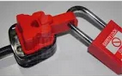

I agree with @EFLImpudence that easier to isolate with a plug and socket, to finding a lock that will fit the double pole switch on a FCU, I know you can get locks,
but the use of a plug locking device
is universal and every heating engineer and electrician likely carries one. I know you can put a lock through the fuse carrier, but that only isolates one live, the line, it does not isolate the neutral.
If a plumber wanted to swap a plug and socket for a FCU I would want to know why, as I can't see any reason to fit a FCU rather than a plug and socket, other than remove the temptation to remove it to power something else.

Thank you for your replies and yes it definitely makes more sense to keep the plug and just fit a 3A fuse in it. I especially like the fact I can hook the boiler to a battery backup this way.
I did a bit more research on why the gas engineer would want an FCU, and I found out that it's apparently a Bosch requirement to wire the boiler to an FCU, not a plug, for the warranty to be valid. It sounds very silly to me, but that is most likely the reason and it is part of the ToS.
