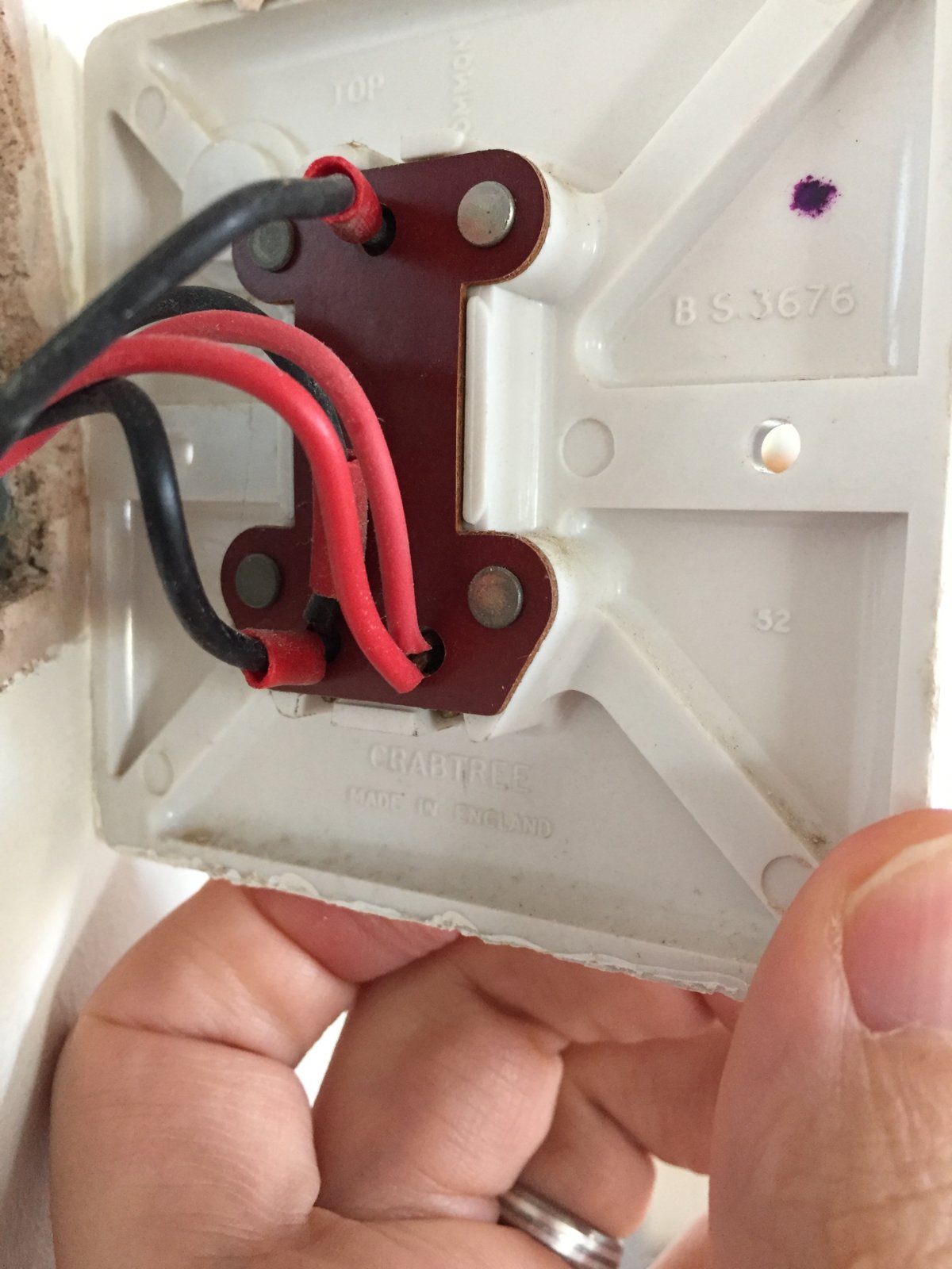

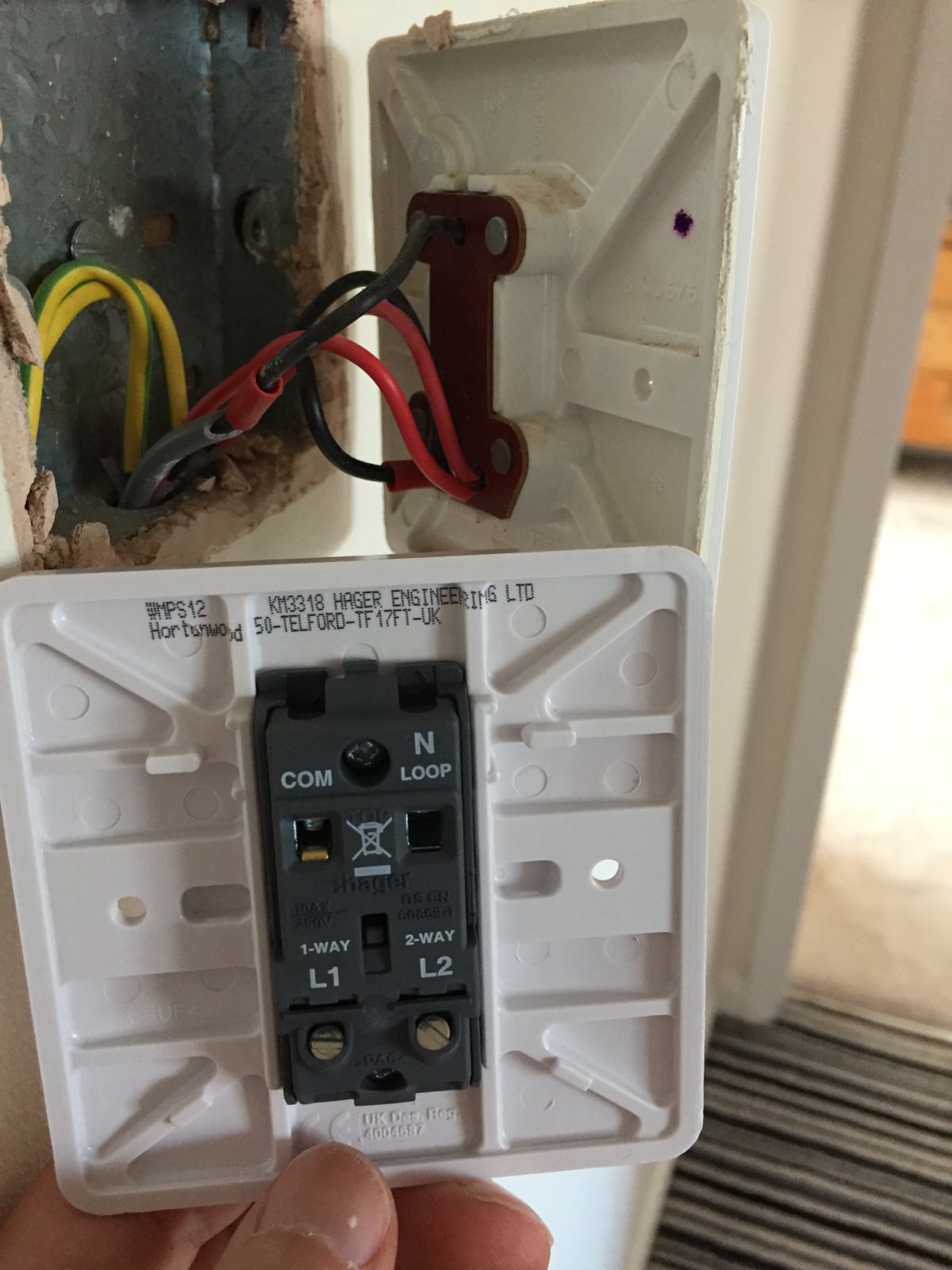

Hi,
I have some basic questions trying to replace a two way switch (a landing light where there is a switch at the top of the stairs and one at the bottom)
Currently there is 2 live wires, 2 neutral wires and another neutral wire which I assume is a loop wire?
In my new switch do I put:
1) the 2 red wires into the COM bit?
2) one neutral into L1 and one neutral into L2?
3) the other neutral/loop wire into the N/LOOP bit?

Hi jchannon,
None of the wires there are neutral that is why the blacks are sleeved with red sleeving. They are all live. In your new switch the single black wire at the top goes into the COM. The other pair of black wires go into L1 and the two reds go into L2. Nothing goes into the Loop.

Hi jchannon,
Huggybear.
Which is exactly how the existing switch is wired. Why did you think the new one would be any different?
