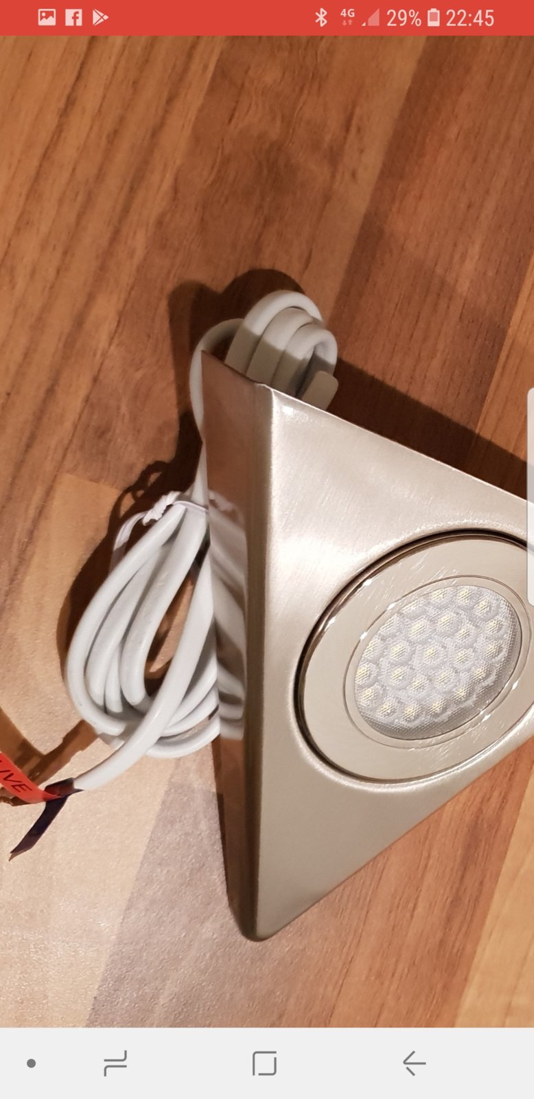

Hey thanks for taking time to read this,

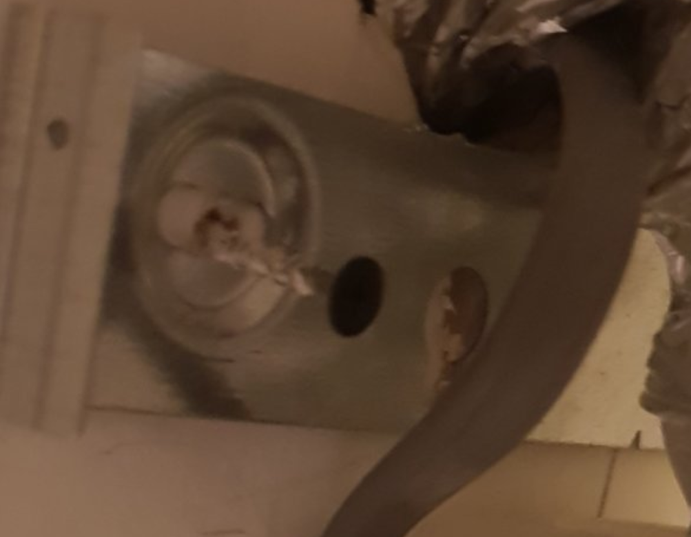

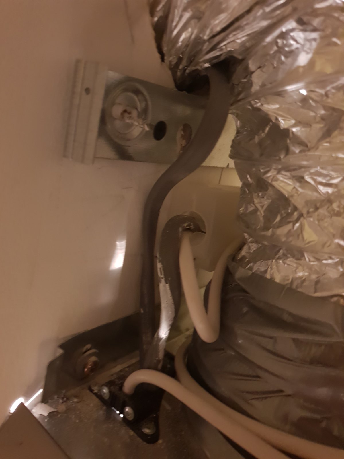

I have 4 triangular low watt led lights I would like to fit under my wall units, I would like to power them from my cooker hood, the hood has a main power cable coming in from the ceiling and connected to the hood cable by a connector block, I would like to know how I can connect the 4 lights to this main power cable if possible thanks

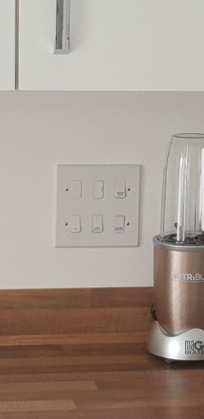

The cooker hood switch on the grid plate isolates the power to hood so was thinking by switchibg the hood on at the grid plate the lights would come on
I would want a separate switch, if it were me, but if you are happy with the grid switch…
Then
You just need to connect the LED lights into the plastic junction box, where the white lead from the cooker hood connects.
You may need to use a bigger junction box, if there are a number of cables connecting at one point.
Do I need to fuse the led cables as they are alot thinner? What would be the process to fit a switch, I would prefer a switch too but didn't know how to
Also the cables are only 1.5metre can I extend them using new cable and junction boxes
Isn’t there a fuse in the grid switch, it should be 3 or 5 amp.??
If so you don’t need another one.
If the wires aren’t long enough, then of course you’ll need to extend them. Any joint needs to be in an enclosure.
5A round junction boxes are made for the job, or something like this
https://www.screwfix.com/p/debox-in-line-connector-box/8692h
If you want a separate switch, it needs to go in the live feed to the lights. Like any other light switch.
