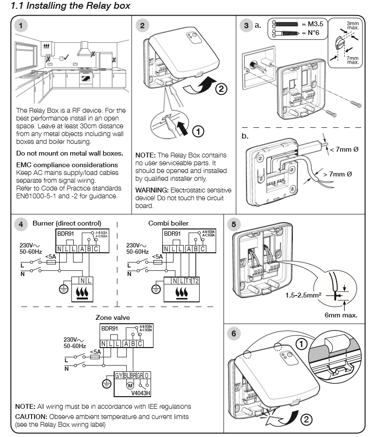

Here is the diagram of the boiler: eeeerty.JPG

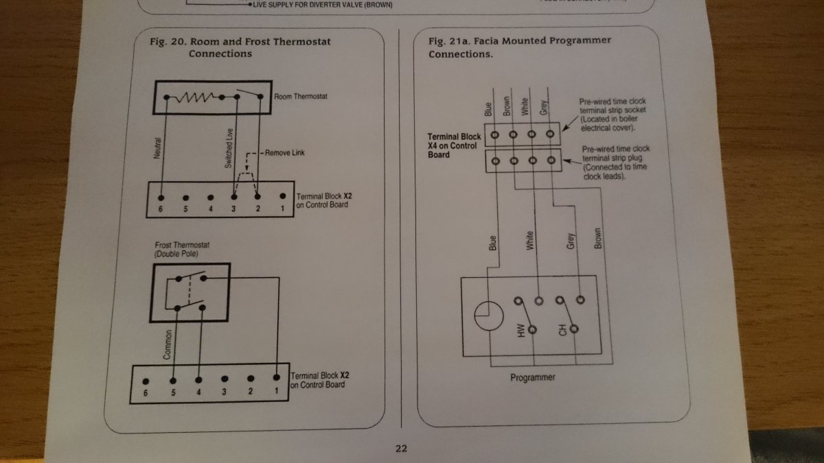

Unit Diagram: Untitled.png

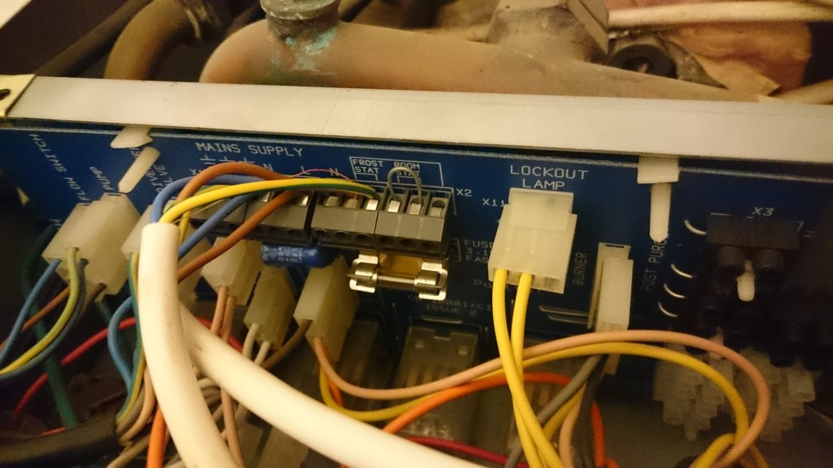

I had a look at the PCB console: DSC_0001.JPG
From what I understand I Am to take out the jumper pin in the Room stat terminal, place cables A + B into them, (does it matter which way?), and then place a L + N into the mains terminals of the boiler. Does that seem correct?
BDR91 centre to boiler
N = Neutral to 6 on boiler
L = Line to 2 on boiler (right hand terminal marked Room Stat)
A = Common to 2 on boiler I will guess the extra L on the BDR91 is to allow you to fit a link wire L to A on the BDR91.
B = Normally open to 3 on boiler the link on boiler will need to be removed. (Left hand terminal marked Room Stat)
This assumes it is a combi boiler, we don’t know if it is plumbed that way or not, it will matter A and B if linked at thermostat. 2 needs to be A if it links to L or when it turns off the thermostat will lose power.
I think it is just a conventional oil boiler. The instructions show heatslave 15/19 as a combi, however my boiler guy said this is a conventional. Hot water for example can only be used for 30 seconds if the hot water is set to off, however when on, one can then have showers etc. So would I use the burner (direct control) diagram instead?
Getting back to you late, but this worked a treat. Wired up according to the Burner (direct Control) Diagram which is what you have linked above. (the Combi Diagram is what confused me during this whole process, it wasn't needed in the end). The new thermostat is up and running, I have also removed the Frost stat that he wired incorrectly and was using a wrong fascia for :O
