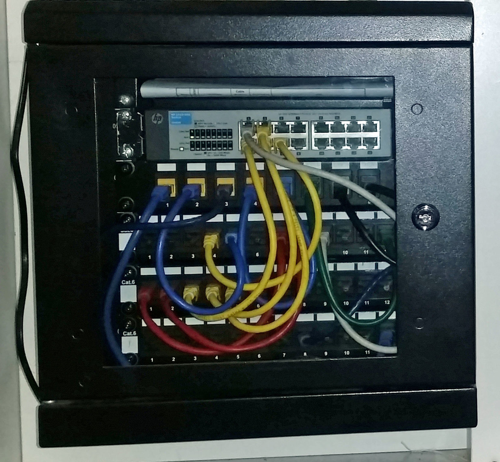

Note post #4 and don't forget the central Patch Panel.
Not everyone wants a patch panel in there house
Just remember to route the cables to a point a patch panel could be installed.

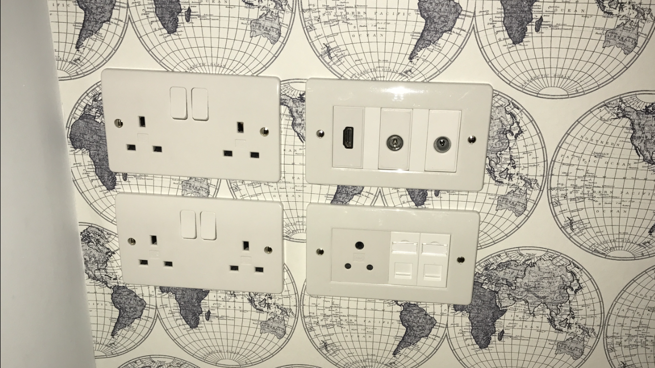

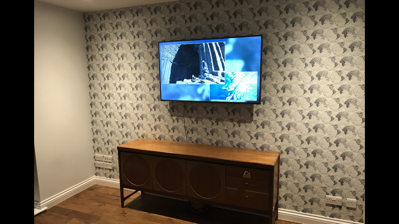

A recent job I did we ran 2x cat6 and one PF100 coax to each TV position, and in every room at least 2x cat 6 at low level adjacent to a socket, with most rooms having 4 data outlets in there.
In this room there is two cat6 points and a coax point behind the tv. Currently it is using one point for internet for the smart TV, and one point for sky TV using a HDMI over cat6 adaptor.
There is also a HDMI cable from the TV to low level to allow a games console , laptop or DVD player to be plugged into the tv, as well as having internet available at the same position for these devices.
