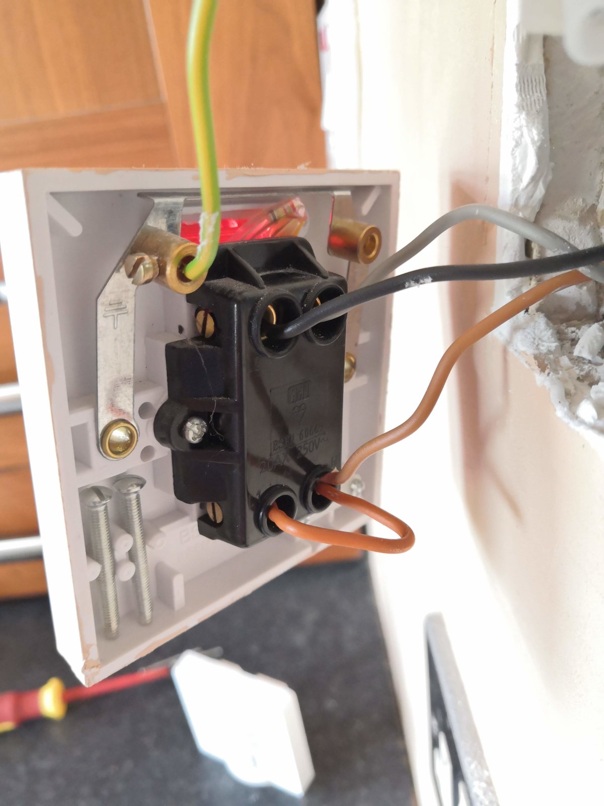

I have an existing simply DPST switch that operates the heating, firing up the oil boiler and also turning on the pumps to circulate the water in the rads.
I'm trying to swap it out for Boost-button timer switch.
The existing switch, aside from earth, has L1 & N1 and L2 & N2 connections.
As you can see in the image, the L1 and N1 connections are both fed by the same brown wire, which is the only live wire. The L2 and N2 connections have grey and black wire attached.
My Boost button switch has L(IN) and L(OUT) and N(IN) and N(OUT) connectors. I'm not sure which to connect where.
The things I tried either don't work, or seem to work (the boost button starts up the boiler alright, but the circulation pumps run continuously).
Anyone able to clarify which to connect?

OK. Whatever arrangement is in place, you should retain the switch and fit the boost somewhere else - under the switch? - so that the existing switch isolates all of the heating.
As you can see in the image, the L1 and N2 connections are both fed by the same brown wire, which is the only live wire. The L2 and N2 connections have grey and black wire attached.
You need to determine where they go and what they do.

Put both the Grey and the Black in the left hand terminal (looking at the picture) , move the Line(live) to the left and do away with the link wire.
Put the Neutrals in the Neutral terminals.

My presumption is that the all the wires are Live (ie there is no Neutral at this socket unless there are other wires you are not showing) and you currently have:
L1 Brown (LiveIn)
...switch...
L2 Grey (Switched Live out to Boiler)
N1 Black (Switched Live out to Pumps)
...switch...
N2 Brown (LiveIn)
So on your new booster you want:
L(IN) Brown (LiveIn)
...switch...
L(OUT) Grey (Switched Live out to Boiler)
N(IN) Brown (LiveIn)
...switch...
N(OUT) Black (Switched Live out to Pumps)
But as said this is a guess. And it seems a strange wiring. You need to test with a multimeter and not guess the connections.
Good point from EFL regarding your boost switch not being two switches, and only switching the side labeled 'Live'.
If the N side of the Boost Switch is not actually a switch, but is an always connected link, then my wiring above will cause the effect you are seeing of the "the circulation pumps [to] run continuously".
You would then be better off keeping the switch you have and having the Boost Switch switching the Brown Wire before this switch. But note that I think my "Timeguard" Boost switch also needs a Neutral to power up its lights and its electronic timer.

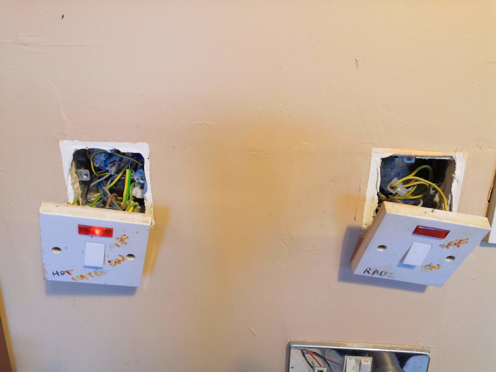

There are actually two. It's a crude arrangement given how modern the house is (10 years).
There is an oil boiler. There are two switches. One for the hot water, one for the heating.
Turn on the hot water, it fires up the boiler and—I think—a pump that sends the water to the hot water tank.
Turn on the heating switch it fires up the boiler and the pumps that circulate the water in the rads. There are a couple of thermostats around the house but I'm not sure how effective they are or where they are wired back to, but in terms of the overall control it's these two separate on-off switches.
The intention was to replace the switches with booster/timer switches so that instead of turning on the hot water boiler only to forget about it and come back to it 3 hours later to turn it off I would just use the boost button to turn it on for 30 mins or an hour.
Likewise the heating. I don't have enough confidence in the thermostats to leave the heating on and let it settle at the intended temperature.
(I have had heating engineers round for certain things and invited them to charge me for a few hours to work out how everything is hooked up, but they've only ever been interested in fixing the specific thing they've been called out for, hence I'm doing it myself.)

This looks like one switch cable, so that means it is likely to be coming from a place where all the wires for the system are connected.
Have you a large junction box anywhere? Near the boiler or in airing cupboard.
Or, indeed, can you trace where the cable goes?

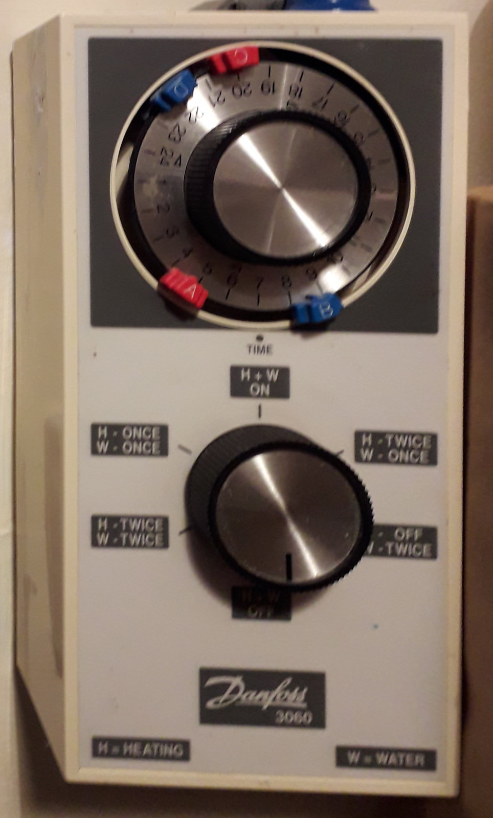

I had a timer, Danfoss3060programmer.jpg which did the job, but it needs a neutral, these
68088_P
push switches have the right idea, but instructions say only run for 10 minutes which is not long enough.

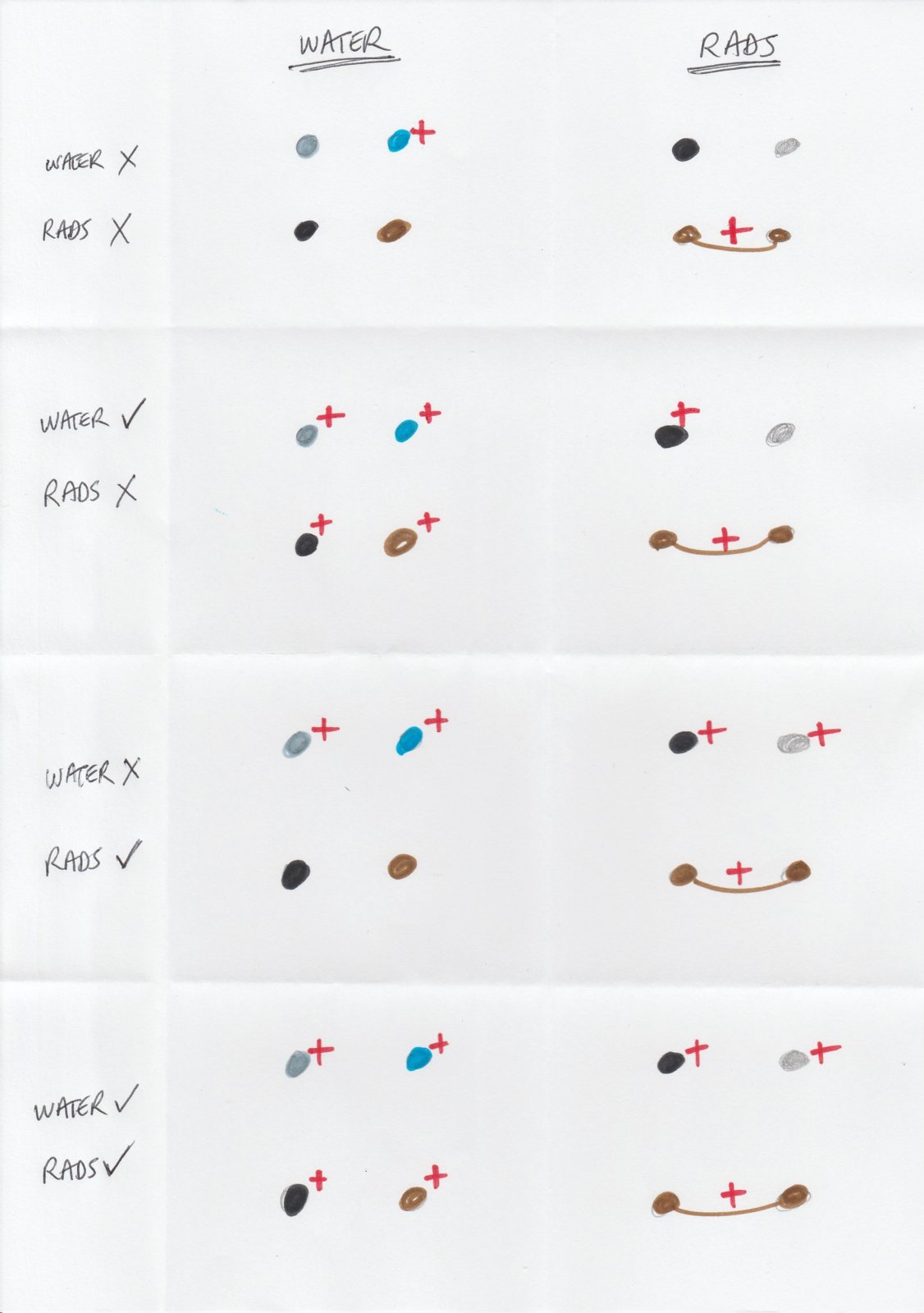

OK, I've tested everything with the multimeter, and established that there is a link between the hot water switch and the heating system switch.
I mapped which wires are live depending on which switch is on or off, it's in the scanned sheet.
Now to work out which to connect to the L(in) N(in) L(out) N(out) connectors of the booster switch. The timer-with-booster switch should arrive later in the week and I'm expecting it to have same connectors.

I like your truth table, it seems to confirm what I thought, but still have same problem, no neutral.
Not worked out water switch yet but rads switch is:-
Brown feed in.
Black pump.
Grey boiler.
So water switch
Blue feed in.
And all are clearly lines not neutral.
