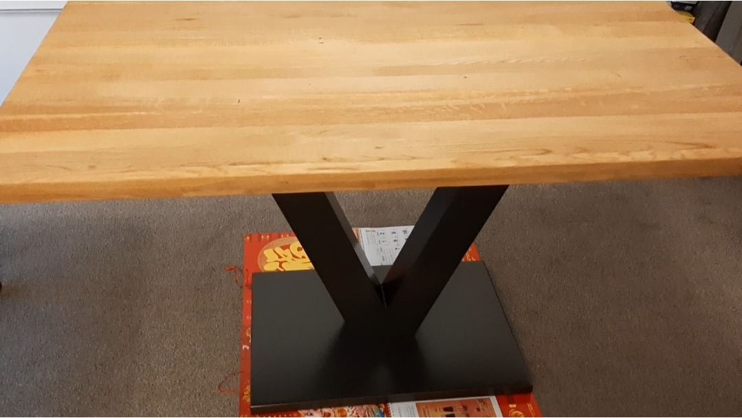

I bought this furniture village earth natural dinning table. It is a failure. It is wobbly. Because of the faulty design. The X shape base. Any idea how to make it stable like four legs table?

Presume you mean wobbly becuase contact with floor is smaller area than table top size (ie table acts as a leaver).
Normal tables do not have this issue as tabel legs are in corners so contact with floor is same size table top size.
Solution is to make floor contact wider.
Metal table legs in each corner.
https://www.google.com/search?q=table+legs
Or cross of wood bolted onto black area that is currently on floor.

Tables not faulty your floor is uneven.
That's a terrible design and on anything other than a completely flat solid floor it will be a bit unstable even if the base of the table is perfectly flat. As mentioned a leg in each corner is probably the only effective solution.
Or are you saying the flat base is not securely fixed to the legs?

Not that bad but it really is not as stable as the traditional ones. I might replace the legs in the future.

Sandbags! If you weight the base down with sandbags that should do the trick.
Alternatively drill four holes in the corners of the base and screw or bolt it it to the floor. It won't tip then. I reckon M14 coach screws with washers (wood floor - try to get at least two into the joists) or M14 resin anchors (concrete floor) should do the trick.
Seriously, though, it is a very poor design
