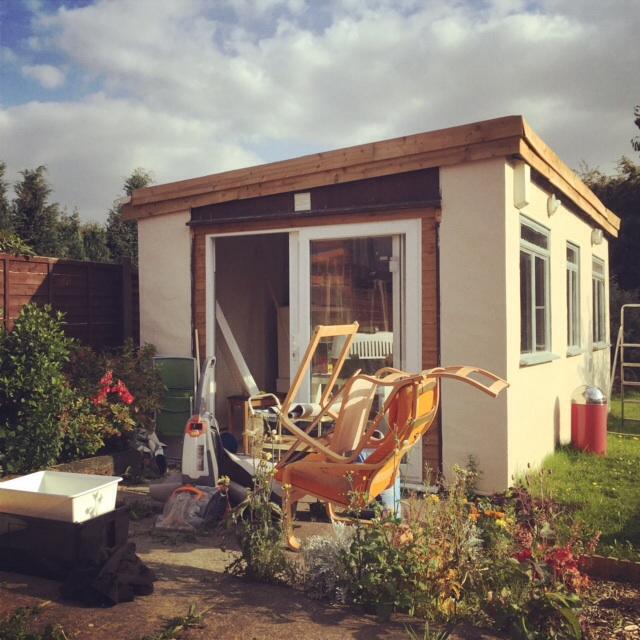

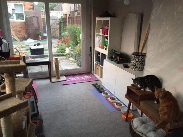

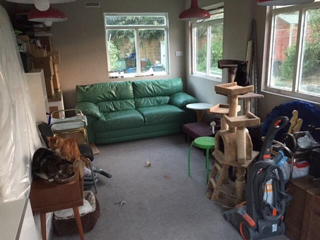

I want to install a wood burning stove in an outbuilding, where currently my cats are living, but after that it will be a "den" or second living room if you like. I need heating in there that isn't going to cost a fortune.
I thought a stove would be good because it can be left unattended providing heat overnight. When it becomes a second living room, it will be a nice atmosphere in the cooler months.
I don't know very much about stoves, but I want to do it as cheaply as possible. A friend of a friend bought 2nd hand tubing and stoves on the internet, which I may do - however I don't know what things to look for.
Does anyone have a stove? Or fitted it themselves?
As your building appears to have no insulation it will cost a fortune to heat, regardless of the fuel used.

It's partially insulated
