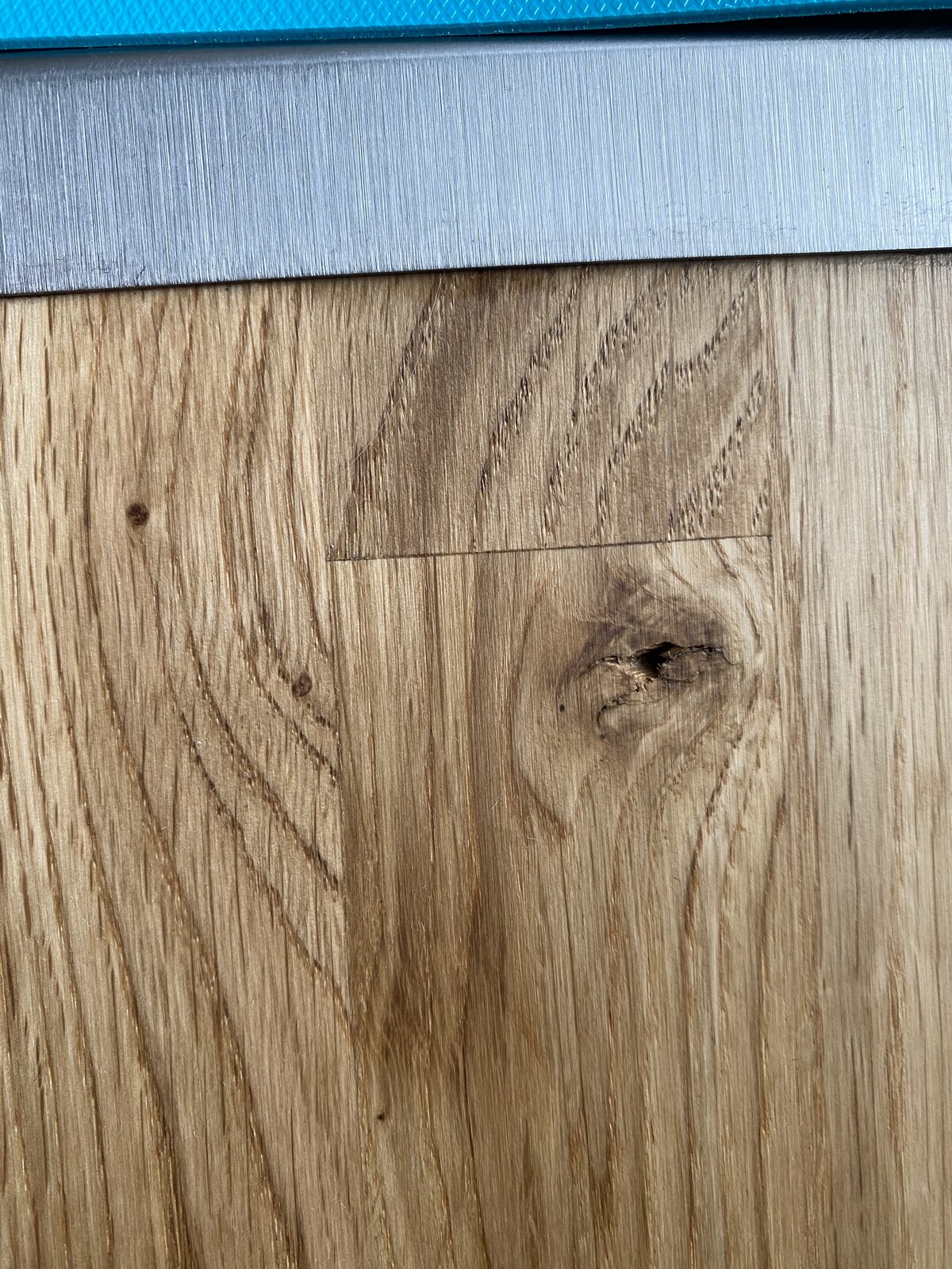

Hi,
Hoping someone can help with this.
I’ve just had a wooden worktop fitted by B&Q and after it has been oiled, I’ve notice a knot (hole) in the surface.
The fitter has said it’s really common and just to leave it. Does it need filled? Should it be there in the first place?

You would expect knots in wooden worktop to be filled with a moisture resistant filler like a two part epoxy. Otherwise moisture will settle on the depression and cause problems down the line.

It should really have been picked up in manufacturing, but it wasn't, however the fitter should also have inspected the materials when he arrived and either opted to install the worktop knot side down (if the knot doesn't go the whole way through - it's at thevend of a stave so that might be the case), rejected the worktop, or discussed the matter with you to see if an equitable solution could be found.
Now the worltop is fixed in place I can see three possible solutions (there are more, but I don't think they are appropriate for a new fit) - replace the worktop, drill out the knot and fill with a tight fitting oak pellet planed and sanded flush or fill the knot with a coloured epoxy resin. Both the latter two options would require the repair to be sanded flush, the worktop sanded overall and refinished (I wouldn't accept a small area repair on a new worktop). Both equally have the (small) risk of the repair subsequently failing and in both cases the repair will always be obvious.

No it cannot be left untreated, because it will cause problems/rot.
One potential 'serious' problem could be hygiene. Little bits of food get trapped in there and start to rot/develop bacteria. Cleaning with bleach each day to prevent this is not the answer, (sometimes referred to as the 'bucket under the drip' scenario in business efficiency). It has to be replaced/repaired or a full refund given with an added sum for the inconvenience. It doesn't matter how often B&Q have to come out. That is there problem, not yours. It may teach them to use 'fully qualified/experienced fitters' instead of Joe Bloggs from Check a trade who has 500 good reviews from his mates.

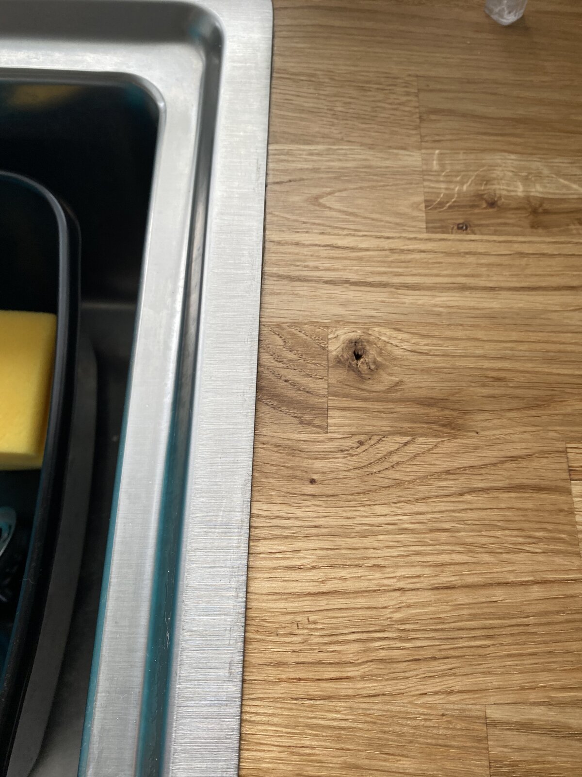

B&Q have come back to me to say that they won’t rectify the knot, and we should treat it ourself. They have stated they won’t touch it. The worktop was only fitted a week ago.
Any suggestions on what to do?

B&Q are refusing to repair or replace the worktop. It was fitted a week ago. They’re saying it’s natural and we should treat it ourselves. Any suggestions on what to do?
