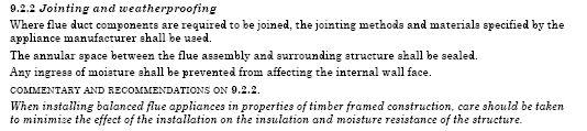

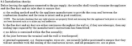

Whether to hard seal the flue to the wall is open to interpretation. The manufacturer will cite BS5440-1:2000 in their literature but the standard is not sufficiently specific however, it would be best practice to seal both inner and outer wall faces in addition to fitment of the supplied weathering collars.
Provided I can't see daylight around the flue (from the inside), the hole is not too ragged, and there is little chance of re-entry of combustion products I will just mark un-sealed flues as NCS.
From BS5440:
