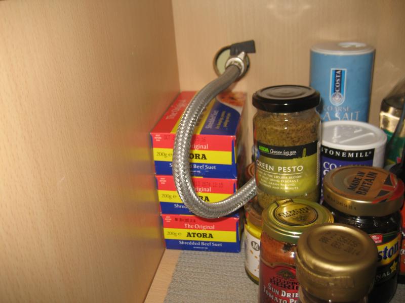

Hello group recently moved into a new property and noticed the combi boiler pressure is at zero, does anyone know how I can re-pressurize the system. And what is the consequence’s of running at low pressure, any advice really appreciated.
Photo’s below
Regards Otto
why will the op need a key???
doesnt look like the installer fitted the part....
look for a silver braided hose that will top up the boiler
Hi! @ottosump - i'm having the same issue as you, no filling key and can't see where it would go even if I did.. so hoping i can locate the silver braided hose - any thoughts on where this might be, and once i've found it, please could you advise what you did! Thanks so much!
if you have the same boiler you wont have a key try below the sink
