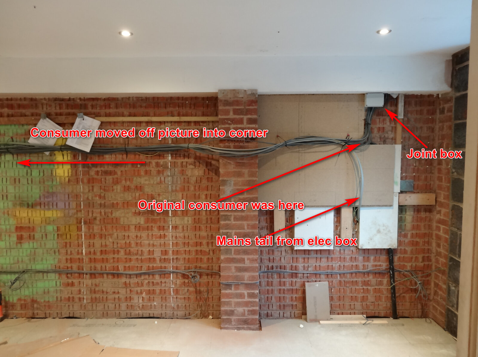

But when I dug out some pictures I took in 2014 of the work on our conversion, he raised some concerns about the work done to move our consumer.
Consumer in the garage was moved by a NICEIC registered installer, into the corner of the room.
His concerns were:
1) Mains tail is over 3m long with no mitigation (e.g. armoured cable, etc).
It's about 4 to 4.5m long I'd measure it out as.
2) Cables run along the wall, not in any 'zone'.
(they ARE parallel to the new consumer, but I have no idea if the consumer itself creates any "zones". I've only seen examples of sockets).
3) The box used to joint the cables to extend to the new consumer is also out of a 'zone' as it's below 150mm of the "new ceiling" (due to it being studded and boarded so the wall is flat to the ceiling in the image). Although he thought maybe the electric meter would create a qualifying 'zone' above it - as the box sits above the meter box.

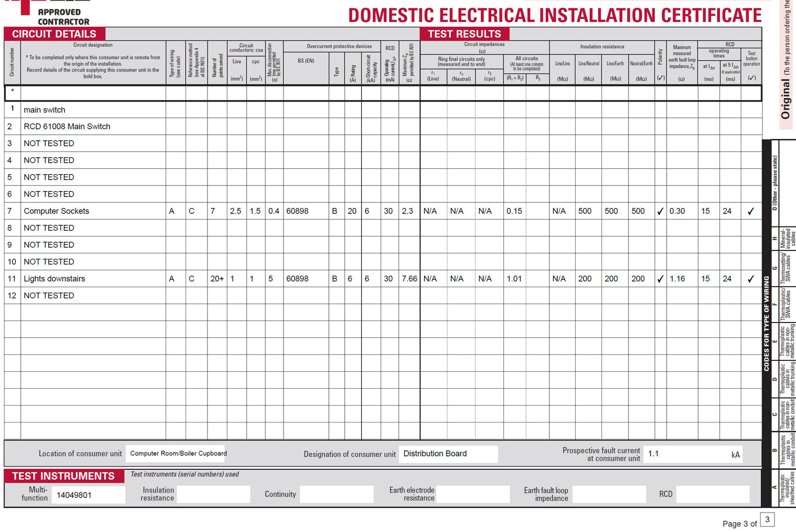

I dug out the NICEIC cert the contractor sent us, and I've noticed there's nothing on there that specifically lists moving the consumer and testing. Only adding the sockets and lights. I have no idea if you'd test a consumer after moving though. I'm no electrician!

I'd expect more Test results on that Certificate and more details about what has been connected in terms of Circuit type & conductor sizes. There's no reason to just leave them blank just because they didn't test them - effectively everything that's been reconnected is a new circuit. for peace of mind if that was me doing the board move i'd like at least a ZS (Earth Fault Loop Impedance) measurement of everything I reconnected. What was the main need to move the consumer unit?

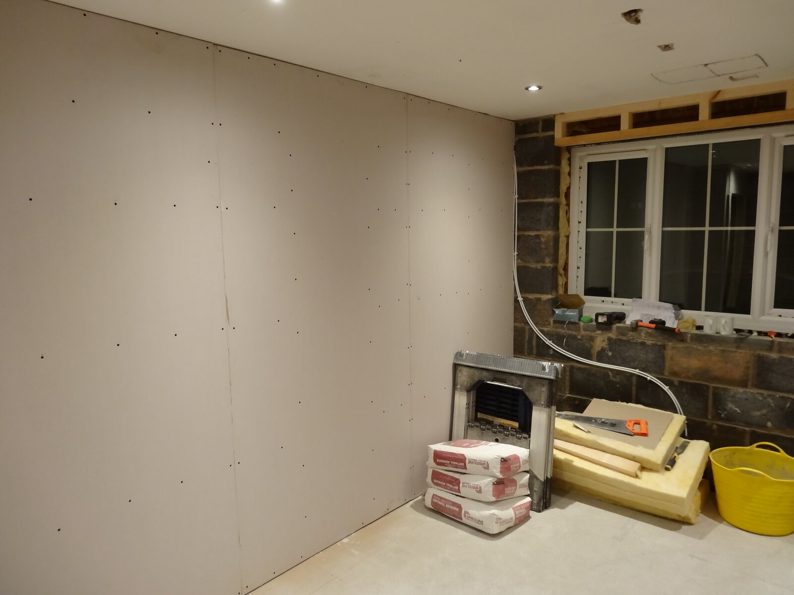

The cables look to be behind a stud wall, far deeper than 2 inches, except perhaps around the pillar? Cables deeper than 2 inches do not need to be in prescribed zones.
True, nice height for a picture hook. Whether someone drilling a hole to put anything up would be hitting the cables would be debatable, they all look quite twisted in those before shots. I'd prefer mechanical protection for that amount of cabling just to be on the safe side - especially for the Tails.
The length of tails - usually over 3 metres should warrant a switch fuse unit at the meter position. I think under some circumstances 5 metres can be allowed - but I cannot for the life of me remember why that MAY be the case.
If the tails and cables are horizontally in line with the consumer unit, then no major issue.
Cables ok 2 or more inches behind plasterboard.
Not ideal where the tails go over the pillar, meaning tails are immediately behind plasterboard, but probably acceptable. Lets hope some earthed mechanical protection was fitted here. Of course it wasn't.
Junction box likely to be more than 2 inches from plasterboard finish, so no major problem.
Probably screw connections used, but there you go.
No major concerns here for me, could have been worse, I think new electrician may be a bit critical, nothing wrong with that, but no need to cause a load of fuss in my humble opinion.

I looked over all the photos of the build and did some comparative measuring - I'm pretty sure the plasterboard is only just in front of the pillar/pier - so the cables will be direct under the board (not 2 inches). But as for the rest of the run, they'll be a good 4-6+ inches away from the board.
(Annoyingly, I don't have a photo of the stud before the plasterboard goes on!)

But the problem is to prove that the electrician doing the work was aware of what would be covered up. I was unfortunate enough to hit a horizontal cable in my old house, as shown in your picture there was a pillar, which actually came into the room more than yours, so the cable went around 4 corners, I had expected the cable to have been routed through the ceiling.
So technically I would say image 1.jpg is not permitted as the pillar means it goes around 4 corners if covered by plaster board, but as shown nothing wrong as visible, I have never really considered who needs to add protection when a bare wall is covered.
The zones
show the socket zone does not follow around the bit jutting into the room, so all cables should have been within 150 mm from ceiling or the plaster board would need to be set so there is no column, but the major two questions are how to correct, and who pays?

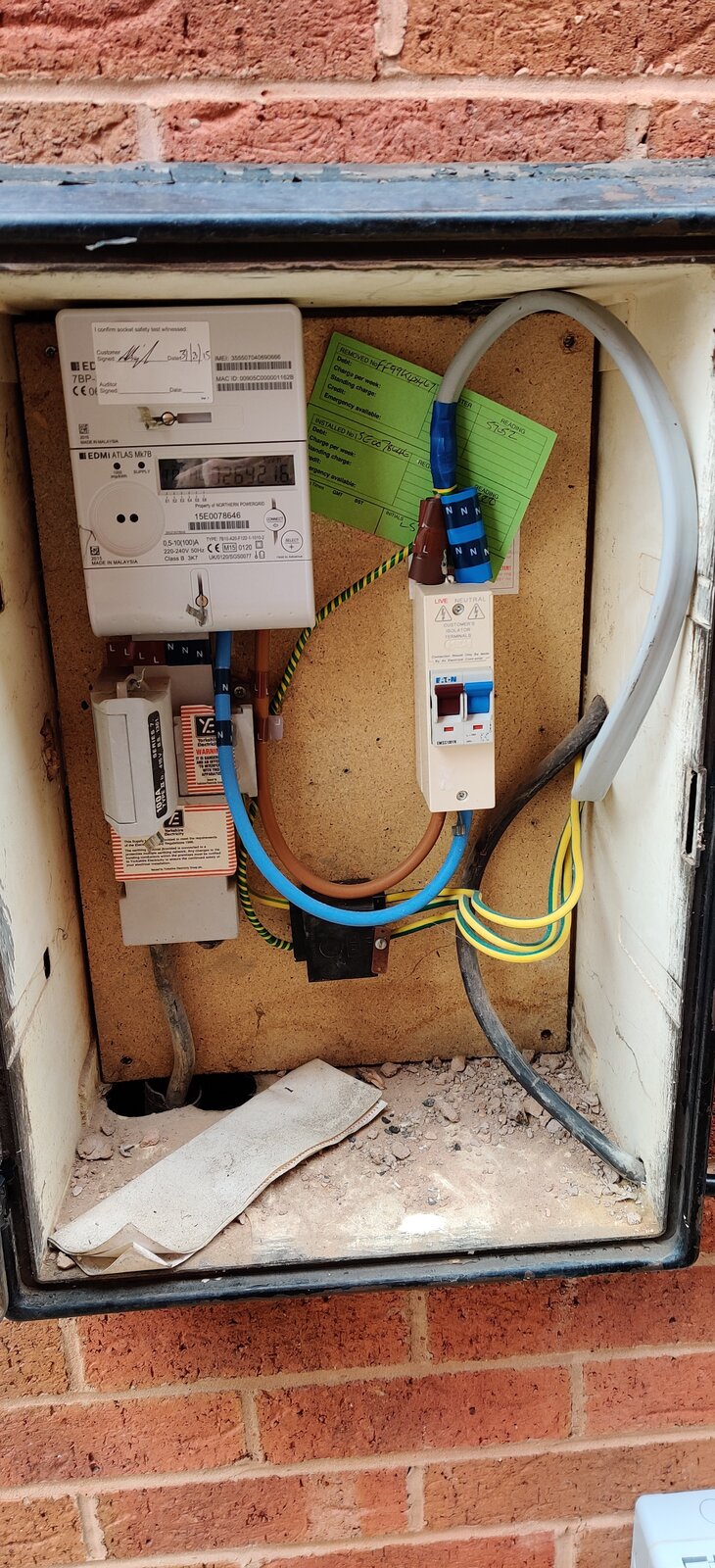

Send a pic of inside meter cupboard.
Attached!
For reference, the black cable is an SWA for outdoor sockets that the house already had (the sockets I had replaced).
The cable just makes use of the hole to enter the property. But if I'd not have done it that way...

well that meter cupboard pic isn't good.
T&E used 10mm? without a switch fuse, connected to what could have a 100A fuse fitted.
Poorly terminated.
Poorly terminated.

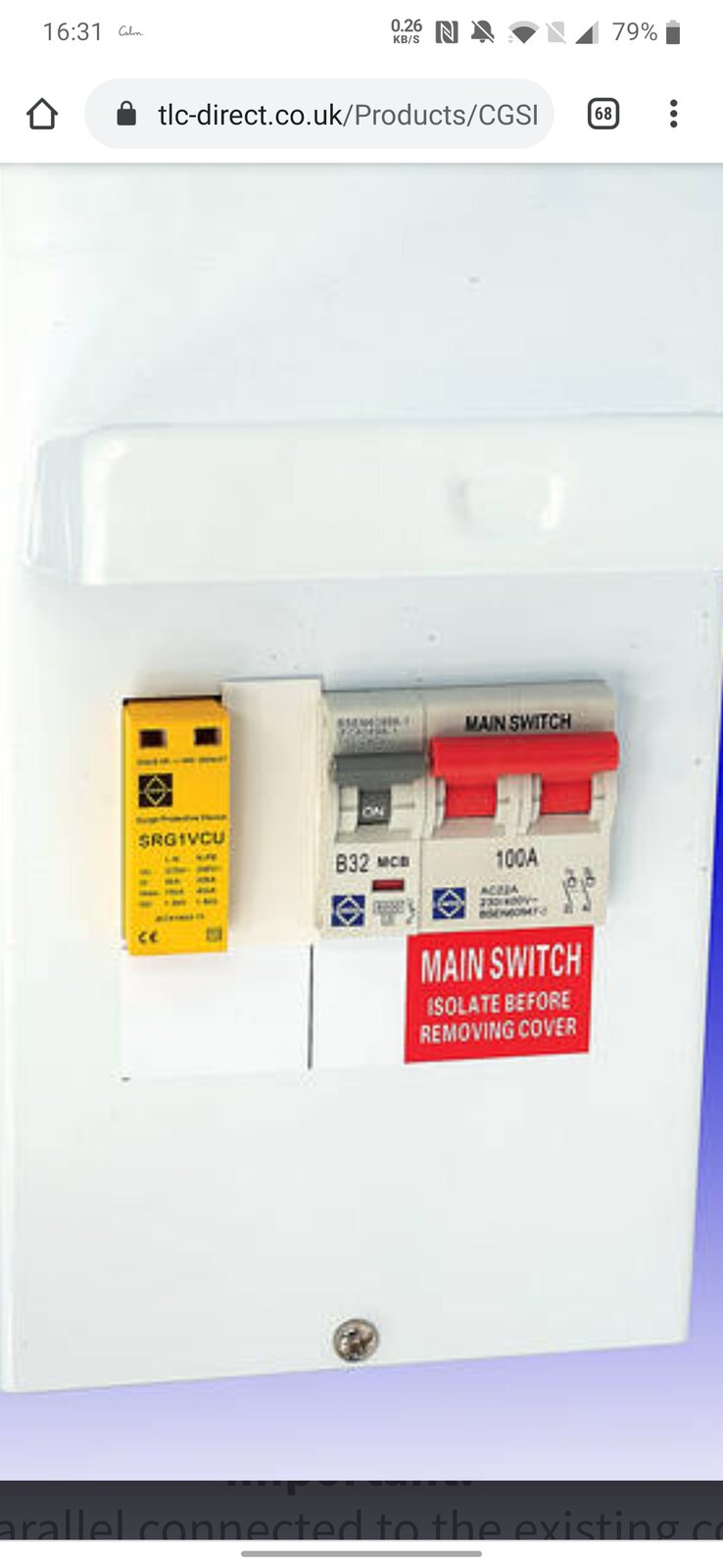

Sorry, I'm not clear on this - do you mean that it's badly terminated because due to the position and length of the mains tail, there should be a switch fuse here so there's a mechanical form of protection?
(Something like the attached, which I just found online as an example, so the MCB is switched)
Or is it a general comment on the cupboard, unrelated... And another problem...?
