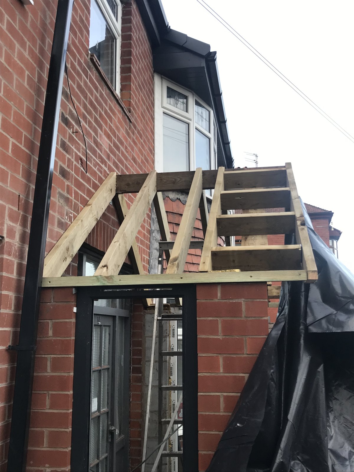

Working out a overhand on porch roof so wverything fits right?
I’ve not done much today due to rain and hail but here’s my revised ladder:
Almost dead center on the upvc frame.
I want to work out my tile headlamps now. I was thinking to fix the highest battens on, then the lowest then calculate the rest from there?

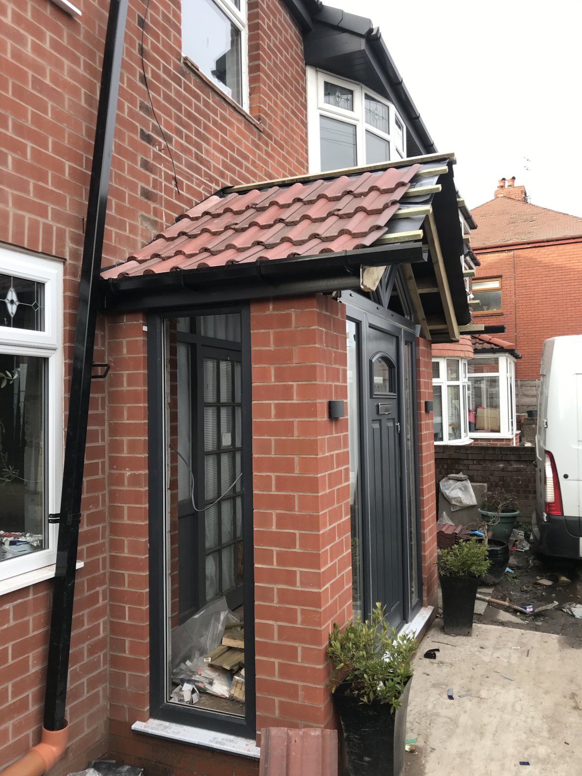

looks good, fascia looks a bit more possible now too from your latest pic.

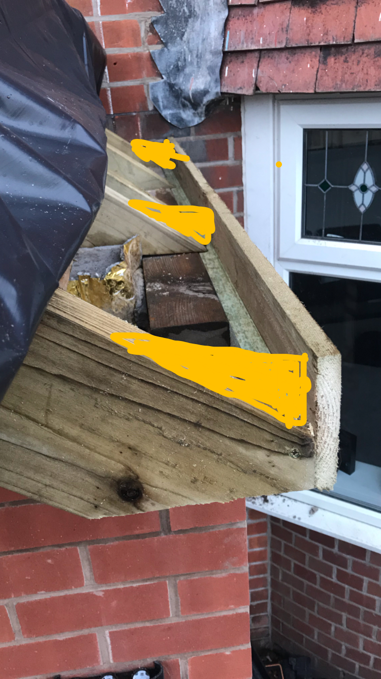

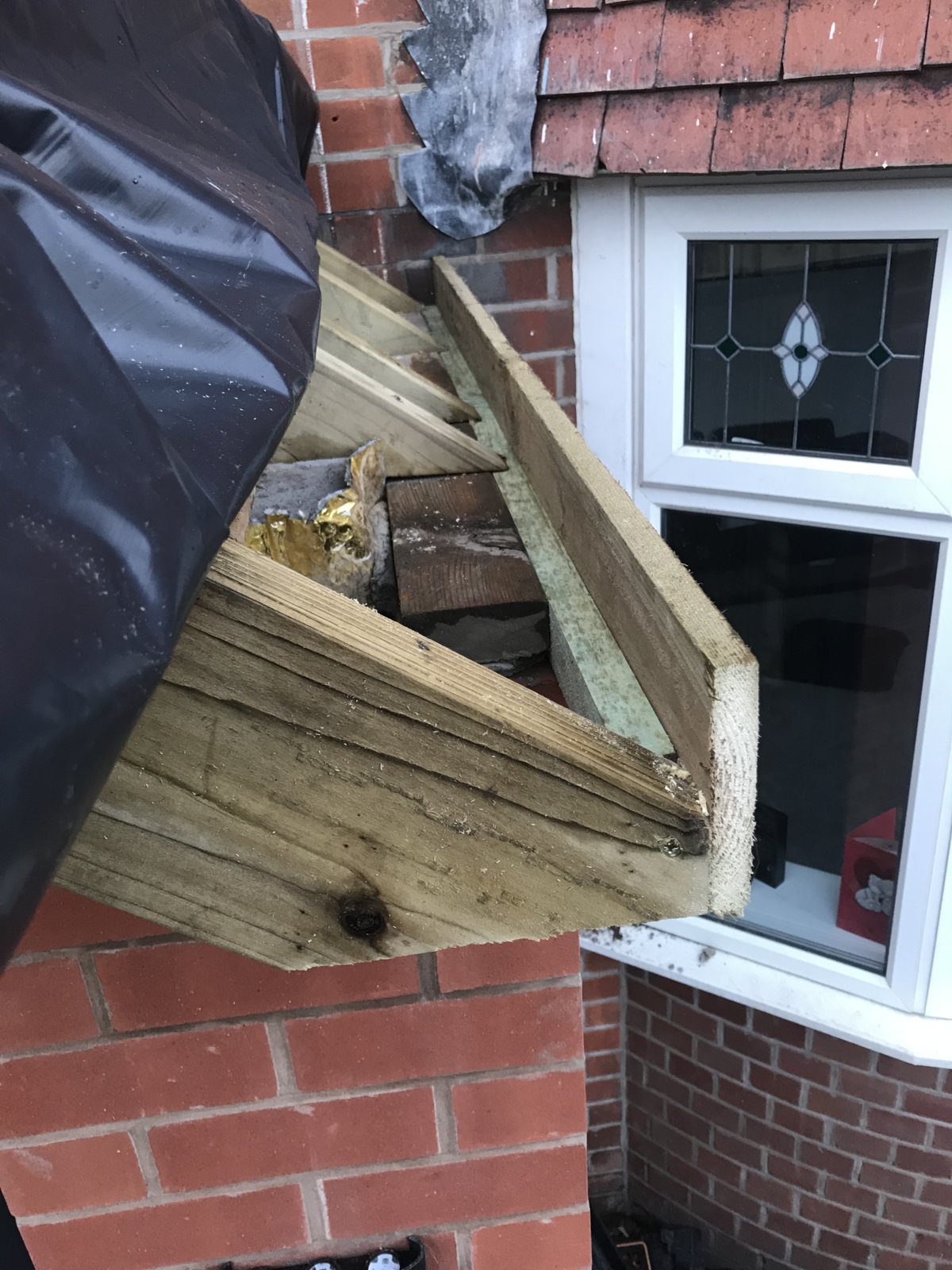

Going to crack on tomorow. I was just offering up a fascia then realised I have no soffits, it’s only an inch gap but it needs it.
And do I need to fill this gap or will the eaves sheet be enough?
Between the underside of the fascia and the wall? Thin fascia offcuts maybe? Fixed to batten off wall plate? Guess the eaves tray will cover it but that’s on the top side of the fascia... May have misunderstood the Q
Between the fascia and the rafter:
The rafter off cuts could fit in there if I needed anything
Don’t believe so, but check the spec of the tray incase it mentions support/rafter spacing? On mine it was fine. Guess it wouldn’t do any harm though to provide a bit of extra support if it’s easy to do

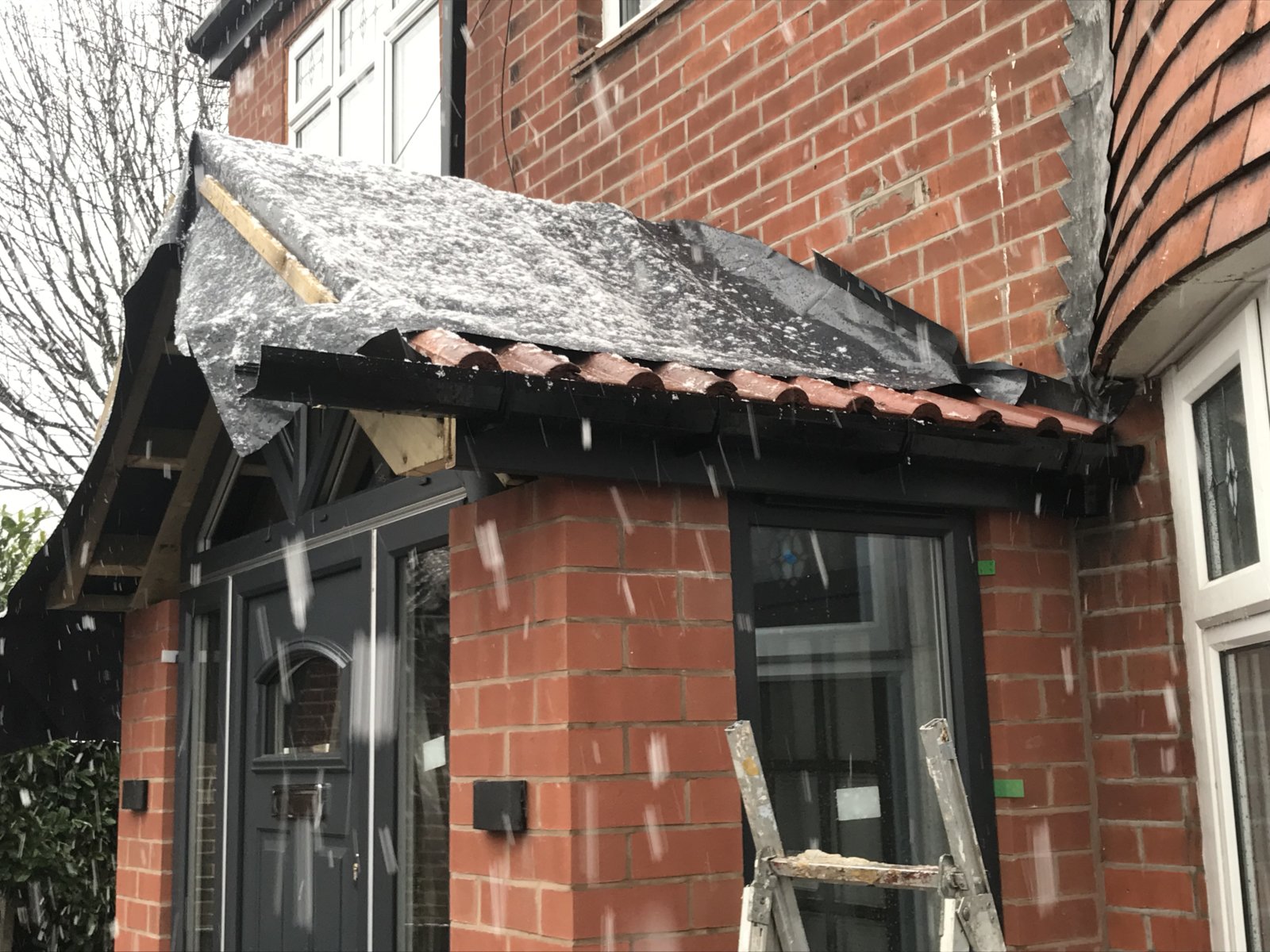

I’ve been snowed off!!!!
But the fascia looks ok and the soffit finishes just above the trickle vent
